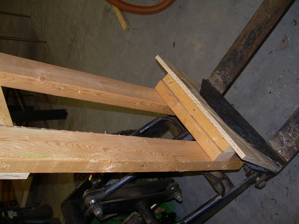

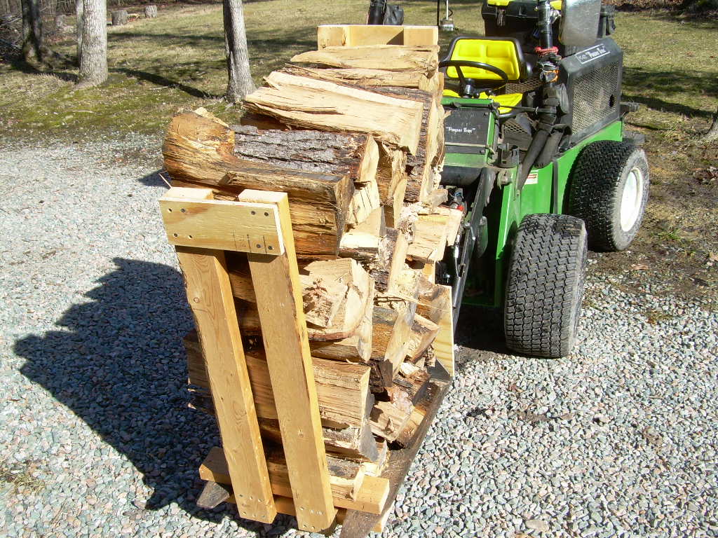

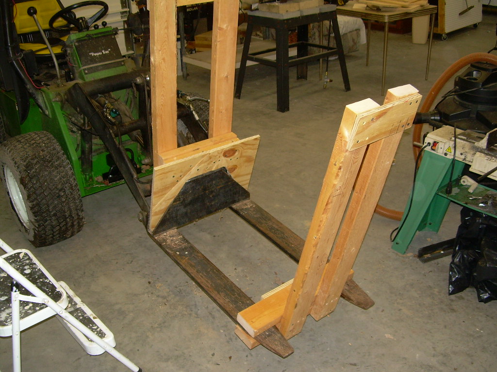

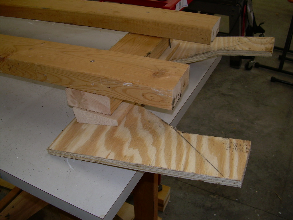

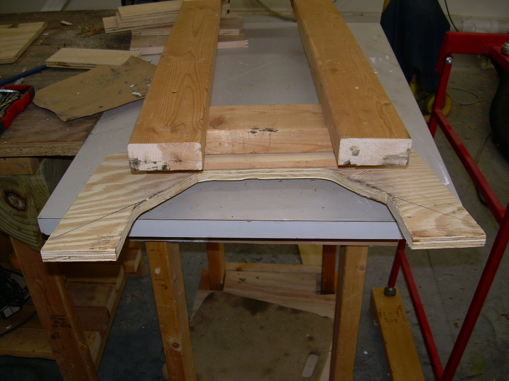

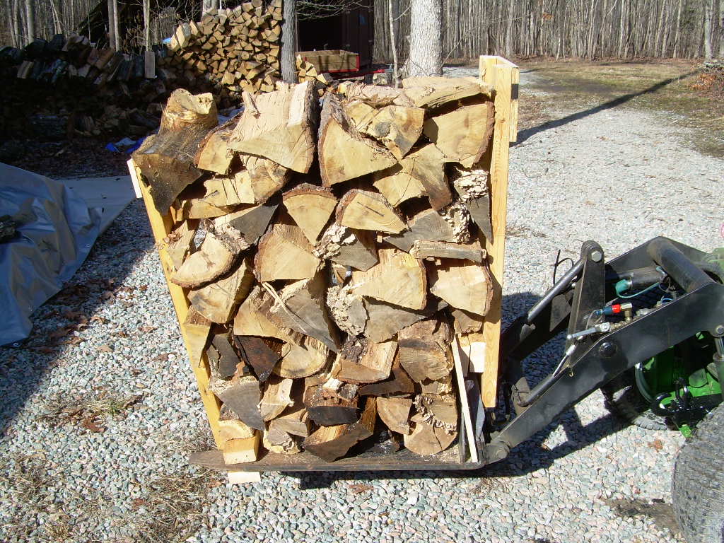

I was moving some wood with my forks on my 422 today and realized how little wood it holds. The wood will fall off either end if you stack it too high. I decided to make some wooden extenders. They seem to work well, but I find I cannot take the forks off of the PT with the back extender on. I will have to work on that. Perhaps if I cut the 2 X4 a little shorter at their bottom end it will come off.
