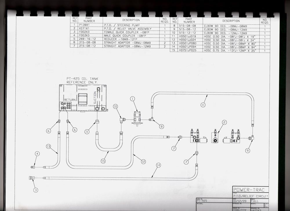

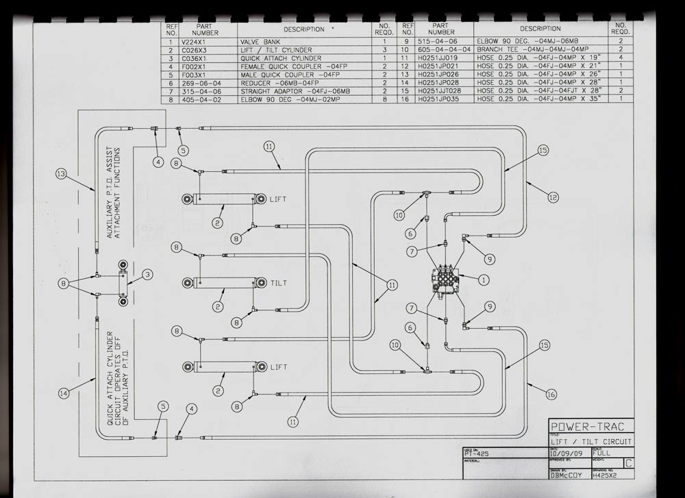

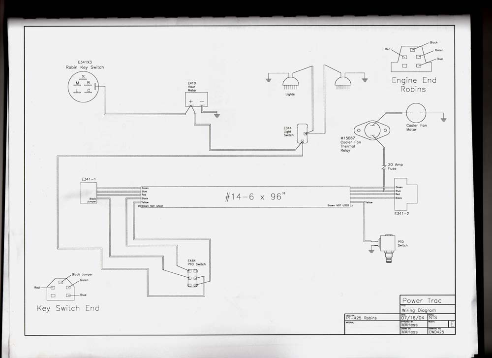

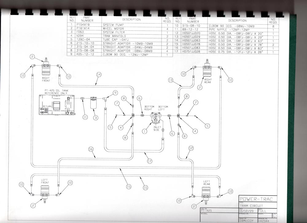

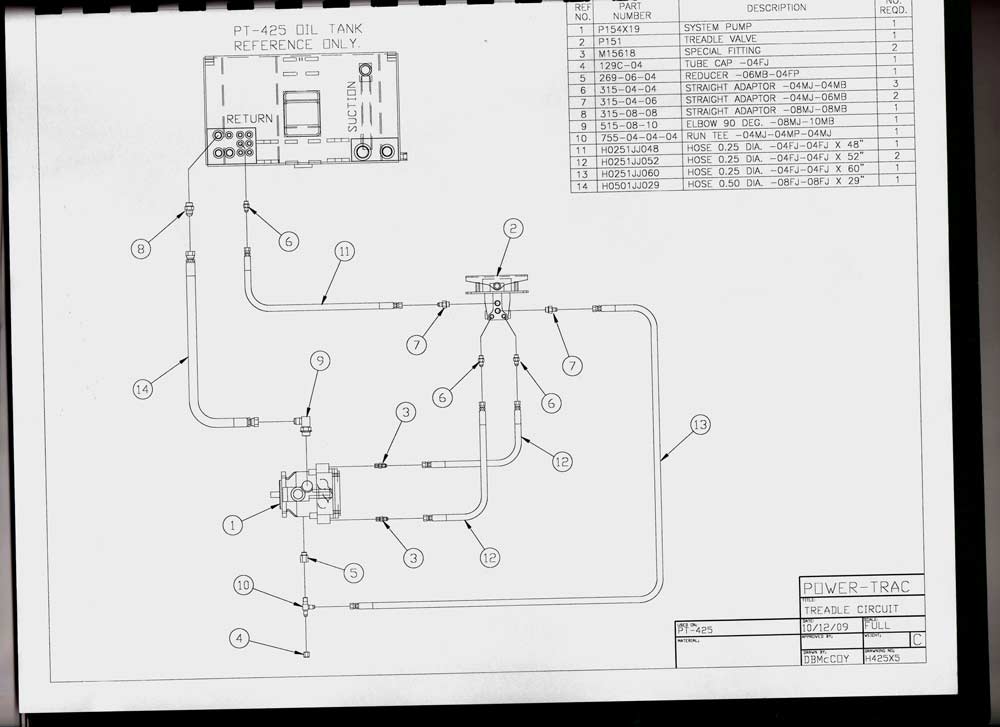

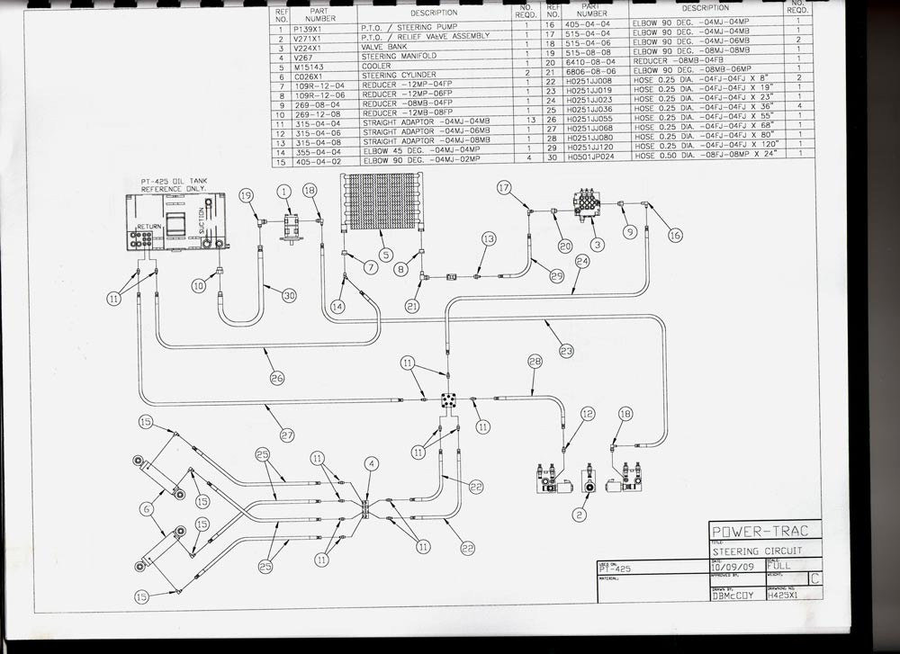

In the parts manual for my recent PT 425, the cooler is on the Steering Circuit, and not on the Tram (wheel motor) circuit. I scanned all the circuit diagrams, see photos. Note, the date indicates 2009, so they also may be out of date.

The wheel motor circuit in my PT is a closed loop system. This means that a lot of the same oil is recirculated over and over, with the charge pump making up for any loses through the VSP, or wheel motors. The charge pump, pumps about 10 % of the total VSP volume. My wheel motors have case drains which collect at a manifold which includes a hose from the VSP pump casing. This fluid is then sent to the radiator, and then to tank. The charge pump fluid is drawn from the tank through a 10 micron suction filter, and maintains the volume of fluid for the closed loop circuit, and helps cool the VSP pump.
A lot of people whine about a suction filter, but Power-Trac must have got it right, because all the PT's have this setup, and has been in operation from the late 80's.
Very interesting. That is completely different from my schematic. I went outside last night and verified that my cooler inlet comes from a large hose on the bottom of my VVP and the outlet of the cooler goes back to the tank.
I wonder why they changed it?

I'll bet they changed it when they switched from the hydroback cable to a hydraulic circuit to control direction. That probably used a different variable volume pump. Or, perhaps, the steering circuit has a more continuous flow of fluid from the tank? Just wondering. Or wandering. :laughing:
