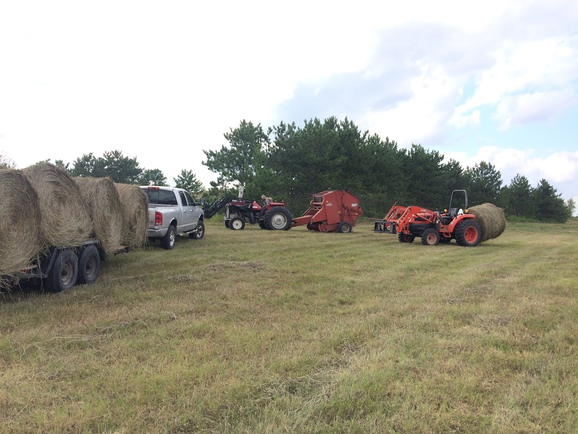

We're doing about the same stuff, goats, snow removal, clearing old fields. We end up buying some 4x5 round hay bales(storable outside and cheapest/lb) and a 3500-4000lb+ tractor with some weight on the back handles those easily. My tractor can unload the top row on a double stacked hay wagon, which is how a local farmer will deliver round bales.
In short I think ~4000lb HST tractor does almost every chore you'll need, and not be too big to maneuver around. Plus you can run most older small farm attachments like a spreader, tow a small hay wagon, also yank a car out of a snow bank. If you run a rear blade for snow clearing, a cab isn't as necessary IMO, warm clothes are pretty cheap anyways. Mine has also moved a few 100's of yards of dirt with a box blade too, to create level spots, trails, ditches, bikes jumps, etc..
Go see all your local dealers, big, and small. Around me you would likely be buying a Kioti NS, as he's still the best dealer for a new hobby farmer by a mile IMO, but you'll have to find one you like near you. I found all the big farm Ag dealers weren't really interested in selling a 40hp tractor, and just quoted msrp, plus plus plus. I looked at a few private sale used tractors, but its hard to know how "used up" it is until you have some experience.
I like Ag tires, for the grip in mud and on grassy wet slopes, and get them set wide, and the rears loaded with beat juice or something other than calcium chloride.
Here I'm helping my buddy load his trailer up as he bales, no problem lifting to the second row, with a bale on the back its pretty stable. I think its a pretty useful size.
