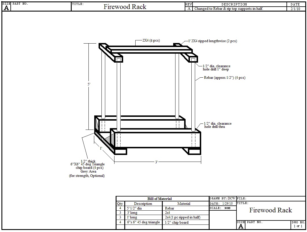

After seeing what Bob did, it gave me an idea for the stand alone wood rack pictured below. I have included the drawing as well. I felt I handled the firewood too many times. Now I can load the rack were the wood is stacked outside and move it directly into the garage with the forks, eliminating an extra handling. I paid for all the materials on this 1st rack - $15, but have enough 2x4s round to make 3 more racks and only have to spend another $15 on rebar. Thanks for the inspiration Bob!
The rack and the cab are both very nice! :)

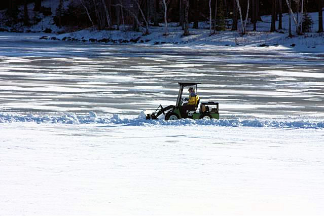

Thanks for all the compliments, but all the inspiration came from you guys. The cab is still a work in progress, using what I learned here and from previously owning a CAT skidsteer. I use the snowblower attachment quite a bit, so a cab and a windshield was a necessity. Believe it or not, the top windows on the doors and the back window are the heat shrink plastic storm window material - cheap and easy. Actually works so well I'm going to leave it on. By the way, the entire cab can be removed with 6 screws. Doors lift off their hinges, requiring no hardware removal, windshield is just taped on with 4 pieces of clear packing tape, although I did try using magnetic tap to hold it to the ROPES but it was not strong enough to hold, hence the cracked windshield.
The heat system is still work in progress also, just made this last weekend. The duct work is actually cardboard taped to a plastic container, held on with bungy cords. The cardboard on the sides was added yesterday, but still too much cold air gets in. Am considering removing the heat shield and replacing with one without the bent over top so the heat from exhaust could go directly up. I also added a toggle switch which bypasses the temp switch for the fan, so I can control when it comes on. In the winter, the fan never comes on by itself.
I will say the articulating tractor has made designing a cab a real challenge, as is the heating system. There is plenty of heat generated by the engine, it has been tough trying to figure out how to get it into the cab. I'm open to any suggestions.

Why not use flexible duct. Perhaps an in-line duct fan, if they make one using 12 v.

Ken - it beats the snow blowing in your face at 10 degrees! I will agree you can't see as well, but many time I'm out for 2 hours at a time, so comfort is big for me. Did I mention I was lazy too?
I have include a picture below. One of my excuses for getting the tractor was that I told my wife I would keep a skating trail open on the lake, so I have tried to live up to that this year. Boy, did I underestimate how difficult and time consuming it is. That really was my motivation for the heat. This picture was taken before I added the back, I thought 3 sides would be enough, but not with the wind blowing down the Lake!
J.J. - I had thought of that but decided why not try and use the fan that is already there and not used in the winter. Did I mention I'm cheap also? I had thought about going straight up off the fan with ridged flue pipe, then into the cab over my head with flexible hose, still a possibility. The current rig actually delivers enough air to the cab, it just isn't hot enough, I need the air that come from near the exhaust pipe, that air is hot. The other thing I like about this design is that it doesn't stick out anywhere on the side, so there is nothing to catch.
That is a great shot! :D
As for heat from the engine compartment, I agree with J_J. Make some sort of cover for the existing fan, 90 degree it forward and reduce it to a 6" round duct. Reduce it again to two 3" flexible ducts and port them where you want them. Perhaps one under the seat and one towards the top of the cab?
Have you thought about a hydraulic cooler mounted to the underside of the canopy?

Just an update on the Firewood Rack. Drawing attached reflects the way I made it. One good thing is that it easily comes apart into the top piece, bottom piece and 4 lengths of rebar for easy summer storage. I ripped the top 1' length of 2x4 so all the wood comes out of 1 12' 2x4. 5' was higher than I wanted, but rebar comes in 10' lengths. It is a little tipsy when transporting (I just tie it off) but is very sturdy when on the ground.
