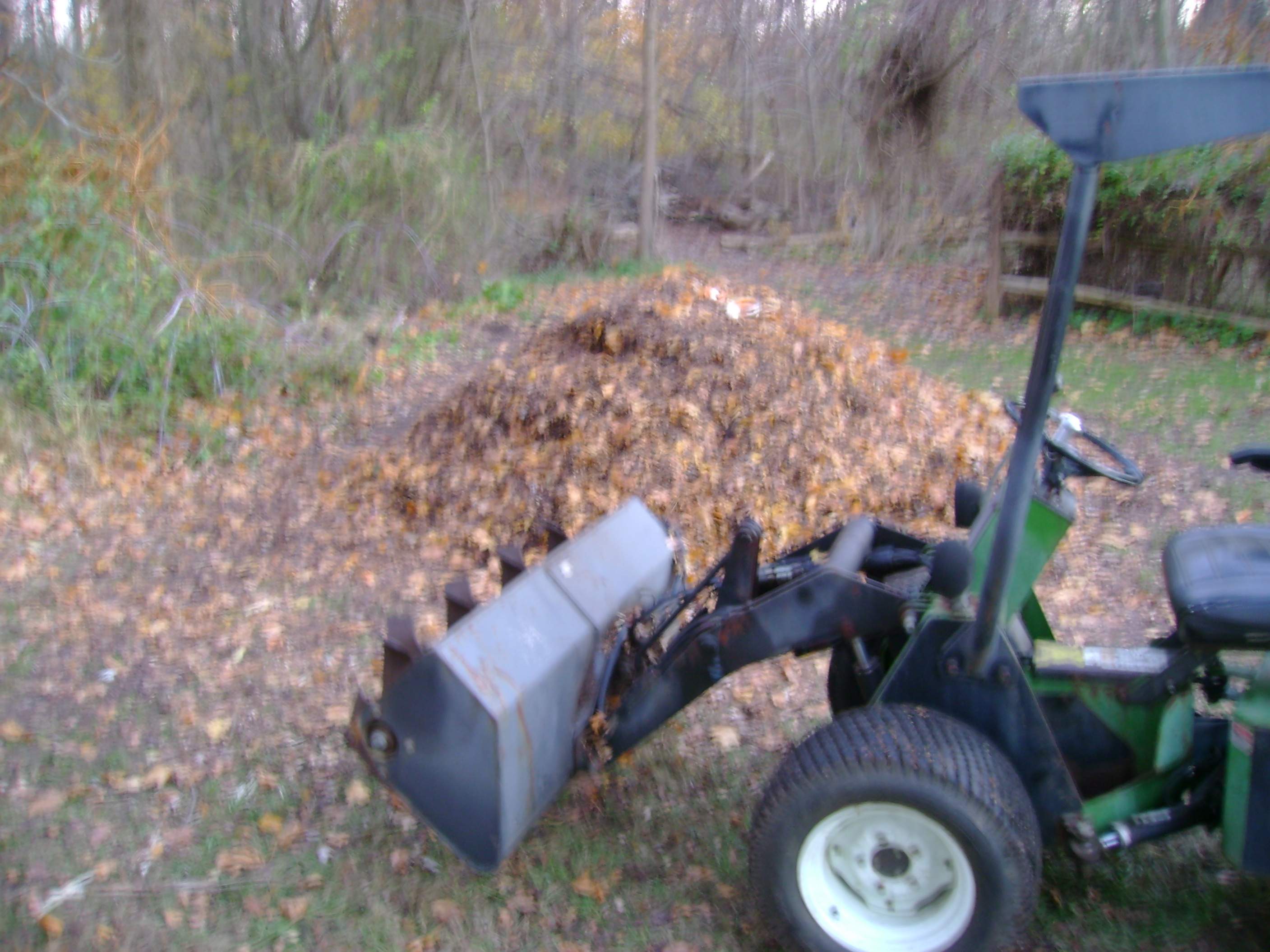

Ok cab has got me interested. DC how di you fit the windshield? Is your PT different than mine. I dug up an old blurry pic that shows my consern. On my PT I couldn't mount it the way you did, I don't think because it would not clear the steering wheel or the box the wheel is mounted to. Did you mount your Rops forward of stock position?

Ok cab has got me interested. DC how di you fit the windshield? Is your PT different than mine. I dug up an old blurry pic that shows my consern. On my PT I couldn't mount it the way you did, I don't think because it would not clear the wheel or the box the wheel is mounted to. Did you mount your Rops forward of stock position?
And don't forget about clearing the lift arms at full height and the joystick hitting the inside of the windshield when you push forward.
Hi Scott - that is exactly what I did, I moved the ROPS as far forward as I could and remounted it. The real dilemma I faced was to build the cab with or without the ROPS. I would have been much easier without it, but for safety I felt I needed to keep it. Since I have had a few questions about the cab, I will get some picture together and describe what I did on a new thread. It may take a few days as it's been real cold lately and I have been hesitant to spend much of time outside.
