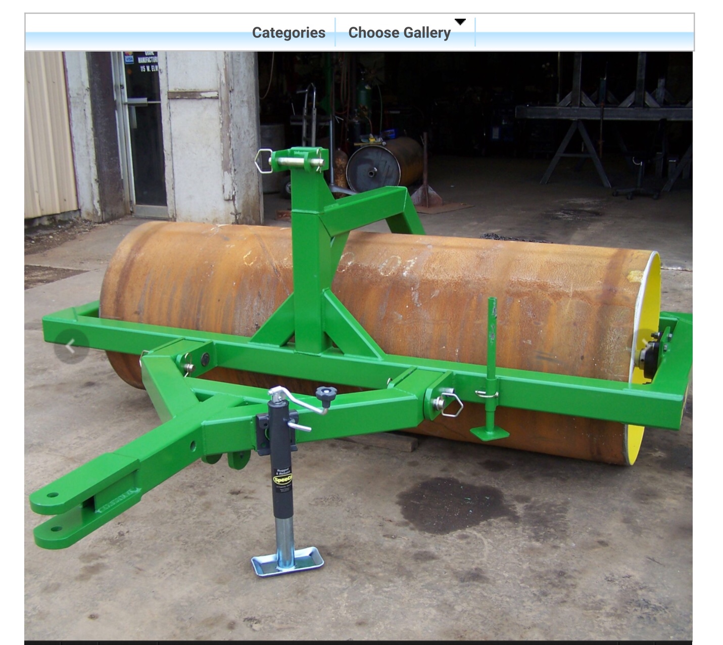

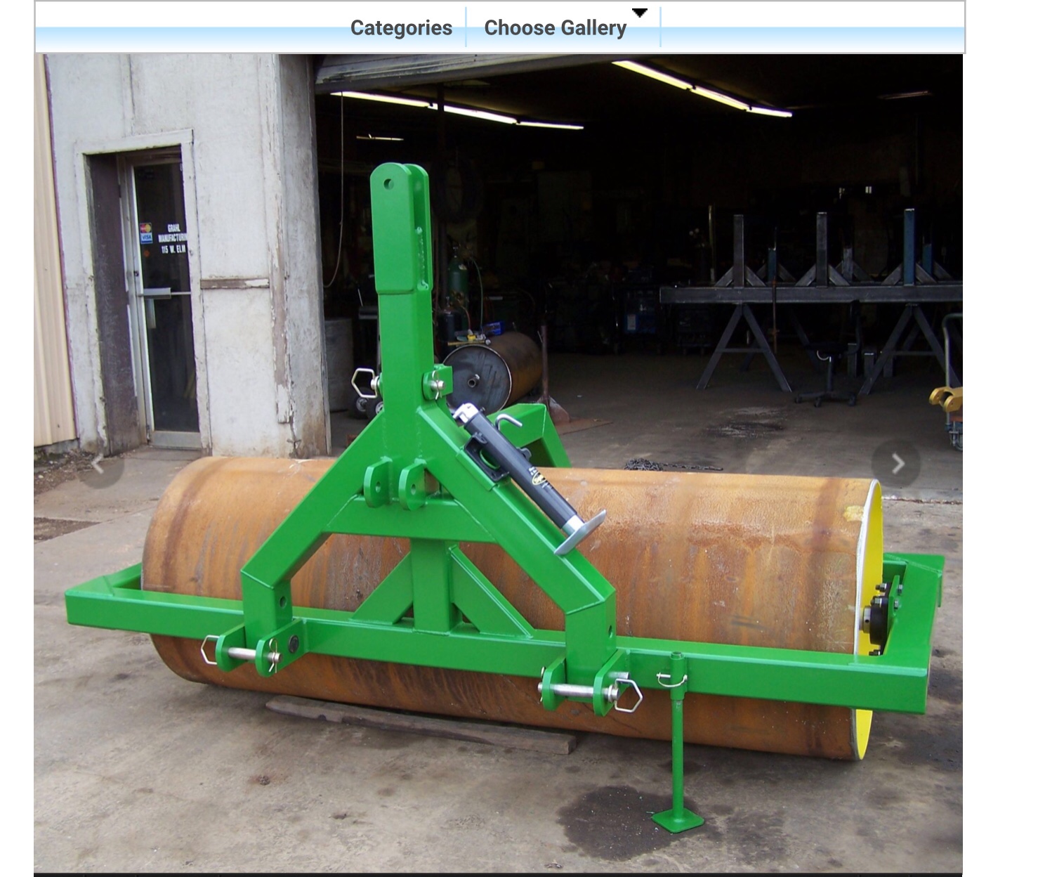

I took a 3pt box blade and added wheels and a tongue that pinned in place using the 3pt mounts, worked out real nice.
/ Finally built a laser grading rig using my box blade. #29
I ran across this design also, if I was going to use it both ways much I’d do it this way, simply raise it and you have your 3 pt. IMG_0122.JPGIMG_0123.JPG
/ Finally built a laser grading rig using my box blade. #30
Very impressive Steve. Thank you for all the detailed answers to all the questions. You have made quite a commitment but if you are expecting +/- 1/2" that would seem to make it all worthwhile with the irrigation requirements you are dealing with. Thanks for sharing.
gg
#31
I ran across this design also, if I was going to use it both ways much I’d do it this way, simply raise it and you have your 3 pt. View attachment 545683View attachment 545684
I am doing mine very similar to your pictures. I will have a 2 5/16 coupler which will be used for highway use too. Tilting with a ball hitch is less strain on the pins and having a ball on my tractor drawbar is okay as I never use it.
I will have the swivel tongue jack and hydraulic cylinder for pitch front to rear. Plan on using the top link cylinder here.
Thanks for the pictures.
/ Finally built a laser grading rig using my box blade. #32
Yes, I used a top link to support my tongue , so i could adjust the angle, but I would use a hydraulic cylinder for doing what you are. The ball hitch should work out good, I use different stuff on my draw bar so I just built a swivel clevis. You’ve done a very nice job on your build.IMG_0124.JPGIMG_0125.JPG
This is an excellent idea, and would be a great way to make the BB1284 quick hitch compatible, by mounting the 3 point mounts on the tongue in the correct location to line up with the quick hitch. I may use this.
