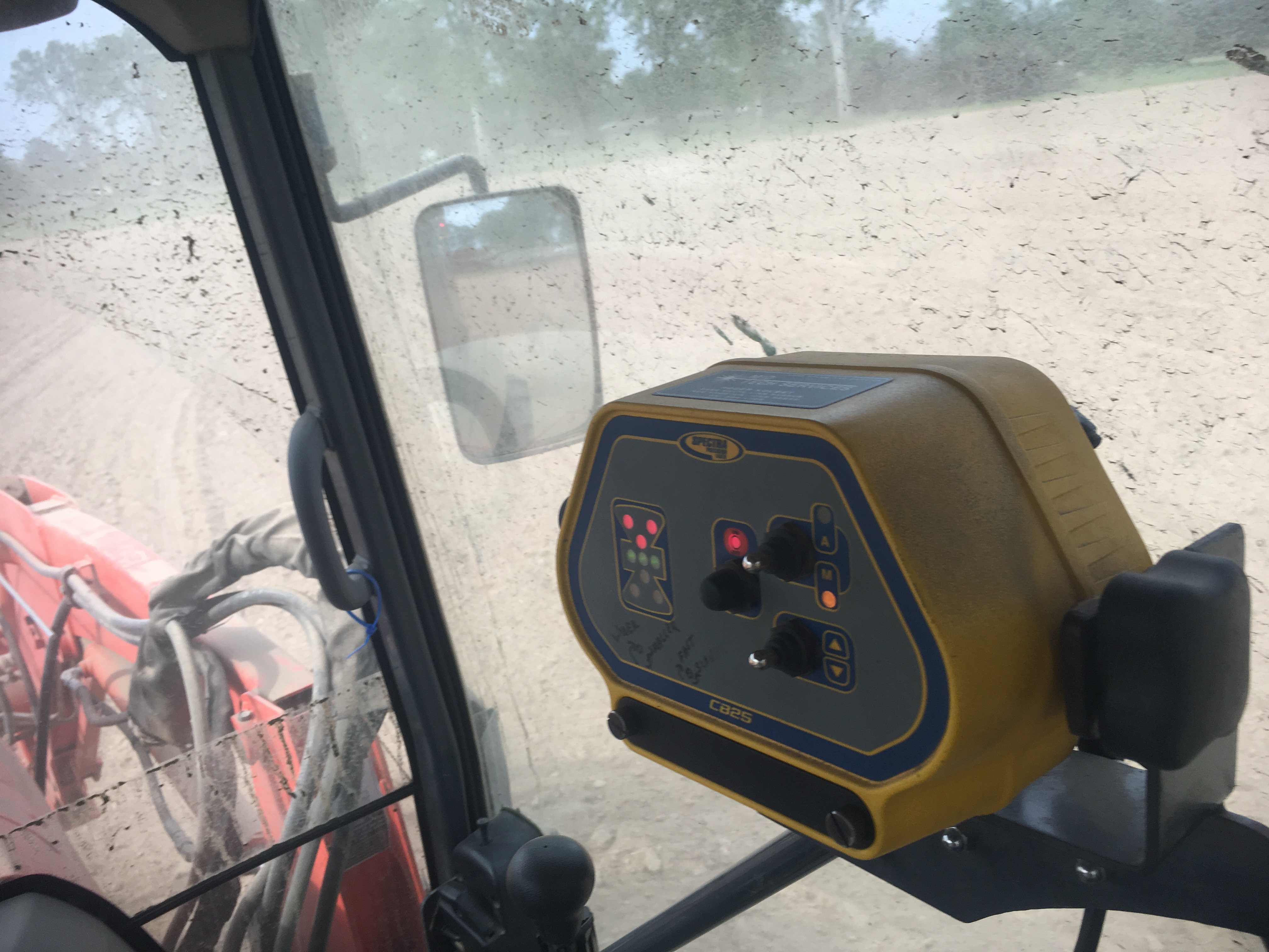

I put several hours on my rig again today. This is a pic of my control box. The switch on the top right switches between manual and auto. The bottom right is for operating the blade while in manual mode. The middle button is the on/off button. Behind the 2 knobs on the bottom are the adjustments.
One adjustment is to adjust the 'dead zone' on the receiver. The other adjustment changes the reaction time of the valve.
I usually start a job with a wider 'dead zone' on the receiver and slower reaction time. As I get closer to a finished grade, I will reduce the 'dead zone' and increase the reaction time.
The Topcon controller has many functions available through the led display. When first turned on you have a choice of different operating modes. Being new to all of this I have started out in standard mode no need for GPS mode and other choices. I have not purchased the TM-1 motorized masts but with these added you would be able to automatically survey a field on 50 ft. spacing and have it calculate the best fit of slope and finished grade.
Lots of built in capabilities that I have not explored or used yet but will look into once I am using it more. One is having three set points, where you can have a choice that is high where you start shaving down the high mounds roughing in and then work to your final set point on grade.

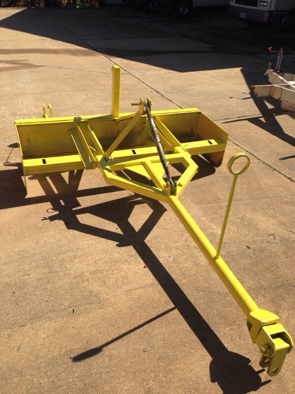

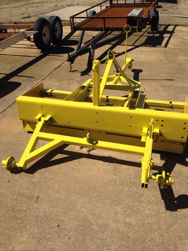

Started on this build last September and had to work on it in my spare time. Still have a few things left to do but was able to try it out today. I basically added caster wheels to the box blade. Usin g Topcon equipment and a Danfoss PVG 32 proportional valve. All joints were made with close tolerance bushing stock and have grease fittings.
I tried it out for about 6 hours today and it seemed to work pretty well.
Here are some pictures.
