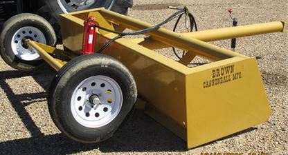

To move, level and smooth dirt, the box scraper will beat a box blade 7 days / week 24hrs. / day. It's a shame not too many are available for smaller tractors.
Amen. I've looked for one of those for a long time in a size that would work for my 50hp tractor. But all the ones I see are 10' or 12'. I saw an 8' one recently that would work, but apparently it was made of solid gold . . . or at least the seller thought it was.

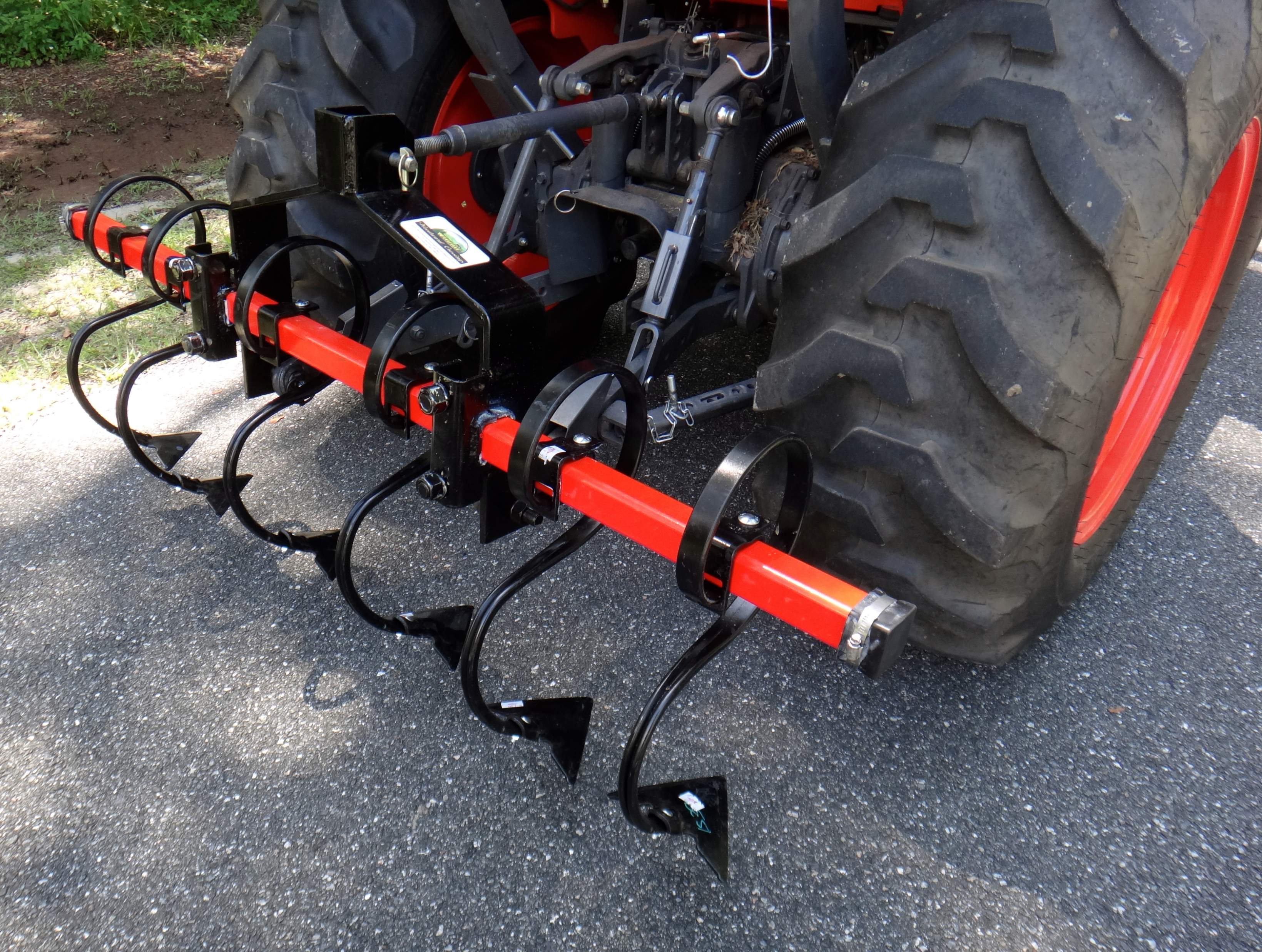

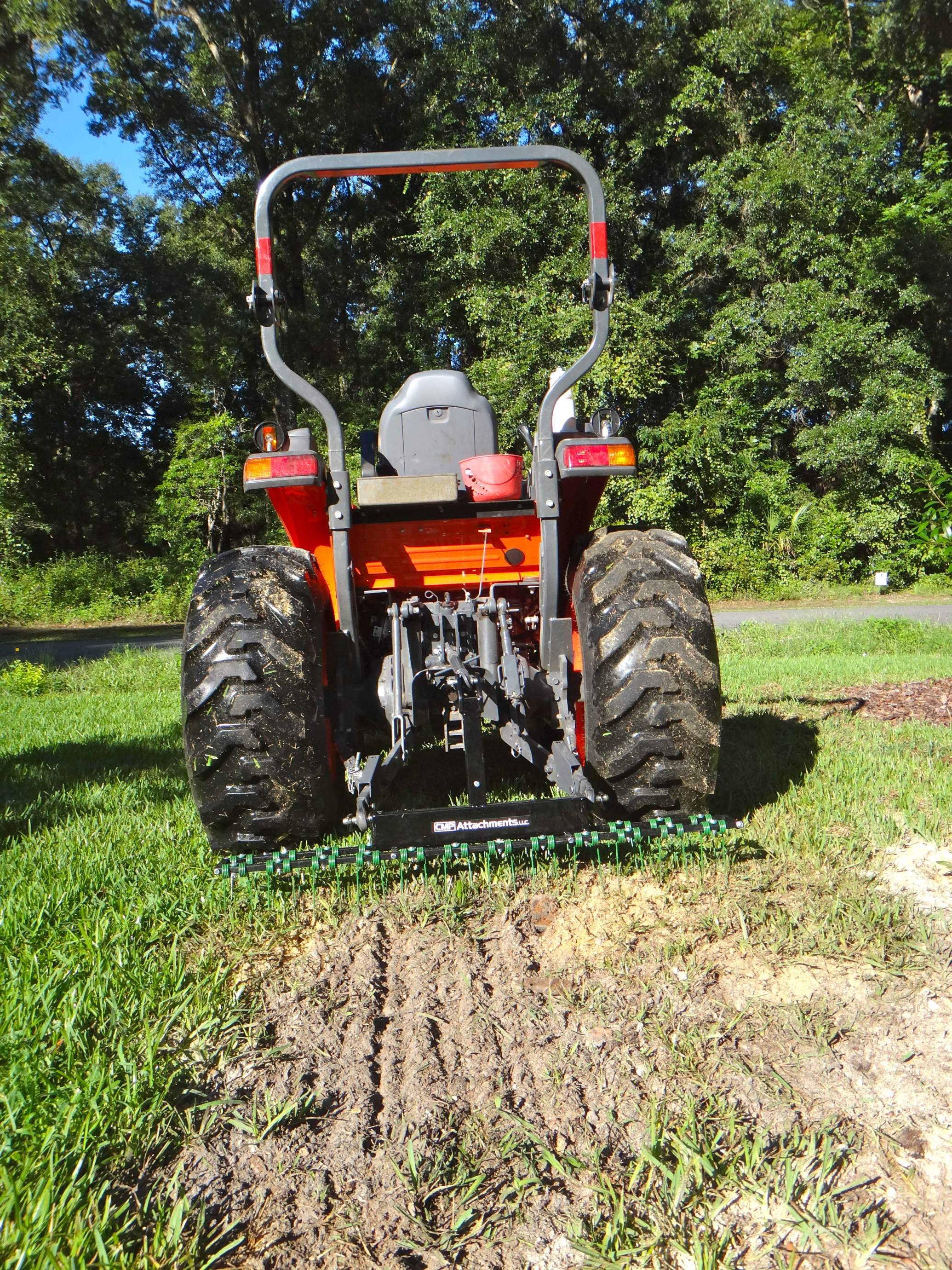

I do not know if you have calculated your expense to operate your tractor. I calculate tractor operation as a retired small business owner on a cost/benefit basis.
I calculate tractor depreciation at $10 per hour, implement expense/depreciation at $6 per hour (I own multiple implements.) Kubota dealer service at $10 per hour, Kubota insurance at $2 per hour, diesel fuel, various lubricants, including expense of transporting diesel fuel from gas station at $3 per hour = $31 per hour, and that is probably low.
(I grease my tractor. Kubota dealer performs all other service. Implement expense/depreciation includes welding repairs and occasional replacement parts. I buy implements new. )
Everyone calculates differently, but I value my labor at "0" in this formula, as my tractor is recreation.
I used a long 8' pallet to level my yard before the sod was laid. It took 6 - 8 hours of dragging it behind the garden tractor, but it worked great (with patience). The sod installers commented on how well prepared the yard was.
An easier solution would be to buy a chain harrow.
PDP used his lawn tractor to pull the pallet. Had I used my tractor to pull a pallet my tractor expense would have been around $200.
However, you see no future use for a Chain Harrow. But consider $31/per hour as you consider future implement purchases, such as a 48"/54"/60" roto-tiller, Three Point Hitch Garden Cultivator and a Three Point Hitch Lawn Dethatcher.
When you have repeating tasks, I consider dedicated equipment the cheapest way to proceed.

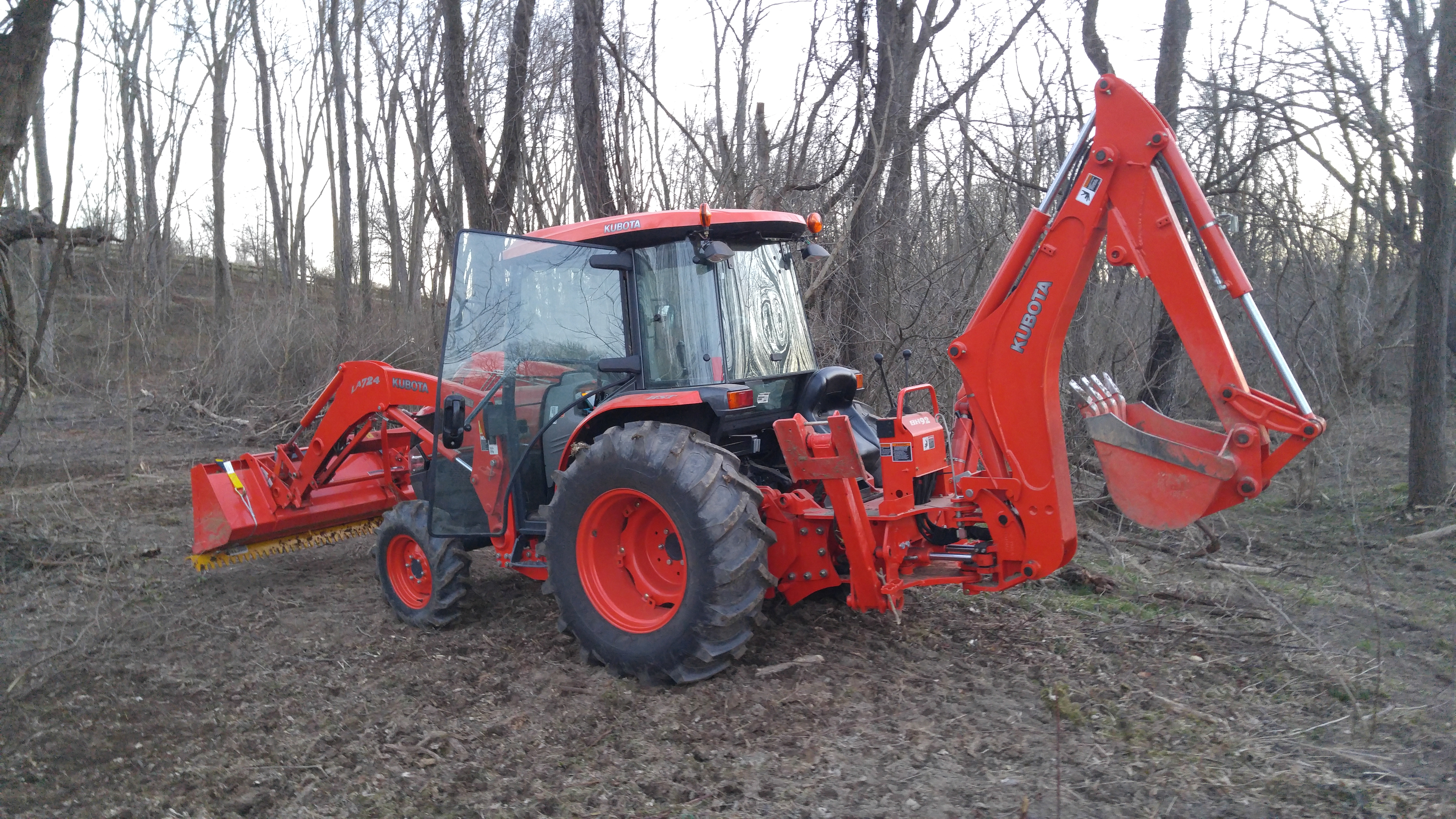

1488584387056.jpghere's some clearing I did.
