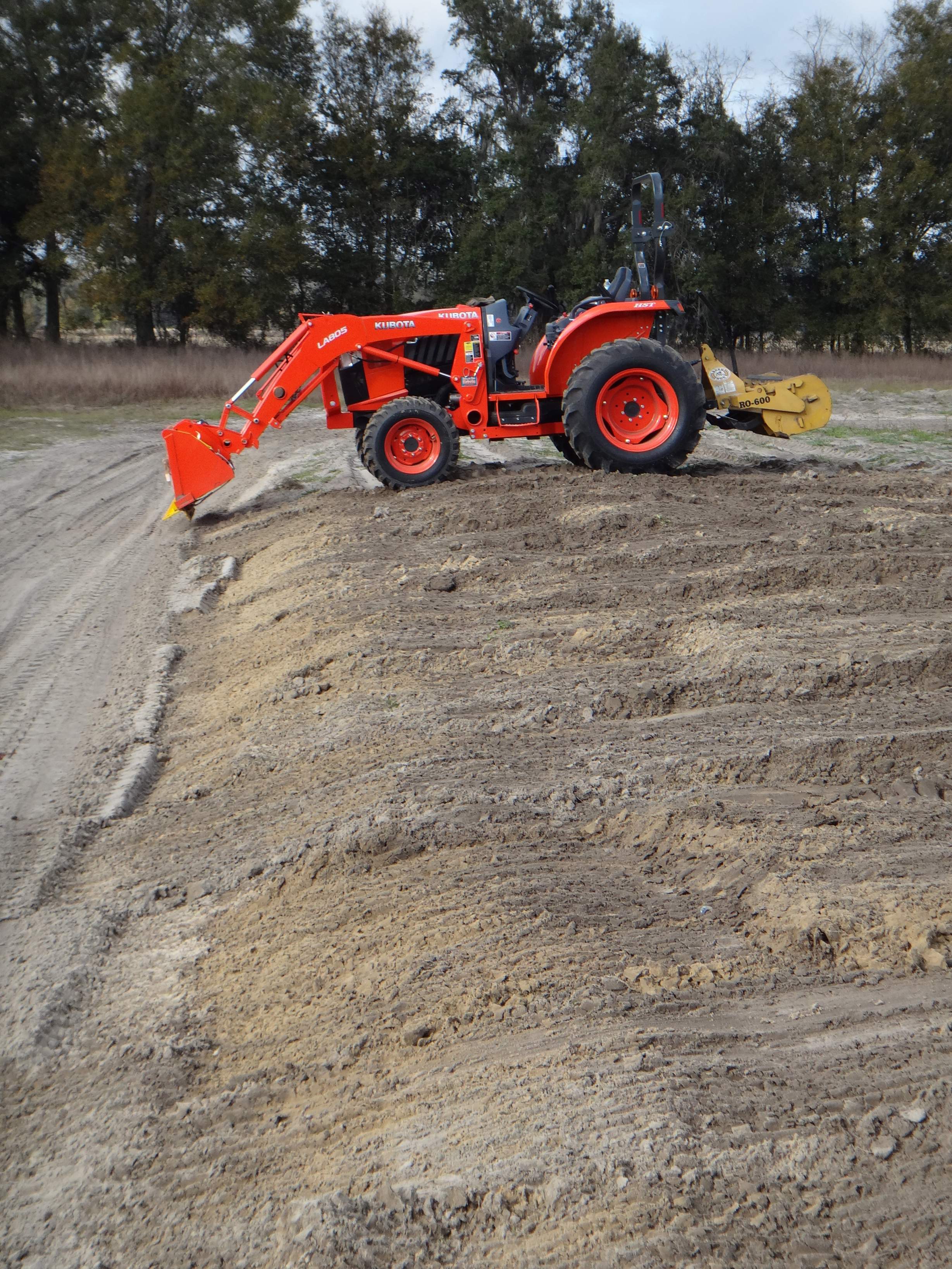

I own both a Ratchet Rake and a Rollover Box Blade.
When I have heavy grading to do, I mount my 60"/625 pound (125 pounds per foot) Bush Hog (brand) Rollover Box Blade on the tractor's Three Point Hitch AND the Ratchet Rake on my FEL bucket.

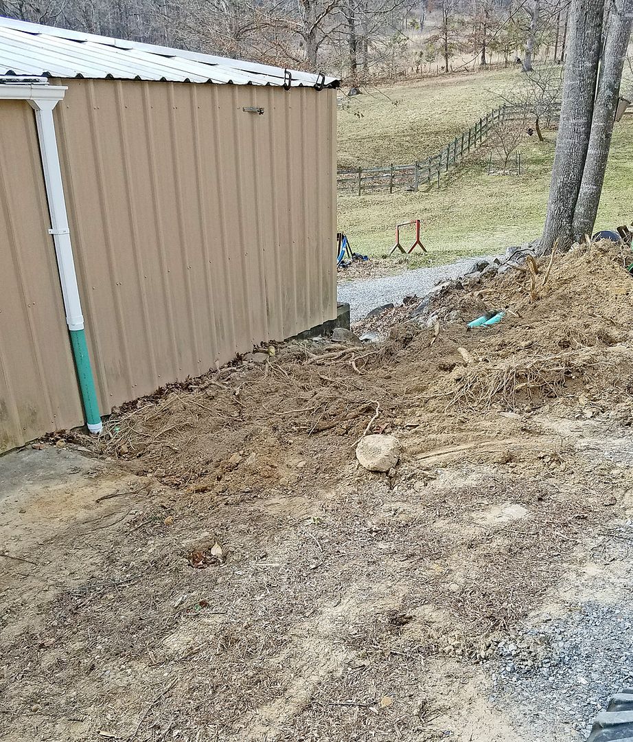

The way the 3 point hitch allows the landscape rake to "float" makes the Landscape rake more versatile compared to teeth on a bucket.
I raked this in a few passes with a landscape rake,,,
I have teeth on my bucket,, it would never do this job,,,
because the bucket is rigidly connected to the rear axle.
The spring-like motion of the teeth on the landscape rake also allow nicer results,,
compared to a ratchet rake.
The bucket tool will "dig" more,, the landscape rake will finish nicer.
