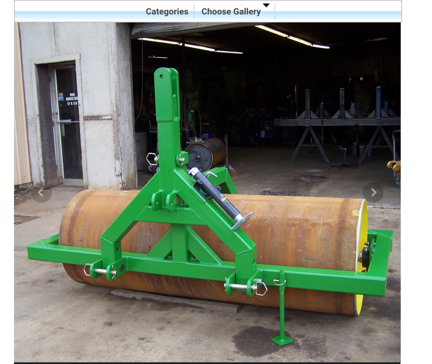

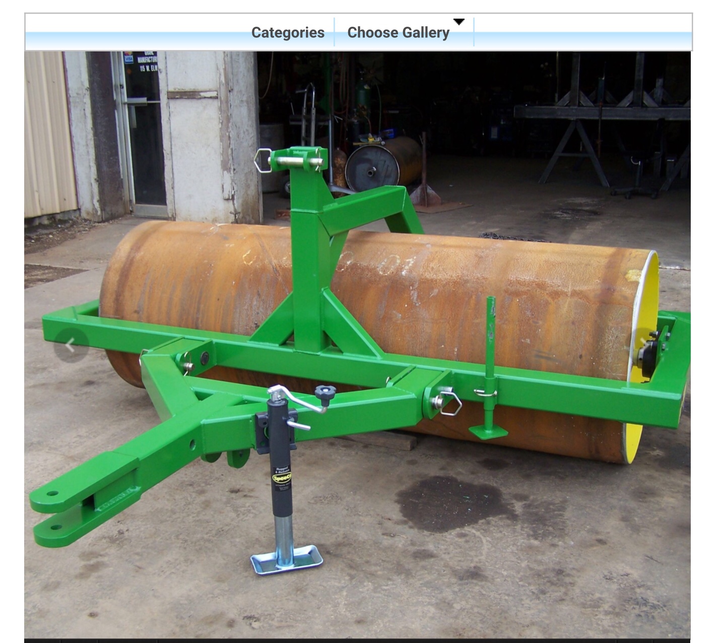

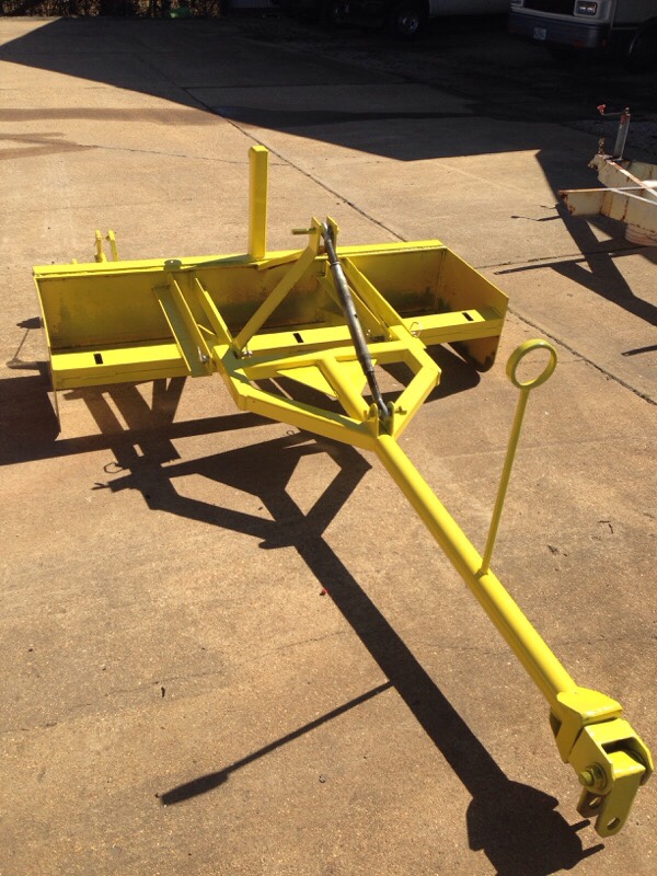

Yes, I used a top link to support my tongue , so i could adjust the angle, but I would use a hydraulic cylinder for doing what you are. The ball hitch should work out good, I use different stuff on my draw bar so I just built a swivel clevis. You’ve done a very nice job on your build.View attachment 545691View attachment 545692
My concern is setting the box blade with all this extra weight farther back may be more than my tractor can handle. I have been playing with basically the same tongue design as your pictures. I just decided to try out the 3 point hitch version first. When I raise the hitch the steering is touchy. Might have to double the front weights. That would help with my heavy roller too.

This is an excellent idea, and would be a great way to make the BB1284 quick hitch compatible, by mounting the 3 point mounts on the tongue in the correct location to line up with the quick hitch. I may use this.
In the next few weeks I should have the tongue worked out and can send you a cut and build sheet. I will post the pic in this thread.

I appreciate your taking time to provide all this information. Certainly not an inexpensive project.
I modified a Landpride box blade as others have done by adding a hydraulic rockshaft to the rear but just pivot mounted and no parallel linkage and caster. The wheels are fairly close to the back of the box blade so no caster is needed even in 3PH mode. Your independent twin lift control sure adds a lot of capability to the package.
I used similar logic in determining the pros and cons of 3PH mounted versus tongue pulled and made a pin-on tongue so it could be used either way. Your flip-up tongue is more convenient and adds more weight for downforce when folded for 3PH use.
Would love to have the laser control but probably not going to happen with my hobby budget. :)
When I started these designs. A few years ago I knew then that the parallel linkage was the way to go. I looked at countless designs by others such as Level Best and just did not like the idea of the caster operating at an angle. It just made more sense to keep the caster swivel plumb for smooth turns at all height positions. I will post some better pictures showing the wheel carriers. They are heavy duty with no slop or play in the linkage.
That would be very much appreciated!

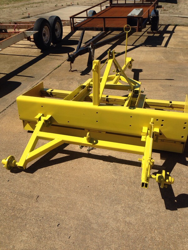

I thought that I understood the reason for caster wheels and the resulting need for the parallel lift linkage but now I'm not so sure. Is the need for casters brought about because of the distance of the wheels behind the blade? When pulling in the trailing mode is there any issue with the rig running off center on a steep side slope because of the castering?
I understand that turning while operating would require that the blade or the wheels slide sideways but that wouldn't seem to be a showstopper. Just trying to understand the dynamics since my rig is set up with just a pivoting lift as are most soil movers of the type.
/ Finally built a laser grading rig using my box blade.
#49
First of all I have not put the caster locks on yet. I was just trying out the new rig to verify the hydraulic and electronic operation.
On a steep side slope the caster locks would help when releasing the dirt in low spots. In high spots while cutting the wheels will raise up clearing the ground.
The casters help reduce the stress in sharp turns, I can definitely tell the difference as the turns are very smooth. Making the orbital movements between the borders as you work down a field can stress every part of the machine. I am hoping that smooth turning casters help with this but time will tell.
