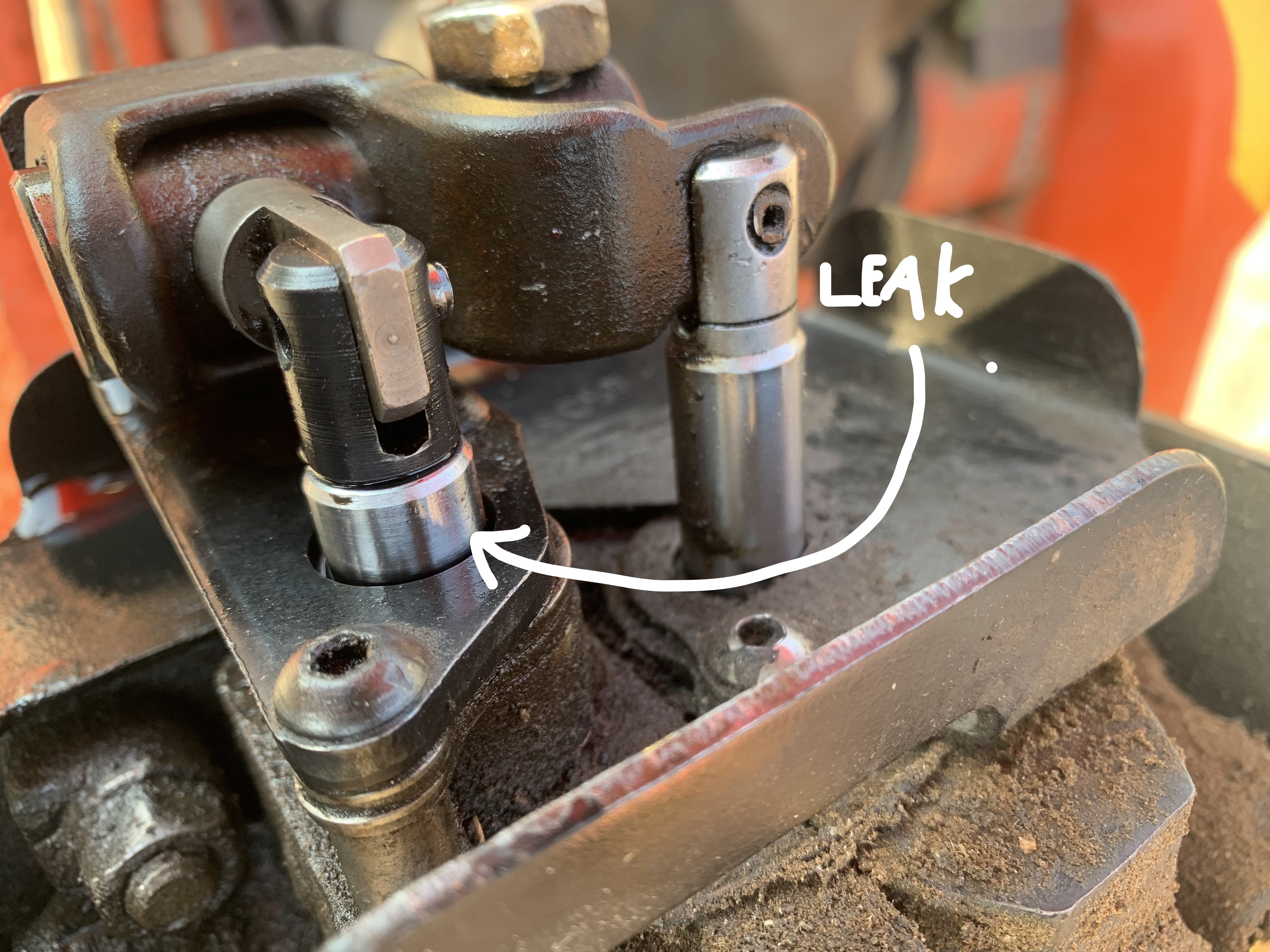

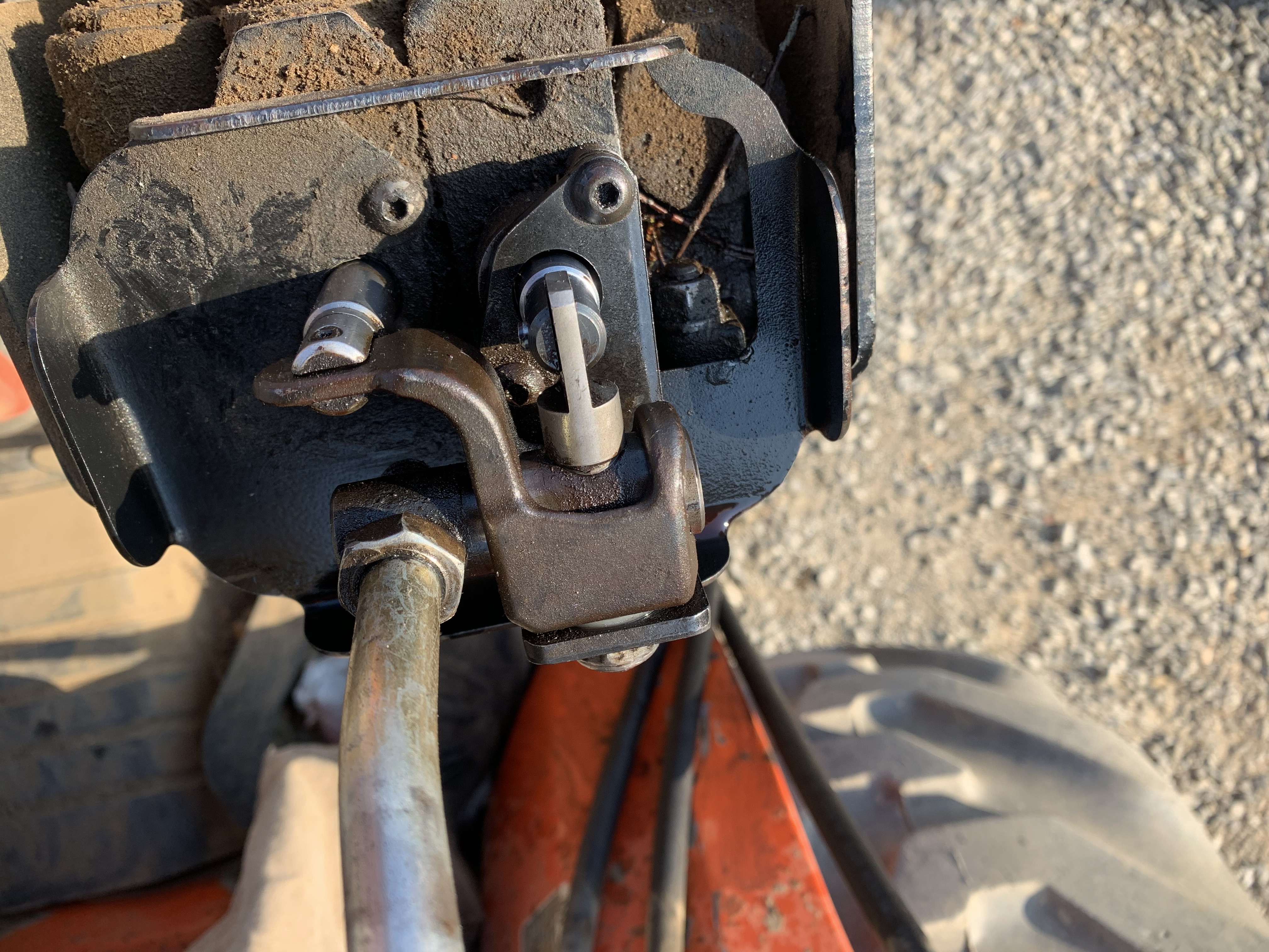

I have a Woods 1016 loader on a Kubota L3410 HST. Under load there was a leak from the valve assembly, which was worsening (leak is not from any hose). I took off the boot and think I figured out where the leak is coming from. See the pictures - seems to be from the cylinder - plunger(?) wall - this is where I 'think' I see leakage under load - hard to discern. I replaced an o-ring on the connector piece that screws into the cylinder in case the leak was from there - did not resolve the issue.
I looked at my Woods manual (a manual for 1009, 1012, and 1016 loaders). The valve assembly/kit I have does not match any in the manual though the 1009 Husco valve in the manual comes close.
So not knowing what brand of valve assembly I have I cannot locate a blow-up diagram of the device and cannot determine what parts might work to fix it. The valve kits in the manual identify repair kits and seal kits but I apparently don't have any of those valve assemblies.
I can take it apart to try to spot the issue and perhaps find any part or seal or whatever I might need but that could be a dead end journey. I don't know what I might find and don't know if I will be able to find any parts I might need. Or, I could disconnect the valve assembly from the several quick disconnect hoses and from the three hard fastened tubes and take it to a shop to see if anyone can repair it.

It appears to be a stack valve, some were it should have some numbers on each section.
As an example on a Prince SV stack valve the attached pdf shows were they put the part numbers;

I think you need a new valve ,The o ring seal is just a wiper seal if the spool is worn it will leak...

10 minute fix if you have the parts on hand. The cap on the other end of spool either screws off or there is two screws holding it on. Remove the cap there will be a spring in there, no it wont jump out on you. Remove the linkage on the control valve side of valve slide spool out the back side being careful not to damage the spool.
Right in the top of the valve casting there will be an O ring that is the part that is leaking, and needs to be replaced. Get a replacement at a hydraulic shop or a good tractor dealer, no big box store for this one. there will be one on the bottom of spool by the spring might as well replace that one too while you have it apart. No need to take valve off tractor.

Okay, true temper - this morning I did as you advised - there were two screws to remove. I unhooked the top linkage and slid it out - exposing a plastic ring and an o-ring at the top. I will take this in to the hydraulic shop this morning. One issue - perhaps you can also help with this - or the hydraulic shop can give me advice - when I took off the casing, as you said, a small spring fell out. Not a problem, but also falling out apparently with the spring were three small ball bearings and one slightly larger. I suspect there is supposed to be a fourth small ball bearing as I heard a ping. Used a magnet bar to search under the tractor but have not found what made the ping- suspect something dropped but I have all the screws, spacers and other parts. I will ask about the bearings and putting the spring back in at the hydraulic shop.

That spool you are working on is your loader boom spool. The balls are to hold the spool into the float position when you push the handle all the way forward. I am not sure how many balls should be in there, to be honest I forgot about the float function. But you found the bad Orings?
