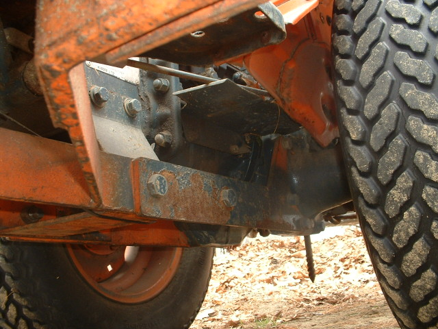

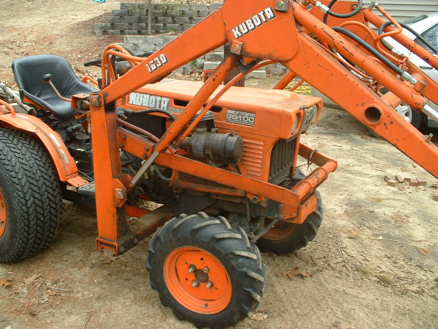

   / FEL Build for my Kubota B6200 #24
GPintheMitten, here's the pictures I promised. If you want a shot in a specific area not shown please ask.

Thanks for the subframe pictures, KubotainNH.

   / FEL Build for my Kubota B6200 #27
That's a Kubota made loader. It came with the tractor. GPintheMitten is looking into making one for his b6200 which is why I posted it. i can post other pictures but not sure what else could be added to what I already posted.

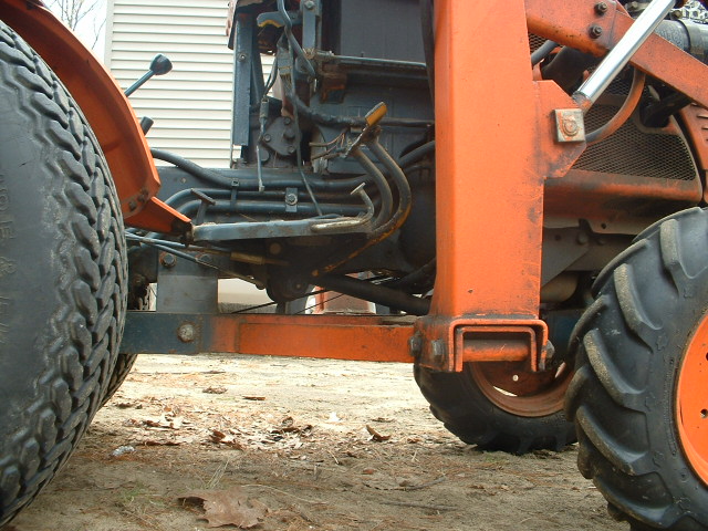

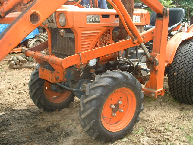

Onowino asked me to post a couple more pics of the front attachment points. There's basically 6 points: the front frame, frame mid-section on each side and 2 on the axle housing. Hope this helps.
   / FEL Build for my Kubota B6200 #30
Yeah, thanks Mike. The second pic shows me what I was wondering. I didn't realise the cross-member was that far back under the tractor. Now, will the subframe have to be removed for such operations as a clutch change? Thanks for helping out a first timer and thanks for being so prompt.
