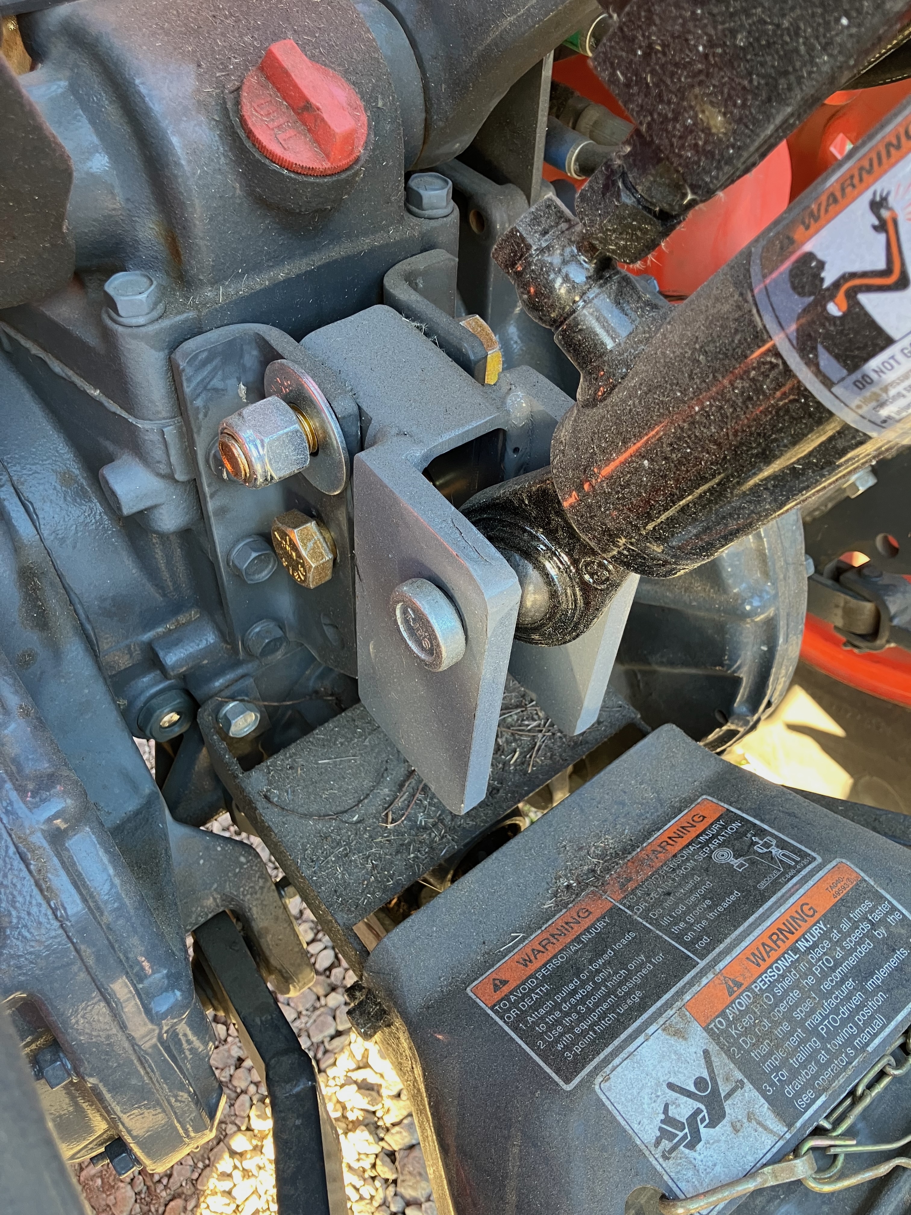

I just put the Pat's Quick Hitch (category 2 tractor with category 1 implements) on my Kubota MX5400. I use the Summit Hydraulic top link that has a maximum extension of 32", which like others have experienced, is not quite long enough to hook up some implements. I had a Pat's system on my previous tractor, (Kubota L3301) and really like how it helped hook up implements and I'd like to figure out a way to make the Cat II version work on my MX5400.
I have a machinist friend and he can weld up an short extension bracket that I can insert between the tractor and the fixed end of the hydraulic cylinder. Has anyone tried that type of adaptation? Are there issues that I'm not considering that would make that a bad idea? The bracket only needs to extend the top link a couple inches at most to solve the geometry issue created by the 4" extension that the Pat's Hitch adds to the lower lift arms.
/ Extended top link? #9
OP here: My buddy made a bracket similar to one I saw in another thread which I can't now find. Here's a picture of how it came out. The bracket moved the pin location out from the tractor about 3" and it solves the hook up issue nicely.

Nicely done... (sounds like you need to update your profile! L3301 to MX5400?)
