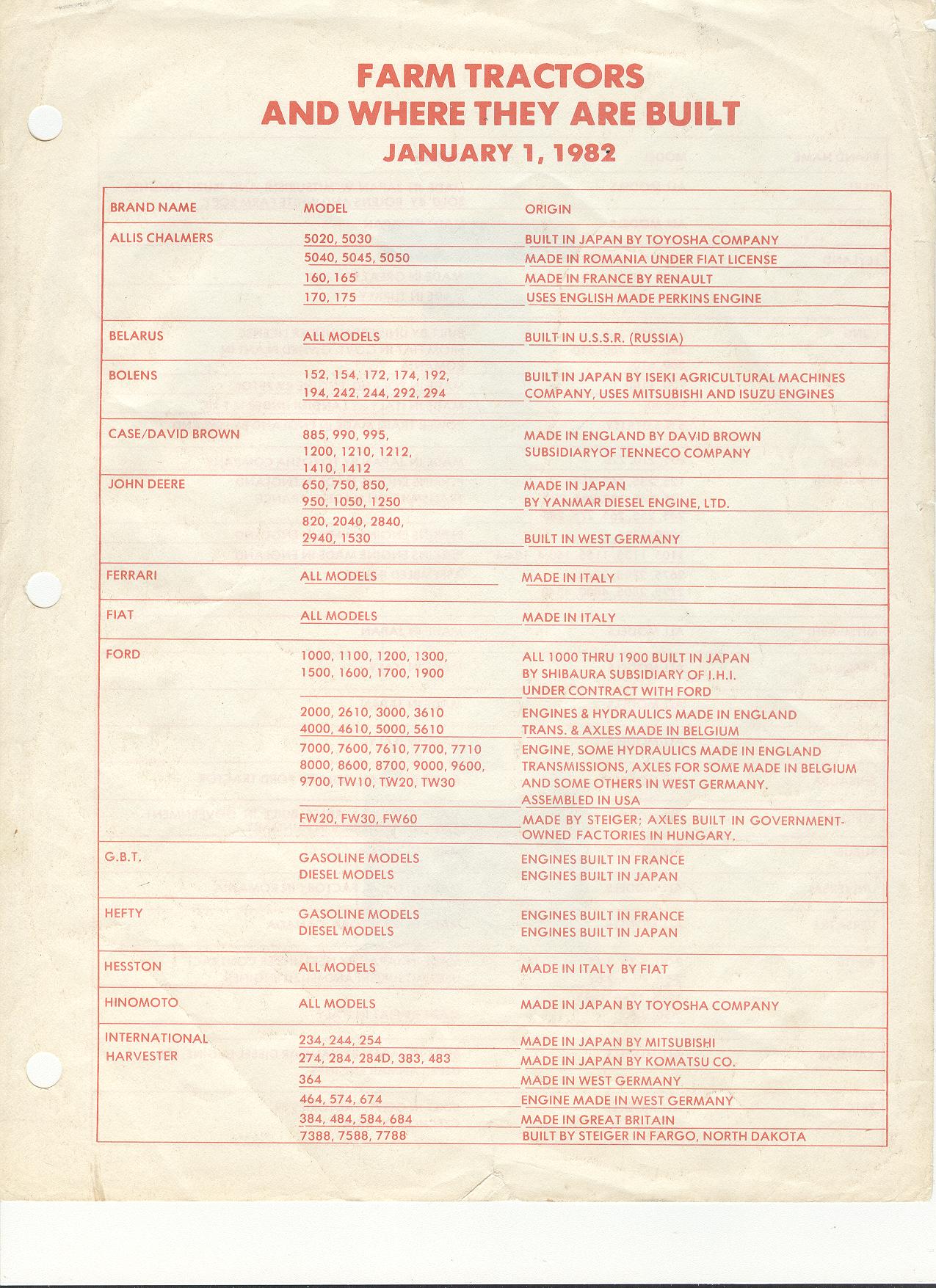

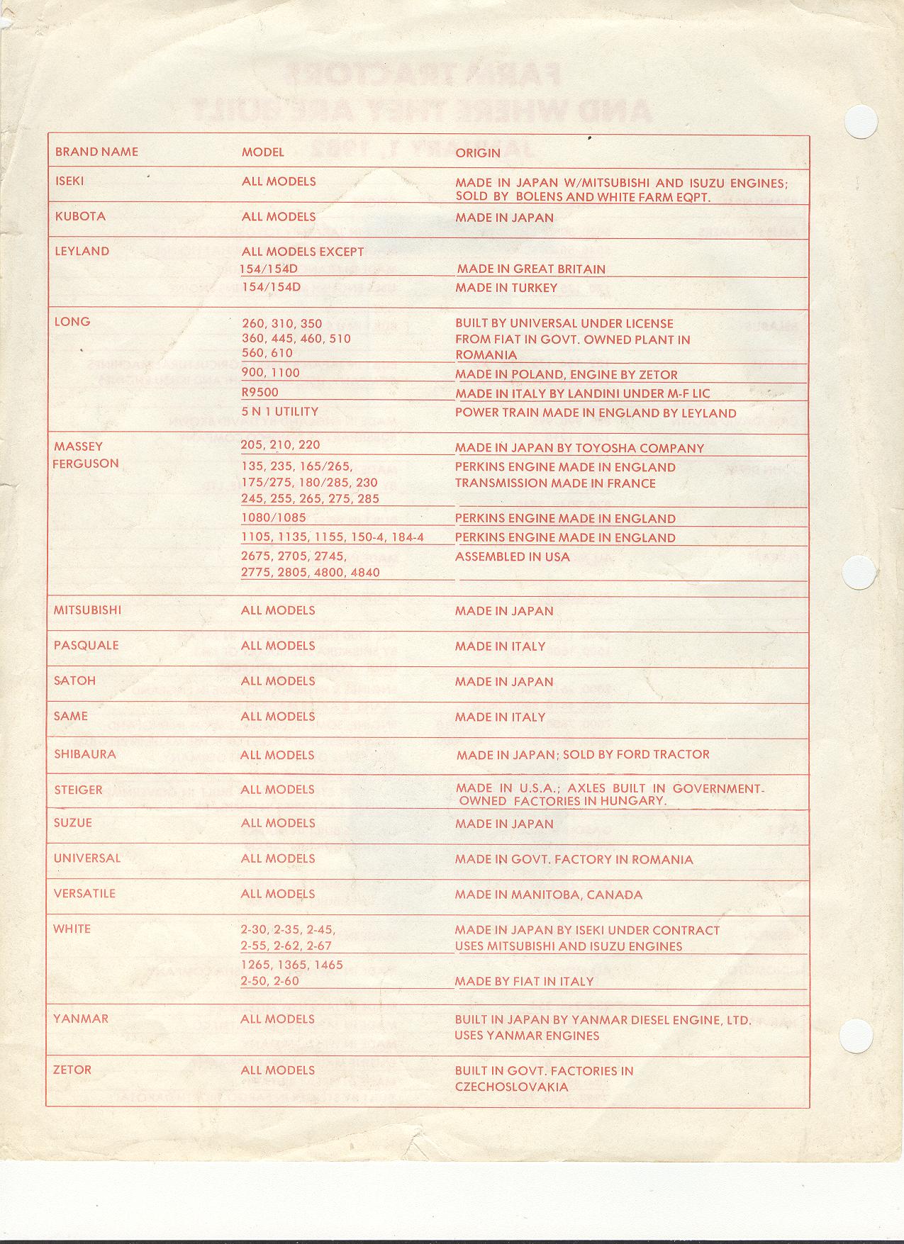

Well, I have to agree. Although I will say that a couple of years ago I had to choose between Yanmar, Branson, TYM, JD, RK, Kioti, Massey, Case, and Mahindra ..... And my choice turned out to be Kubota.
Yes, I know it isn't on the original list and yes, I know about the high price.
My other observation is that modern tractors last even better than the old ones, and the old ones lasted very well indeed. To my mind when any manufactured product has several brands that are known to be excellent, that means the time is right to bite the bullet and buy quality instead of going for lowest price. I am influenced in this because I like for my tools to be ready to go to work, and in return I keep them up and keep them a long time. Maybe a lifetime.
My second choice after Kubota would probably be Yanmar; their 5 year warranty is nice. I admit to being biased towards Yanmar based on experience with their older models.
TYM tractor advertisements proudly and prominently state that they use Yanmar engines; that says a lot to me.
If you think the choice is difficult today, at the bottom is a list of tractors for sale in the USA in 1982. Where today do you find parts for Hinomoto, Mitsubishi, Ford compacts, Shibaru, Toyosha, Isuzu?...lots of others.
rScotty
