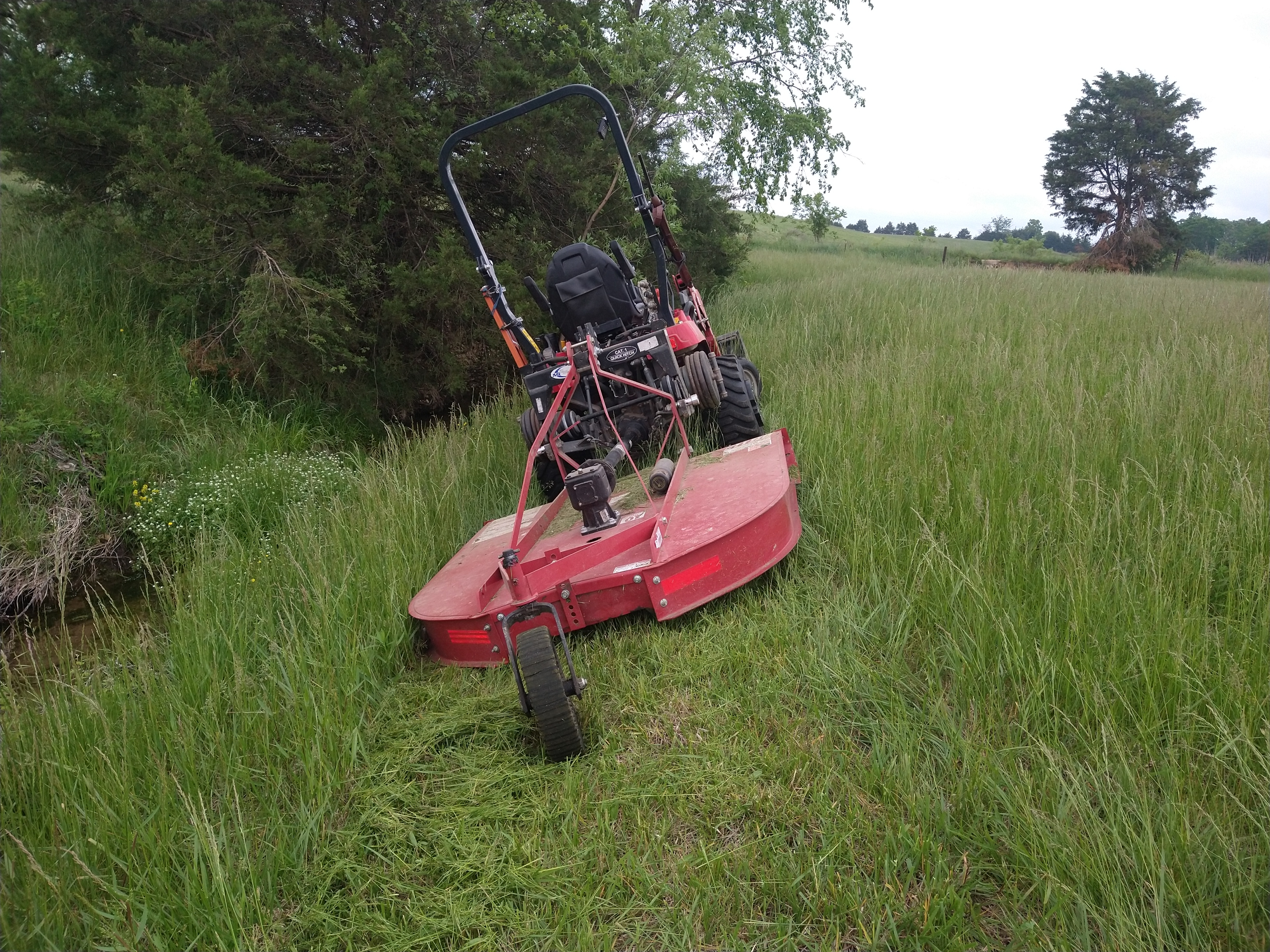

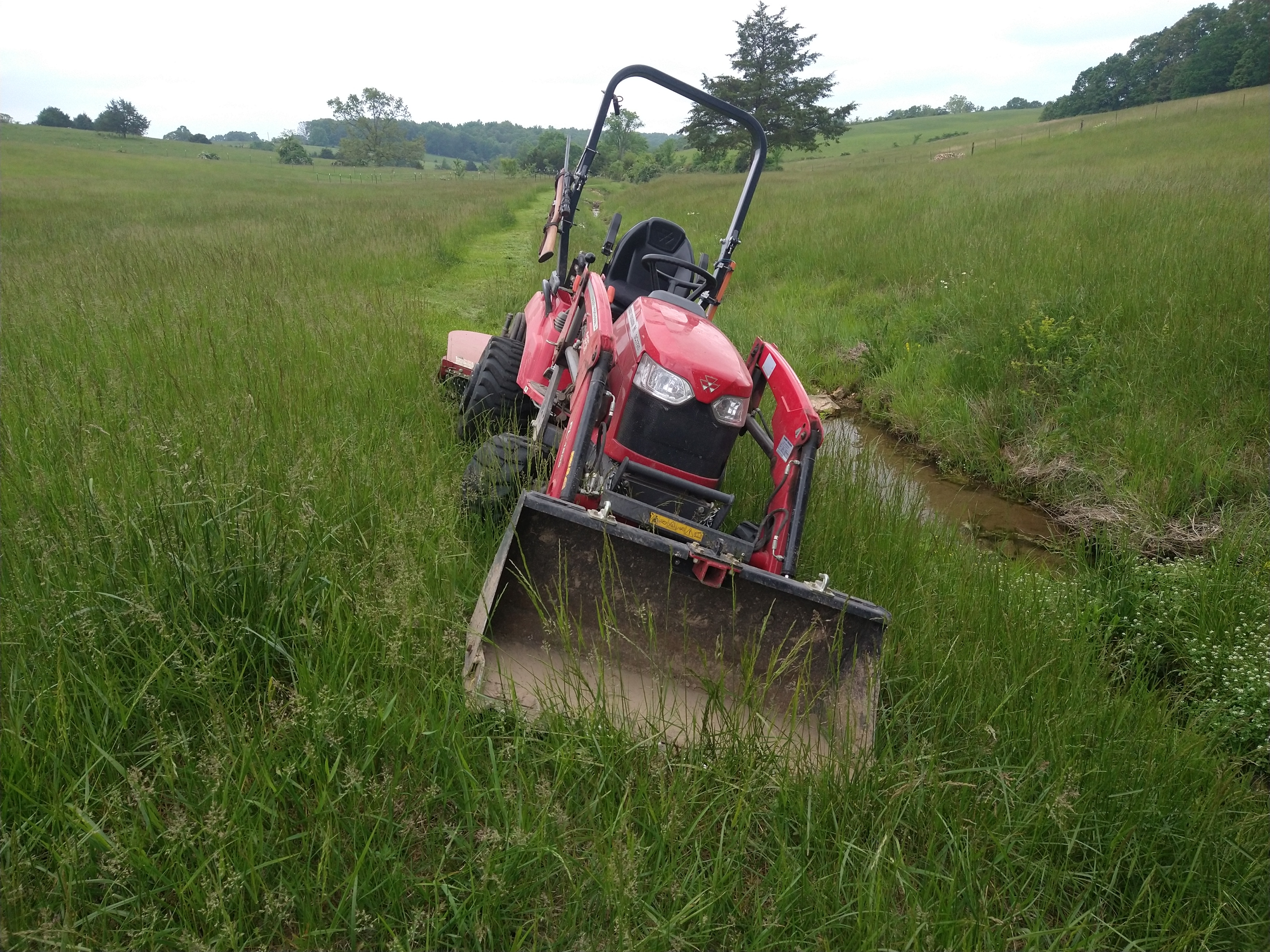

I've thought of buying an Inclinometers for my tractor just for the curiosity factory ...
I know there is a vast difference in how slopes are measured ... Angle, degree, percent ... This is about as steep as my "Butt-O-Meter" would let me go ... And when I got off, I tried ... And couldn't even budge it!!!
The picture isn't quite level, it's a tad steeper ... The Trees are vertical ...
Here are a whole bunch of styles ...
Inclinometers | Slope Grade Degree Indicator For Sale | R&B MFG. INC

It’s stable until a wheel drops into a hole.

From that page, most of them don't go to 45 degrees... but one in the middle is U-shaped, and should work up to 90 degrees... just in case you need it.
There are also digital inclinometers that you can use. I think even a cell phone app. Just bring a 2x4 to smooth out the bumps in the slope and measure with your phone.
Or for percent slope, it is just rise over run. Bring your level. One end on uphill part of the slope, measure from the other end down to the slope. Then rise over run and you get the percent slope.
