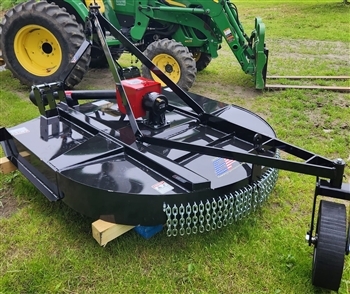

With a brush hog or rotary cutter attached, a wheelie isn't going to happen, other than possibly a few inches before the slack in the mower bottoms out.
I would question the wisdom of the thin little straps on the back of a bush hog preventing a rear roll over.
I am pretty sure you can have a small child bend the rear braces by hand as 1/4"x2" has very little compression strength. The upright mast is just held on by a single bolt on each side, creating a pivot point.

Not trying to be a jerk. But the photo with the thin little straps is from this link.
I still stand by my point that the thin braces on the bush hog have little stopping power on a rearwards roll.
