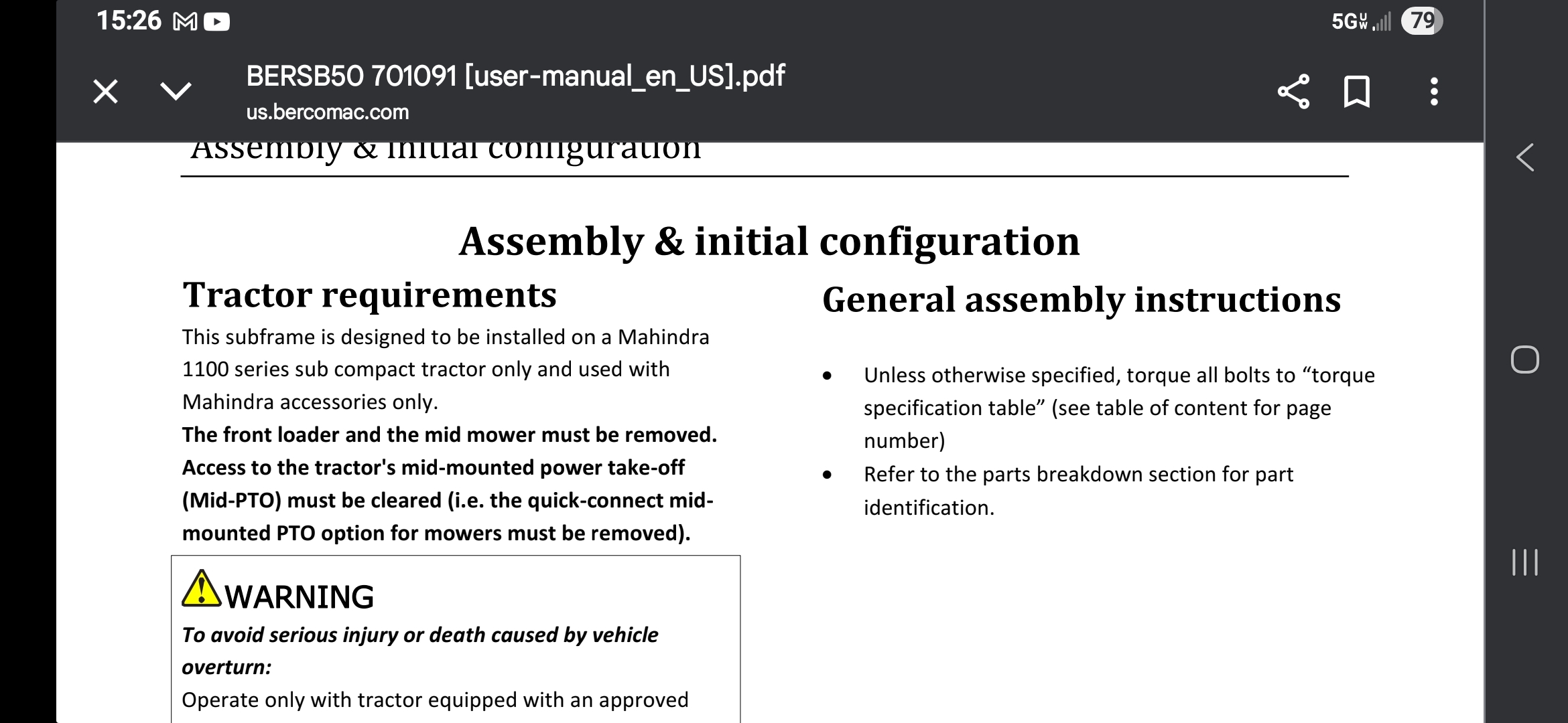

I know this is an old thread, but I've been learning alot about the 1100 series.
Apparently, the mid PTO front mount snow blower made by Beromac for Mahindra and Bercomac branded snow blowers are incompatible with the Mahindra quick mount belly mower brackets.
The front mount snow blower specifically requires you to remove the mowers frame mounted PTO brackets before installing the snow blower. Read the highlighted paranthesis from the snow blower manual.
I've gone to 3 different dealers and none of them had a clue about how this tractor works. In fact, only one new that the quick attach deck was an auto capture. They incorrectly described the deck mounting as the same as an eMax. until I asked them to look at the owners manual.
The dealer who actually knew how the deck functioned, was unaware that the mower mounting PTO assembly needed to be removed and called their mahindra rep to verify. He was told that a rework of the mounting system was being contemplated, so you don't have to disassemble the PTO bracketing to install the snow blower.
I still don't know if they meant the mower deck mounting or the snow blower.
