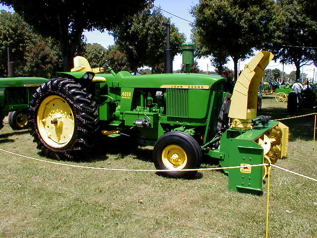

As far as i know, the 4000 series tractors do not work with the JD front blowers so if you want that then you need to stick with the 3720.
The rear pull Erskine looks interesting. The only negative I see is getting the tractor stuck in deep snow, as the tractor has to go into it first. With 4 wheel drive and chains, it might be ok though.
/ Erskine rear pull snow blower? #7
/ Erskine rear pull snow blower? #8
AHA, ya got me;)
The late model JD front blowers do not work with the LATE model 4x20 series tractors. Not sure why though:(
