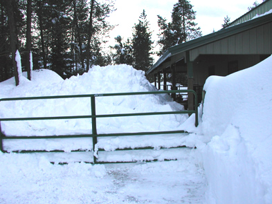

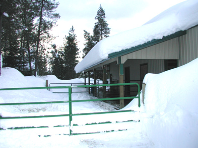

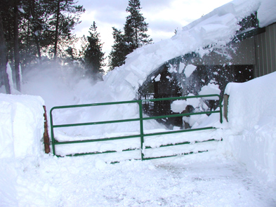

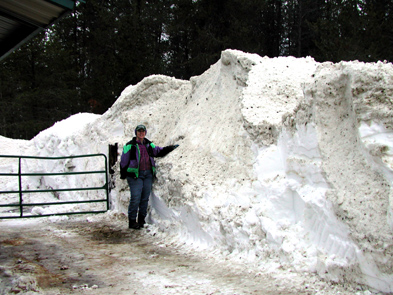

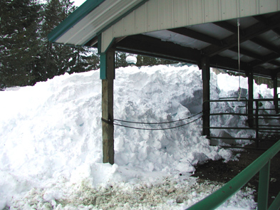

i have a "Quickattach" brand front snow blower with rear hydraulic powerpack. i think mine was in the $9,000 range when i purchased it 9 years ago. not sure what it cost now days. mine runs 79" wide, and runs at 15 GPM, 3,000 PSI.
for me personally, i could not use a rear push or pull. the main reason i have a front is due to having to move large amounts of snow that sheds off of my buildings. when the horse barn sheds, i have 5-6' tall piles of snow to move. cant possibly drive over it. my old tractor had a rear push blower, and it took up to 8 hours to clear this mess. with the new hydraulic blower its under an hour. I really think it all depends on the type of snow you encounter. also with me, my neck issues were getting real bad. the constant looking backwards was wrecking my neck. i was getting my neck actually locking up where i had difficulties turning my head.
snow shedding e side BEFORE 2008.jpg snow shedding E side barn DURING 2008.jpg snow shedding e side AFTER 2008.jpg snow shed off w side barn 2008.jpg Corral Mtn Range B 2008.jpg
View attachment 682701 View attachment 682702 View attachment 682703 View attachment 682704 View attachment 682705
Well that's WAY more snow than we get here, I can understand why you chose the equipment you've got! I could see using the FEL mount to help out a couple of neighbors when the snow gets piled high, but I can't justify (to the CFO) spending that much coin for our use.
Thanks for the info and the pics.

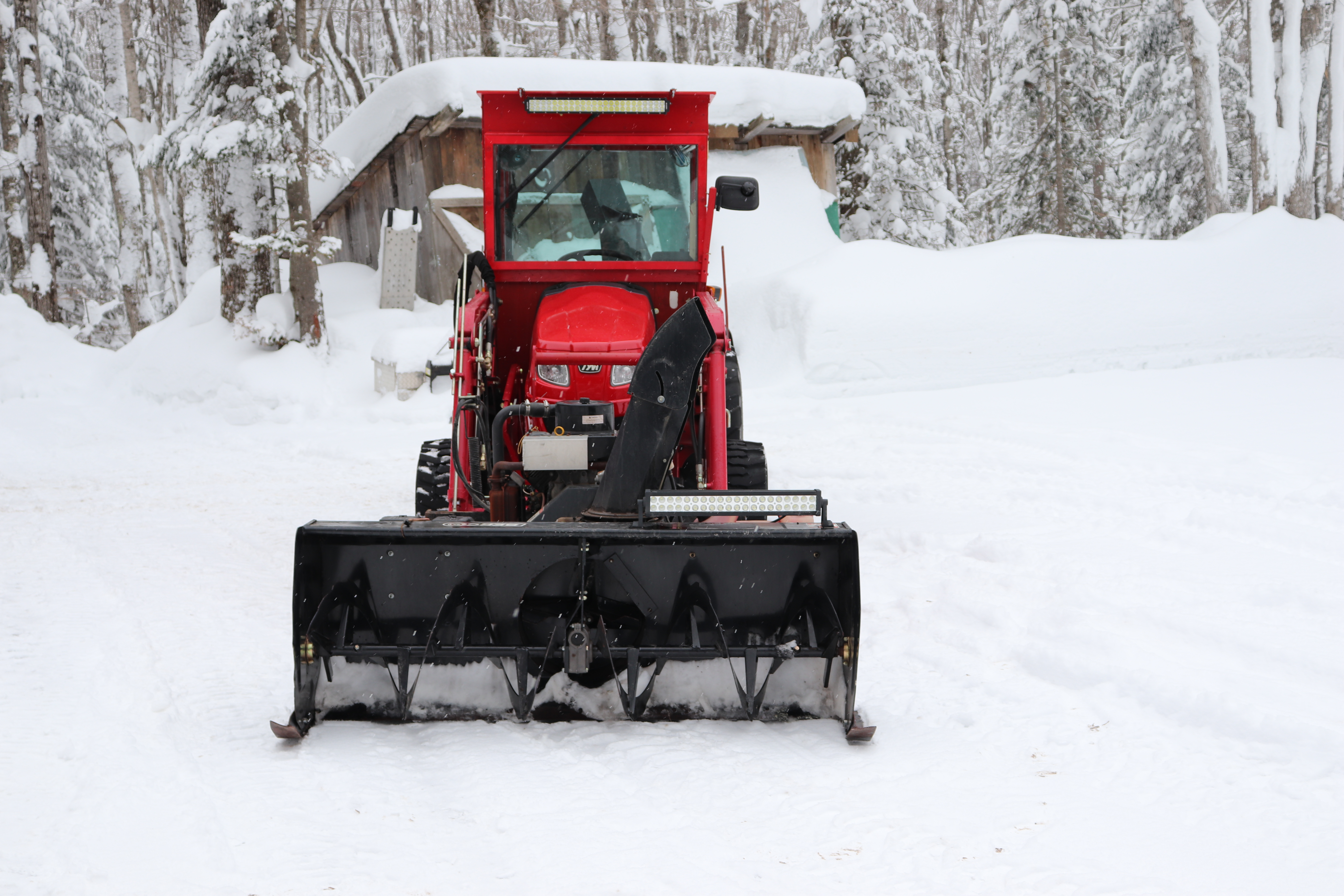

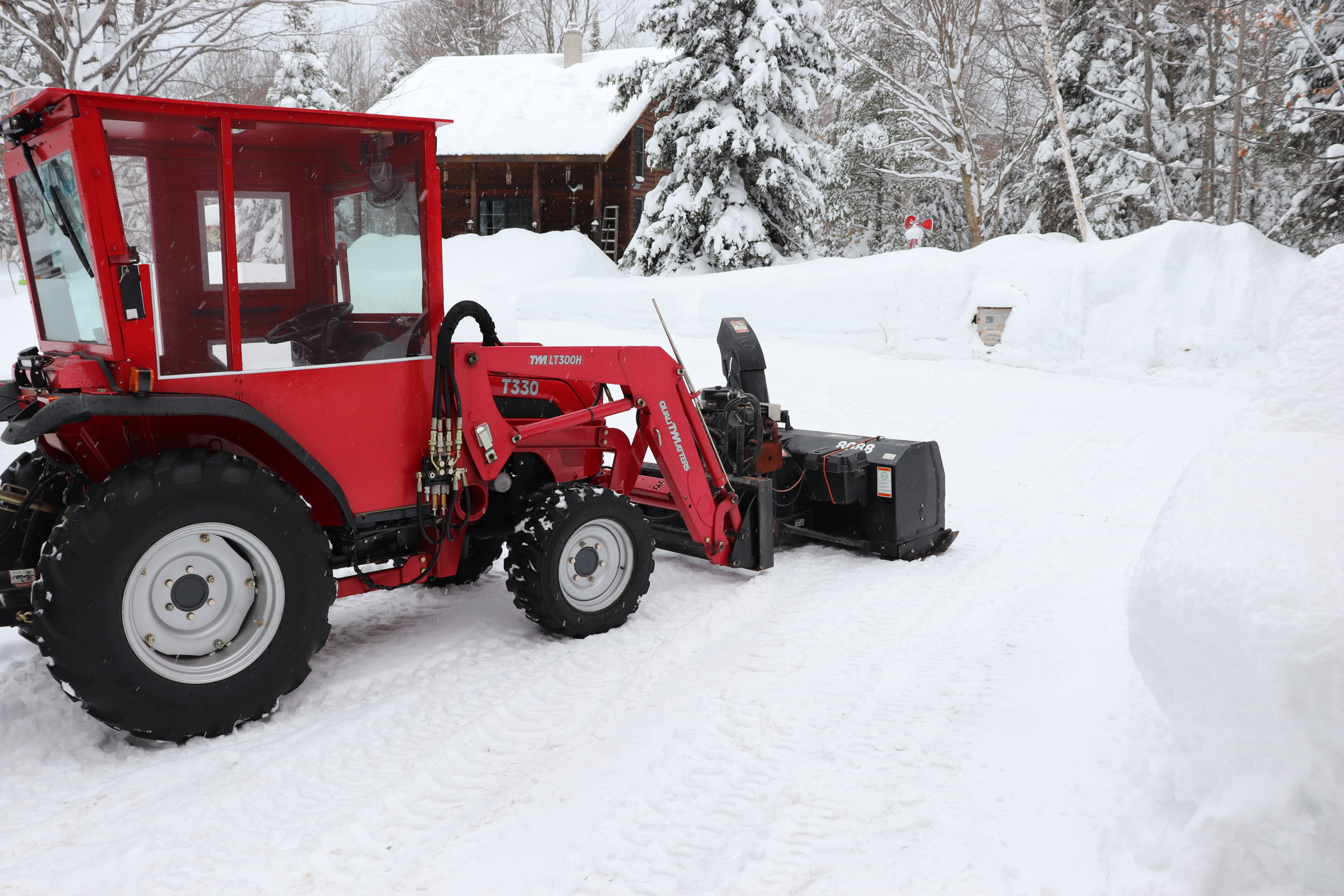

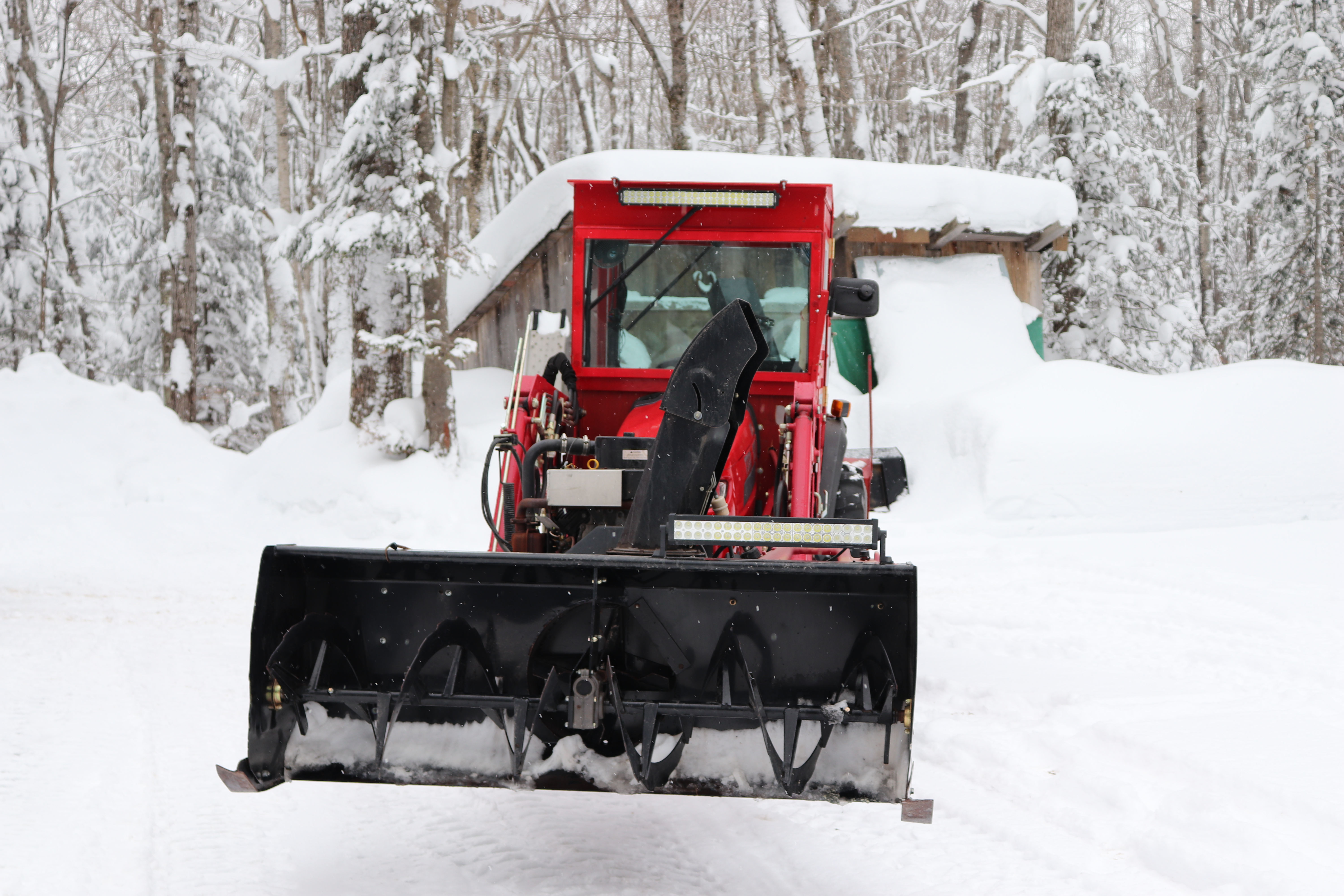

John, This is what I use. I can switch to the loader bucket or front plow in less then 5 minutes. The cost is far less then the alternatives you have listed above. I can blow snow drifts or the snow that slides off my roof as high as I can lift the loader if I have to. If you ever get up to Keweenaw County I would be happy to show you how easy it is to hook and unhook and how good it blows snow. Although we haven't had very much this year only about 65" so far.
YooperView attachment IMG_0664.JPGView attachment IMG_0668.JPGView attachment IMG_0669.JPGView attachment IMG_0652.JPG
/ Snowblowers: FEL Mount vs Rear Pull
#19
YooperView attachment 683035View attachment 683036View attachment 683037View attachment 683038
Thanks Yooper.
Self powered blower? Is that a Kohler engine? What hp? Not out of the question but I haven't seen anything like that for sale. What brand is that, can't make out the name on top of the blower in pic #2. I get up your way two or three times a year, not usually in the winter though. If I should head your way in the next month or two I'll contact you here.
