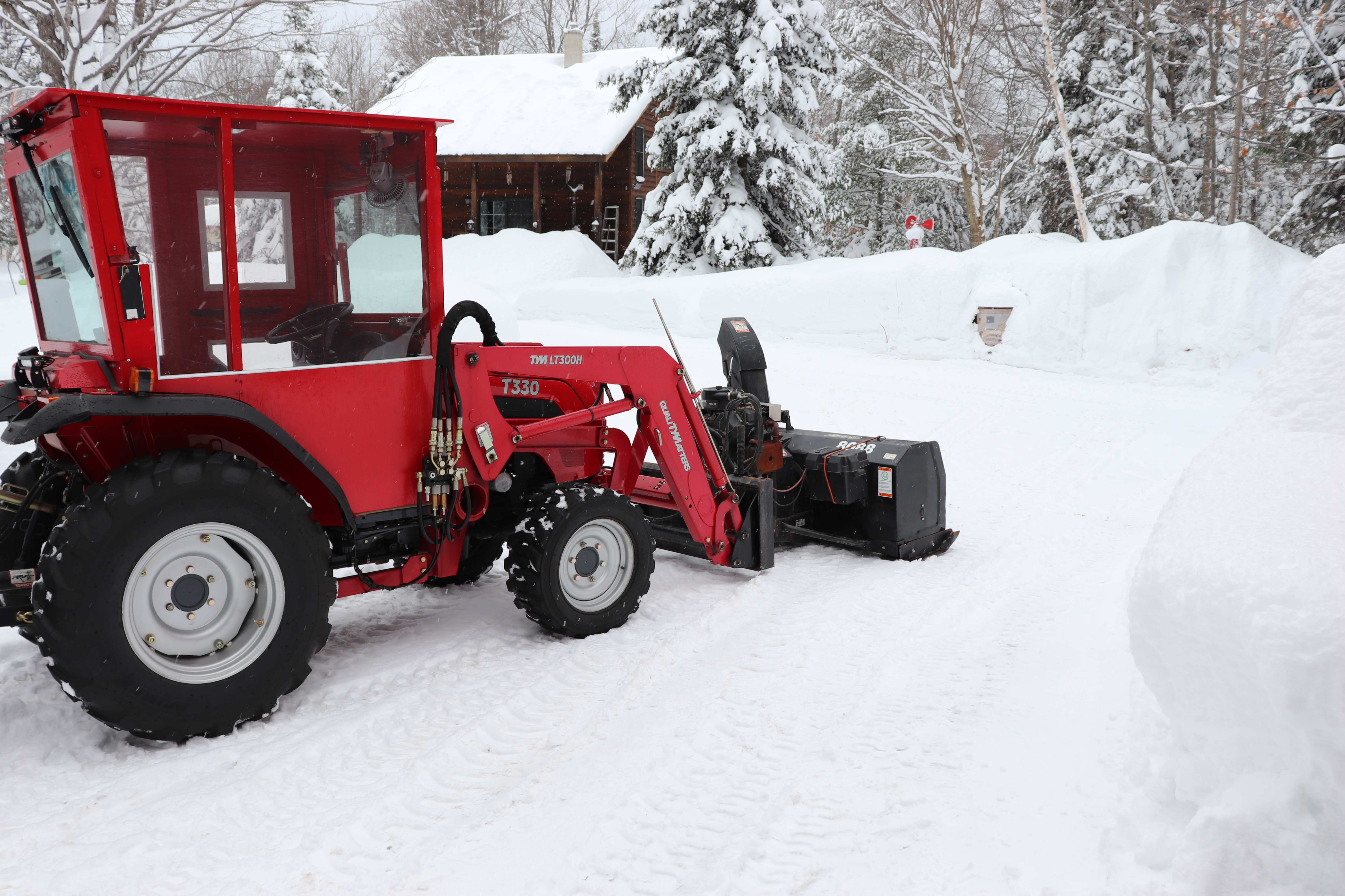

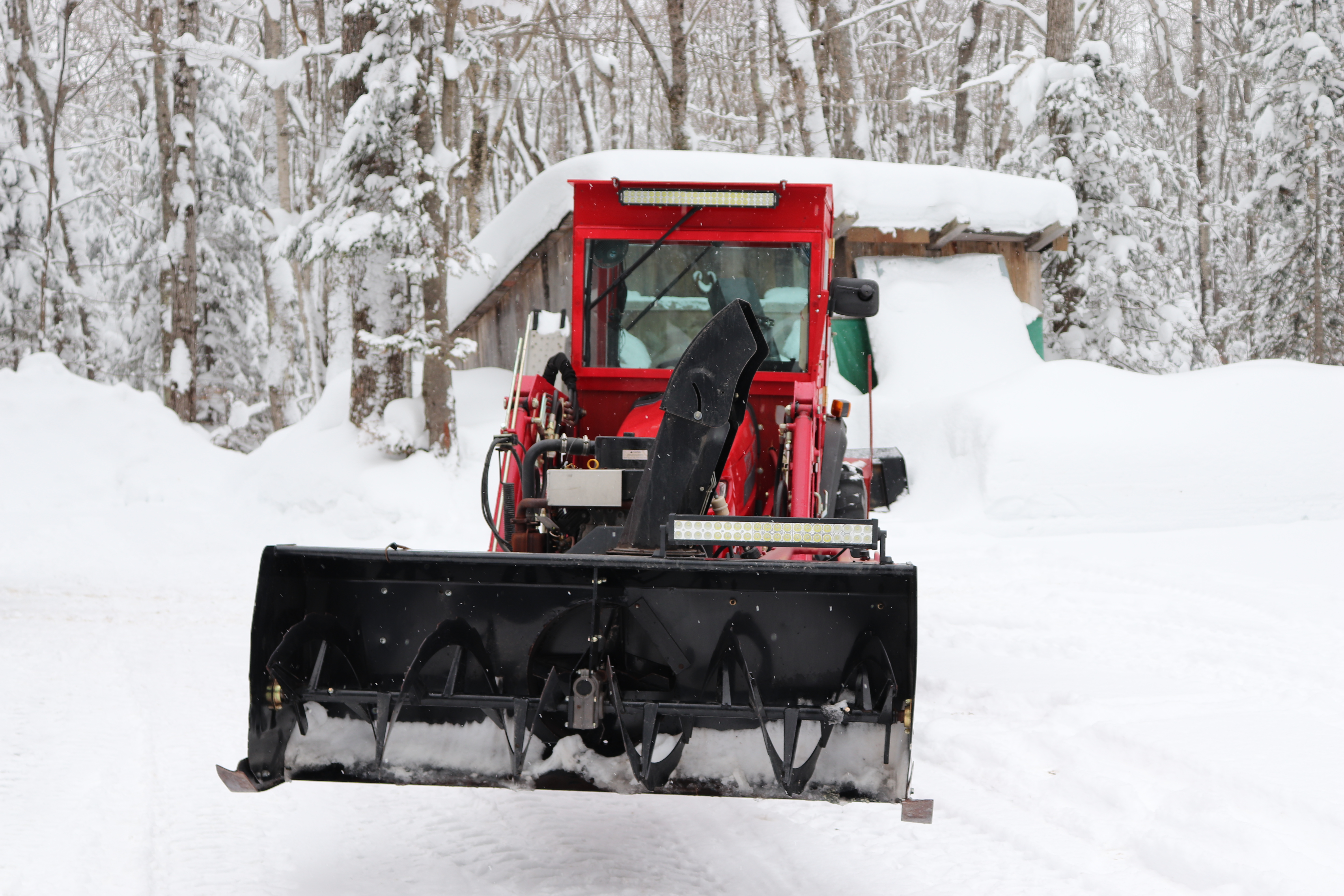

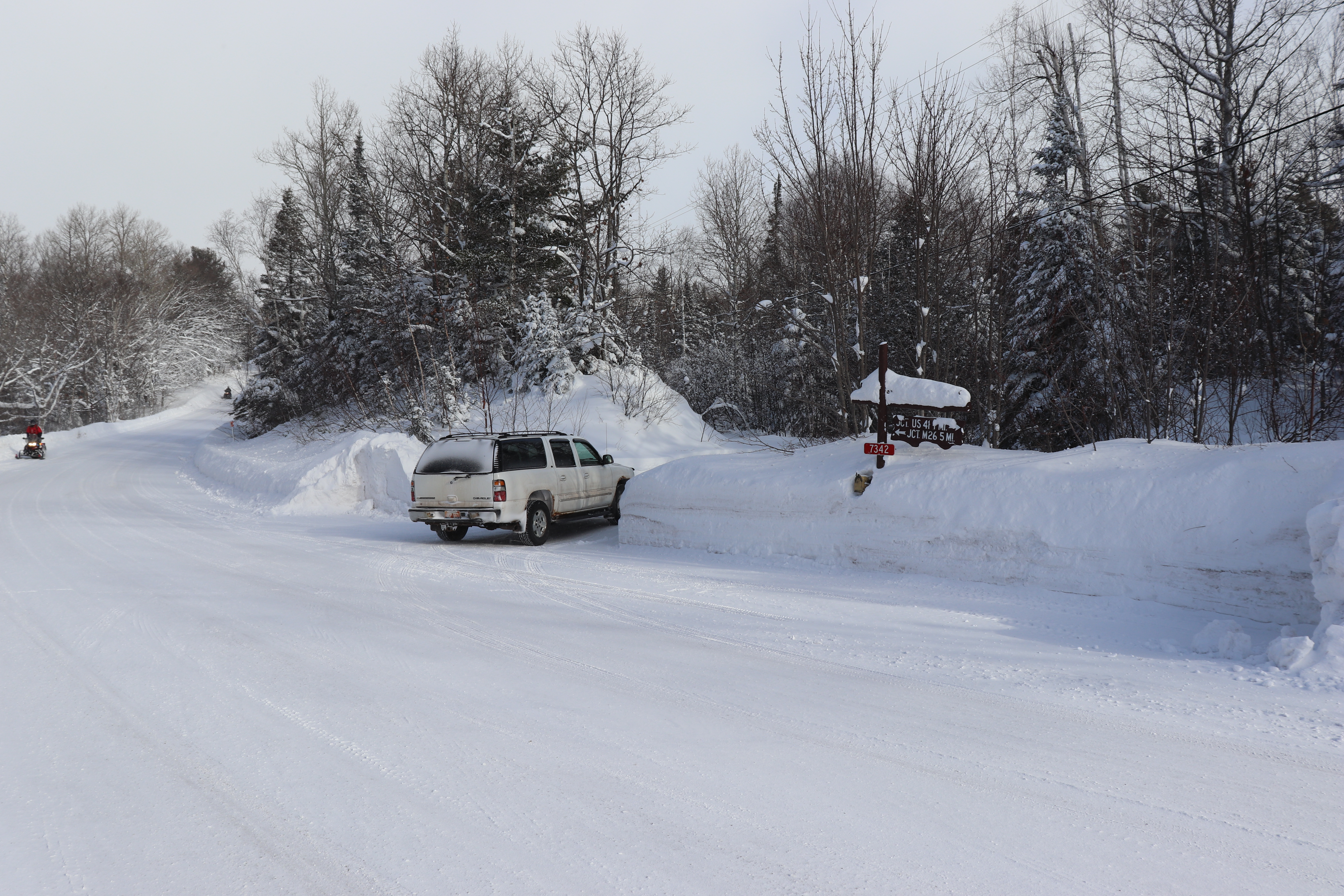

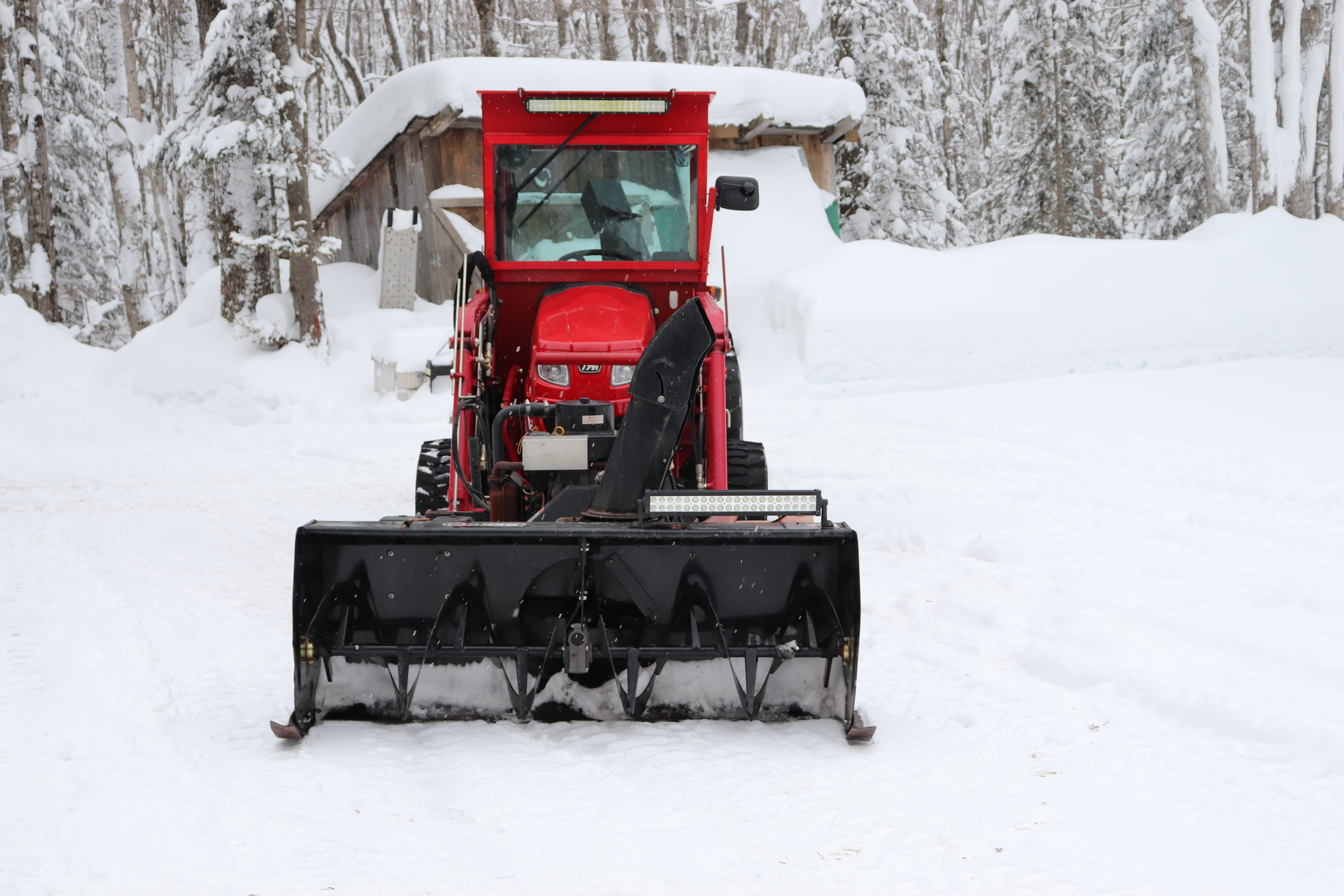

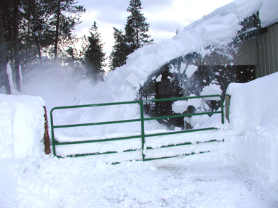

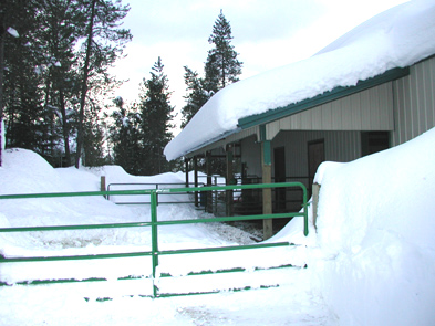

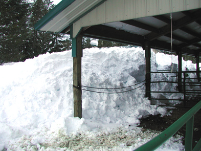

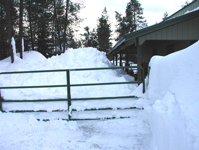

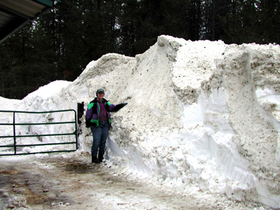

i have a "Quickattach" brand front snow blower with rear hydraulic powerpack. i think mine was in the $9,000 range when i purchased it 9 years ago. not sure what it cost now days. mine runs 79" wide, and runs at 15 GPM, 3,000 PSI.
for me personally, i could not use a rear push or pull. the main reason i have a front is due to having to move large amounts of snow that sheds off of my buildings. when the horse barn sheds, i have 5-6' tall piles of snow to move. cant possibly drive over it. my old tractor had a rear push blower, and it took up to 8 hours to clear this mess. with the new hydraulic blower its under an hour. I really think it all depends on the type of snow you encounter. also with me, my neck issues were getting real bad. the constant looking backwards was wrecking my neck. i was getting my neck actually locking up where i had difficulties turning my head.
View attachment 682701 View attachment 682702 View attachment 682703 View attachment 682704 View attachment 682705
Well that's WAY more snow than we get here, I can understand why you chose the equipment you've got! I could see using the FEL mount to help out a couple of neighbors when the snow gets piled high, but I can't justify (to the CFO) spending that much coin for our use.
Thanks for the info and the pics.

i actually have no issues with front clearances. i can work within a few inches of buildings, cars, etc. but thats because i get alot of use with it over the past 9 seasons. the only thing i am leery about is driving straight into a building. i cant tell where the augers are exactly. i keep meaning to add a flexible rod like my plow has...but i never get around to it. i had the same issues with my rear push blower. i could not tell where the auger was in relation to the building. the blower body blocks my view.
as for ballast, i have the rear hydraulic powerpack. it gives me great rear ballast when using either the plow or the blower. it takes me a few minutes to swap between plow, blower or loader bucket... and i mean maybe 2 minutes
