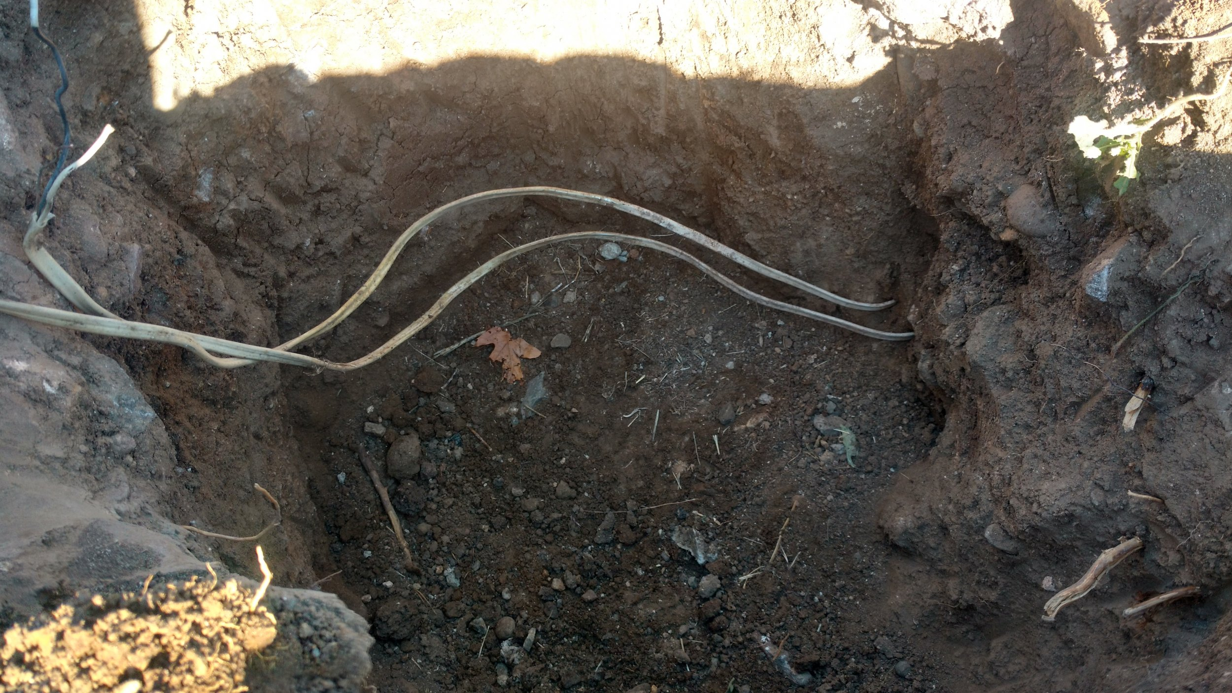

We have a light on a pole in our driveway. Its in a center circle bordered by pavers. I want to replace the light with a water feature.
I turned power off, removed the light and pole, and found two romex lines. One was still hot (don't ask!) They are about 2 feet below current grade, and about 3 feet below what the new grade will be.
I need to move these lines as the new water feature would be sitting right on top of them. I wish they were long enough to get to an electrical box on the edge of the circle, but they are not nearly long enough. And I still need power out there for the new pump.
I know you are not supposed to put romex in conduit. Nor splice wires and have electric junction boxes underground. But I'm stumped on what else to do?
Any ideas?

Now about ROMEX! You cannot use normal romex for burying! It must be a
"buriable" rated romex. Normal ROMEX has a paper seperator. You can see that
just looking at the ends. Buriable ROMEX has a plastic seperator and an
additional outer layer. That is why it costs almost twice the price as normal
ROMEX.
Since you have 2 ckts (circuits) there the initial installer should have used
the PVC conduit. For safety I suggest you rerun it in the PVC conduit. Speaking
of safety, I'm guessing that the following two things are true:
1.) Your wires on both ckts are 12 AWG (12 gauge),
2.) Your runs are over 75 feet,
This means that even though the normal load for 12 AWG is 20 amps, the over 75
feet means you cannot put a load over 16 amps on those wires. If the motor in
the water feature pulls more than 16 amps you will have to rewire, at the breaker
box so that both wires are on the same breaker, which will typically be a 20
amp breaker, allowing you the full 20 amps to that new motor.
This is where you have to get an electrician involved for all motors have 2
amperage ratings, one for startup current and one for working current. The
working current is what has to match or be lower than the breaker on that ckt.
You can get both of you buriable lines into 3/4" conduit, but I would suggest
1-1/4" as the pulls will be so much easier and that will also allow for room
to add other ckts, if needed. When pulling any wire through conduit always add
a follow string, so you can pull any additional ckts you might need in the
future. To find the ckt that is live, use a helper, at the breaker box, and
with you, at the wires end, with a "sniffer", have the helper turn the breakers
off/then on one-by-one, till you find the one that was hot (sniffer will stop
beeping when that breaker is off). These "non-contact" sniffers sell for
$7-$35 at both Home Depot and Lowe's.
You mentioned a box some where in the vicinity of these 2 ckts. If that is fed
by buried PVC and large enough, I would run everything there, but await your
feedback on that!

'Buriable rate Romex' is called UF and has been discussed here, with it having been determined that what the OP has in place is indeed UF.
1-1/4" as the pulls
To what end? OP has already stated they will NOT be making a new run under the driveway and brick work. The wire is good and all he wants to do is use something to protect any splice he has to make. The can be something buried and waterproofed or a simple conduit stub to an above ground box.

When properly done, PVC or CPVC joints are chemically bonded, fused to become one with each other. Two pieces meld together into one. They can't leak. How many millions of miles of PVC water pipe are out there under pressure and not leaking?
Diggin It,
He can use a PVC box with the rubber clamping watertight seals to get this done. These watertight seals come with either a round or oblong seal. The oblong one will match his romex, so it the best for this application!
Cheers!
TBNK
   / Electrical / romex mess #129
Nobody takes the effort to properly glue conduit myself included. 99 percent of the time the ends aren’t sealed so why bother?
   / Electrical / romex mess #130
As 4570 said, it isn't that they leak, it is that the ends are not sealed which allows air movement within the conduit and therefore condensation. PVC buried underground is considered a wet location per the NEC for a very real reason. Water will end up within the conduit. For this exact reason is why romex is not allowed underground in conduit, it is a wet location.
