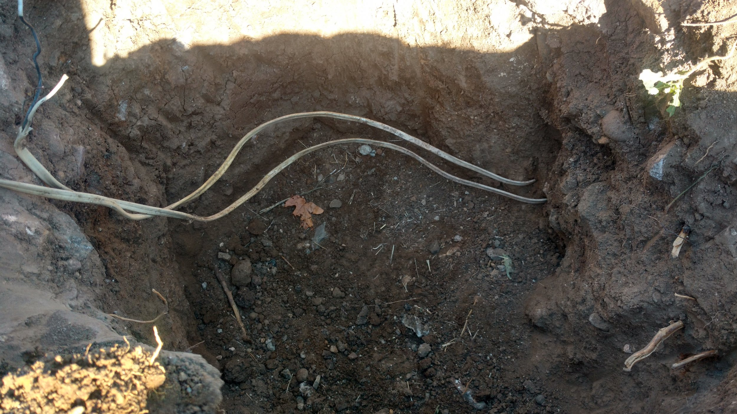

We have a light on a pole in our driveway. Its in a center circle bordered by pavers. I want to replace the light with a water feature.
I turned power off, removed the light and pole, and found two romex lines. One was still hot (don't ask!) They are about 2 feet below current grade, and about 3 feet below what the new grade will be.
I need to move these lines as the new water feature would be sitting right on top of them. I wish they were long enough to get to an electrical box on the edge of the circle, but they are not nearly long enough. And I still need power out there for the new pump.
I know you are not supposed to put romex in conduit. Nor splice wires and have electric junction boxes underground. But I'm stumped on what else to do?
Any ideas?

Both wires feed into the hole from the same direction.
If expose more wire, I will eventually get to the edge of the circle. I could put a concrete electrical box there, and turn the wire upward into it. No splice. Not ideal, but simply using what was original-- and with no splice. Maybe slip a conduit over the part that turns upward before backfill?
One other oddity. Why two wires? Since there was a light out there, I knew of one wire, and it is switched from the house. As far as I know, it is the only remaining wire after I demolished and rewired the entire house two years ago. Why there is a second wire in the hole is a mystery.
I'm going to clean the jacket on the romex and learn what it is.

I checked and there are no markings on the romex. Looks like black #12, white#12, ground in center, no paper. The ground is enveloped in its own plastic sheath just like the other leads are. (I.e. not "loose" in the center.)
/ Electrical / romex mess #17
If the ground is wrapped, it’s probably uf direct burial wire. But who’s to say for sure. Traditionally UF cable has very heavy insulation that’s hard to cut. But I have seen some out there with thinner outside insulation but still listed uf cable.
