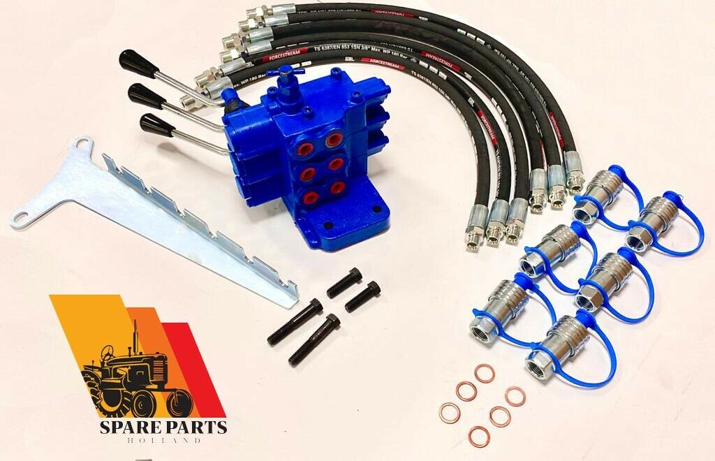

I purchased my 3-valve remote block for the Ford from the eBay guy in the Netherlands. It came complete with hoses, mounting bracket, FM quick couplers and the dust covers. He was quick to ship and the package arrived really quick for being "off shore". I seem to recall it being 10 days or less to my door. But that was before COVID-19 was getting a grip on everything.
The only reason I didn't leave feedback for the seller was he apparently holds YOUR feedback hostage. I don't leave feedback for sellers that don't leave feedback for the buyer when paid. Never. I had a good experience but I just don't.
