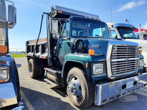

I saw this truck on marketplace the other day with 455 hp and a 10speed transmission. Why can’t you find a single axel dump with that kind of power?
/ Dump Truck recommendation #25
I saw this truck on marketplace the other day with 455 hp and a 10speed transmission. Why can’t you find a single axel dump with that kind of power? View attachment 782786
What are you talking about?
You can order one, but most vocational trucks have low power to keep them going slow down the road and lasting many years on lower power.

Here you go, even in your location.
https://www.machinerytrader.com/listing/for-sale/214909481/1994-ford-ln8000-dump-trucks

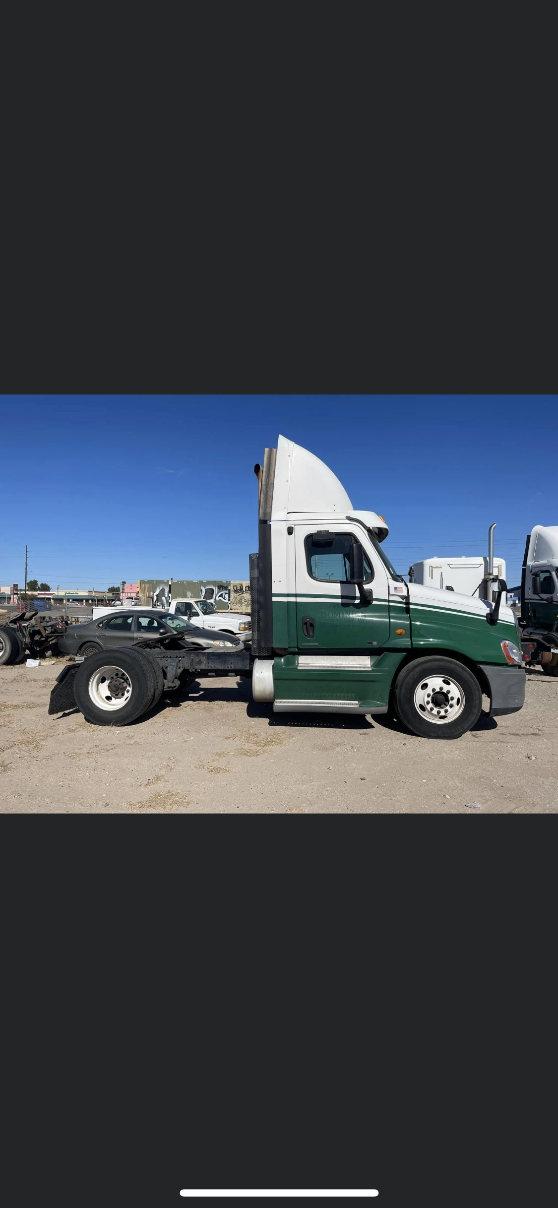

He wants a single axle dump with big power, like the single axle tractor in the picture.
I know a few guys who run 400HP single axle road tractors converted to dumps. Still can’t load bed with much and tow at same time. Suck down a lot of fuel, too. Most can only handle a 9’ bed.
That Old Dominion truck has seen a lot of miles and backfires in the driver seat, too lol

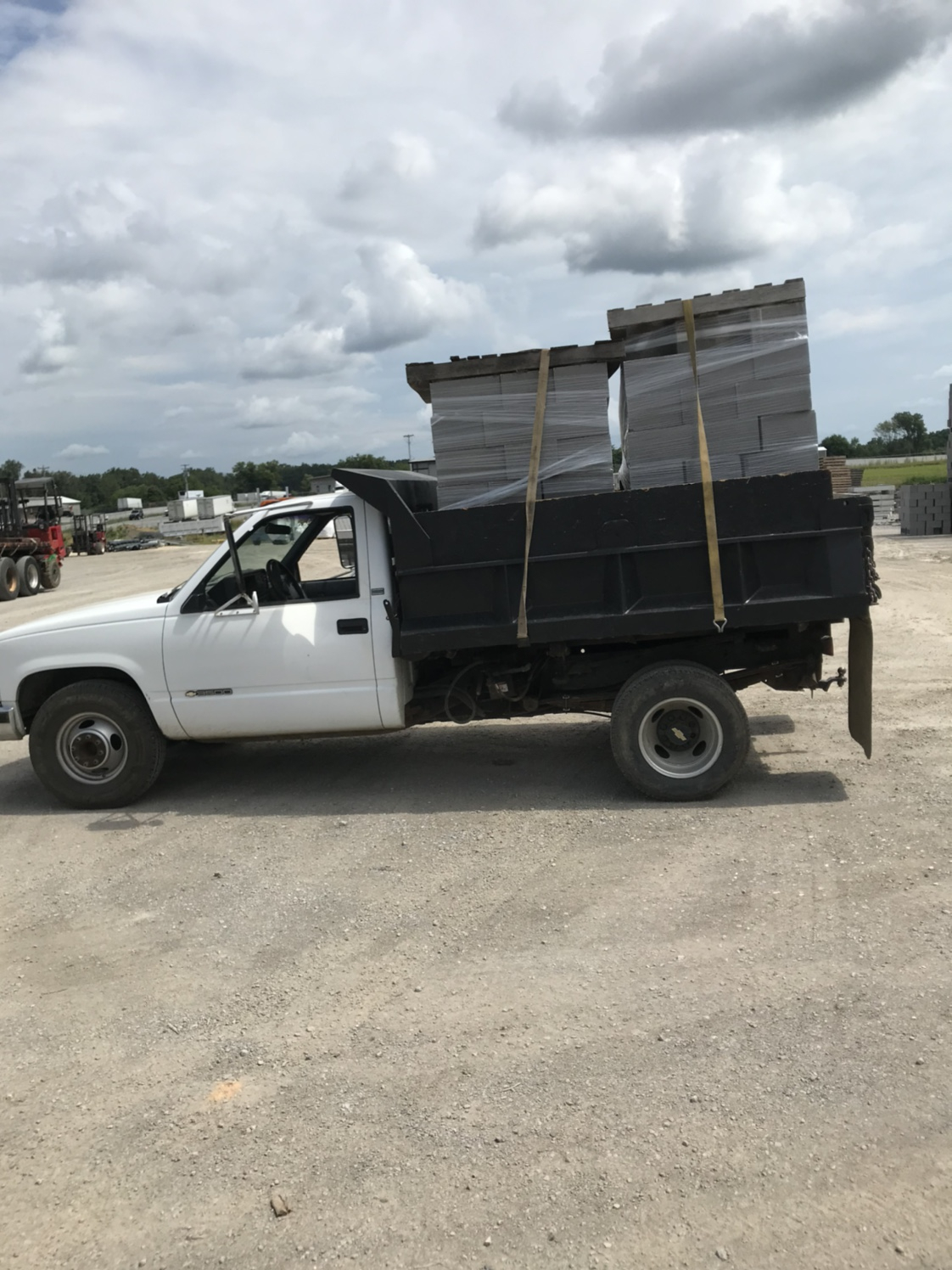

You are only about 4k over gvw, my kinda load:) The 3500HD's of that era were good, heavy duty trucks. Better than the early Ford Super Duty's.
That’s a regular 3500 not a 3500hd. If it was an hd it wouldn’t be overloaded.
