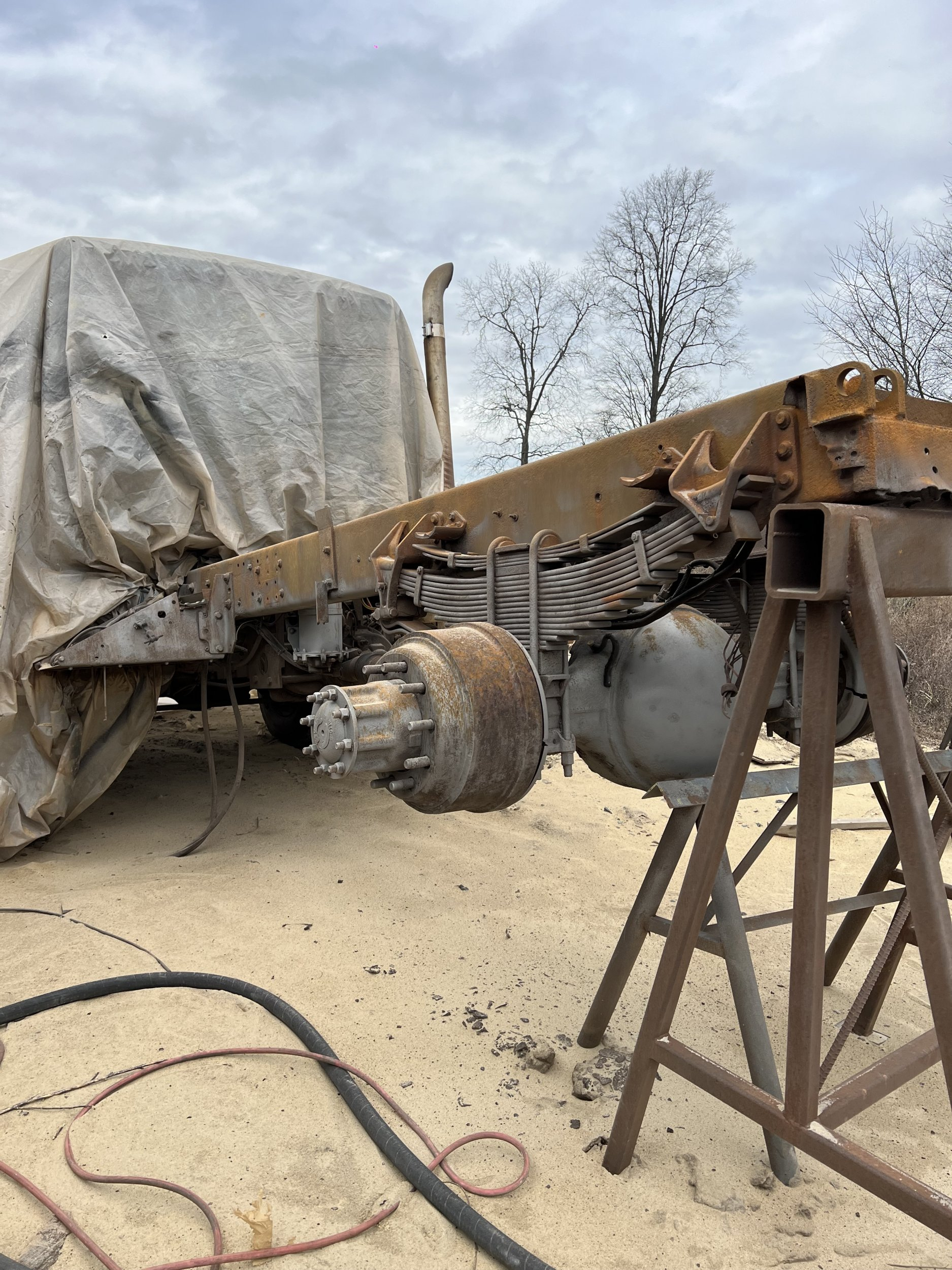

Im knee deep in a dump truck restoration.
