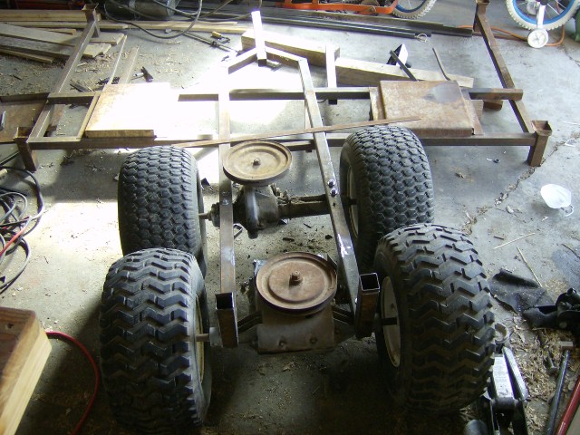

Thanks for all the responses. Keep them coming. I'm finding my life filling up with other things, and I need to keep motivated to get through this project. I am having a blast building this. It's the first project of this type and magnitude that I've built. It's challenging me, but it sure is fun.
I'm glad I'm posting here too. If nothing else I feel motivated to spend at least a little time whenever I can because I owe it to the forum to show some progress.
Tonight I cut out one set of "stake pockets". It took me about two hours to cut 11 three inch sections of 2" tubing with 1/8" wall. I'll need to cut out another set of 11 to ring the top of the side rails.
Milwaukee sent me an "Ice Edge" sawzall blade in the mail the other day. It cuts like a hot knife through butter, but I got a little carried away early on today and dulled it. Now it cuts like a butter knife through steak. I cut out the second half of the sections with my trusty angle grinder and a skinny wheel.
I looked this past weekend for some more of this blade, but Lowes said that it was a new blade and they wouldn't have any in for 6 months or so. I think that's bogus and someone was just due for a coffee break. I see that Amazon has them. I'd rather not wait for them to ship. I'll probably go to my local hardware store that never fails me and look for them there. If they don't have any, I'll order them from Amazon.com

I'm back to fabrication now. I went to my local hardware store, and though they didn't have a Milwaukee 'Ice Edge" blade, they did have another brand of demolition blade. It wasn't quite as good as that ice edge blade, but it worked faster than waiting for shipping from Amazon.com.
I got the pockets all cut out. There are 22 in all. I've attached pictures of the stakes set loosely in place to give an idea how this whole thing is going to look. The stake pockets are just tacked on for now until I get the frames of the bed sides all fabbed up. I already had to take the first two off. I forgot that I was going to drill a 1/4" hole in each pocket to allow for bolting the sides to the base. It was a whole lot easier to just break the tack welds and drill them on my drill press rather than try to drill them in place.

I got the side frames welded today.
