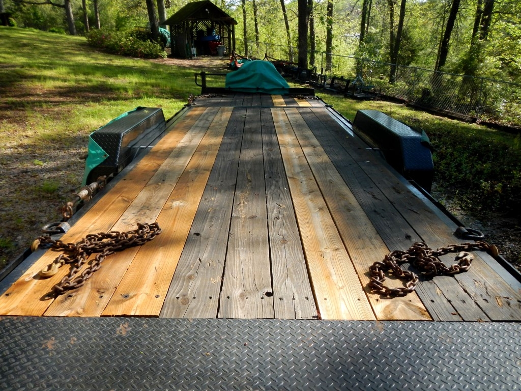

/ Re-decking Gooseneck Trailer #14
My 24 foot tilt bed had boards rotting. I needed 2x8x18 foot treated boards. I guess you can order from Lowes but I found a really good lumber yard nearby that had the wood. Not all the boards were bad so I got what I needed.
I unscrewed the T-40 torx screws (used a ratchet), and lifted the bad boards out. Then placed the bad boards on top of the new boards and drilled new holes in them using the old boards as templates. New ones went in and the torx screws went into the original holes. I did not want to drill more holes in the trailer cross members. I also greased the torx screws when putting them back in.
And that's my story.

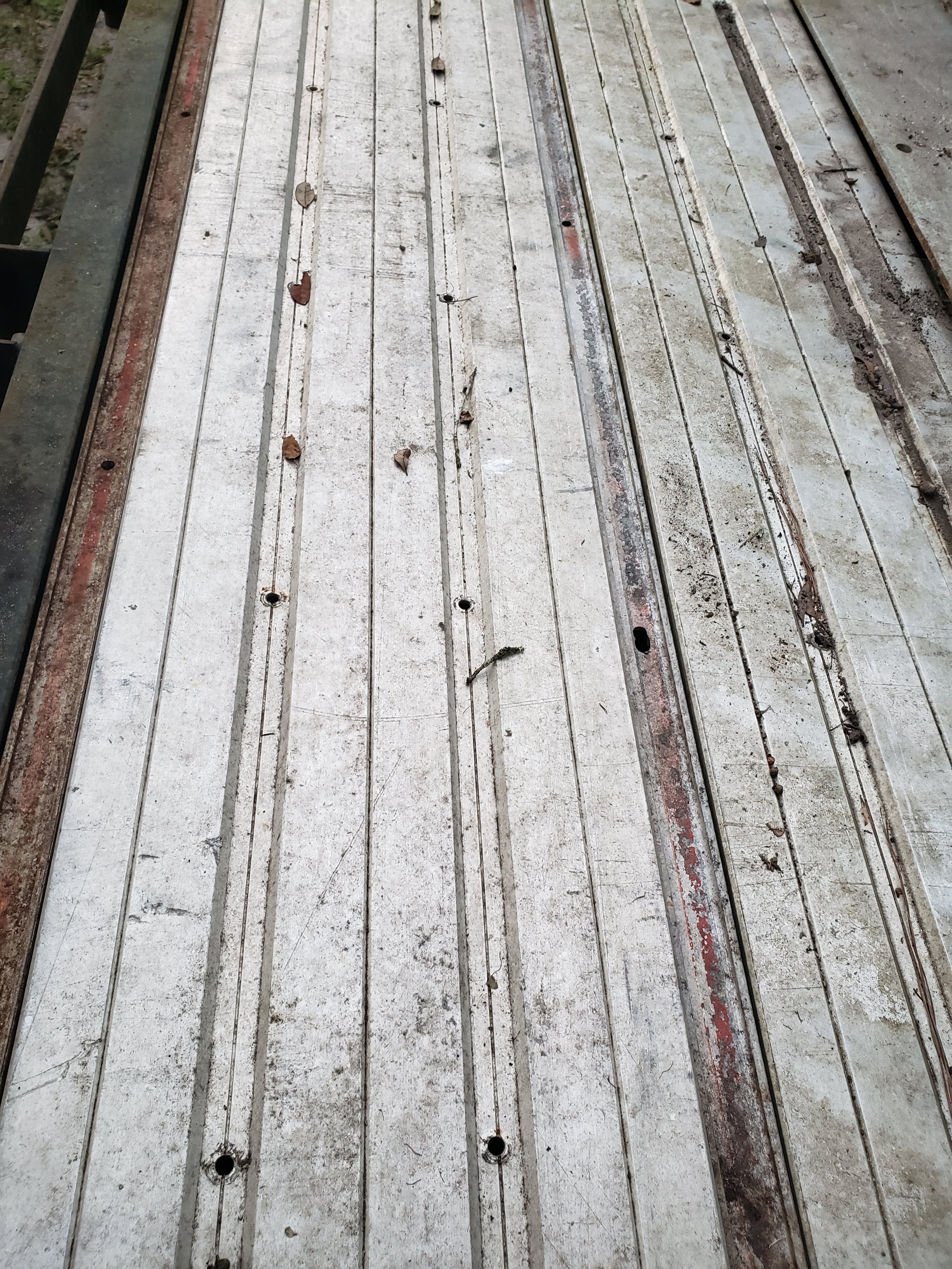

Second replacement of wood gave way under my M7040 when 100 miles from home so I went a different route.
David from jax
/ Re-decking Gooseneck Trailer #19
David from jax
That beats wood decking everytime, probably considerably lighter as well, which is good for trailer capacity.
/ Re-decking Gooseneck Trailer #20
David from jax
What are we looking at there? Looks like aluminum. But what is it? And is it a readily available product? This is a timely post as I need to redeck my 16'er.
