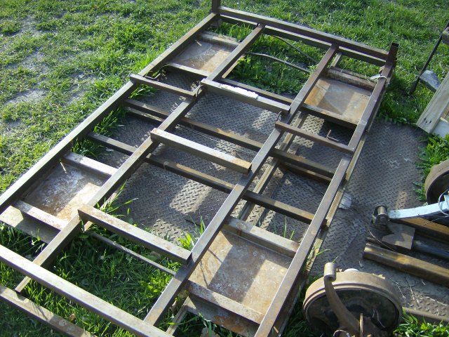

I got in a few minutes last night to work on the trailer...
The first pic is of the bed cross members that I have welded in place. These are what the wooden deck is going to bolt to.
The second picture shows where the battery is going to go. That pan is just set in place for now. I still have to weld it in.

/ Dump Trailer
