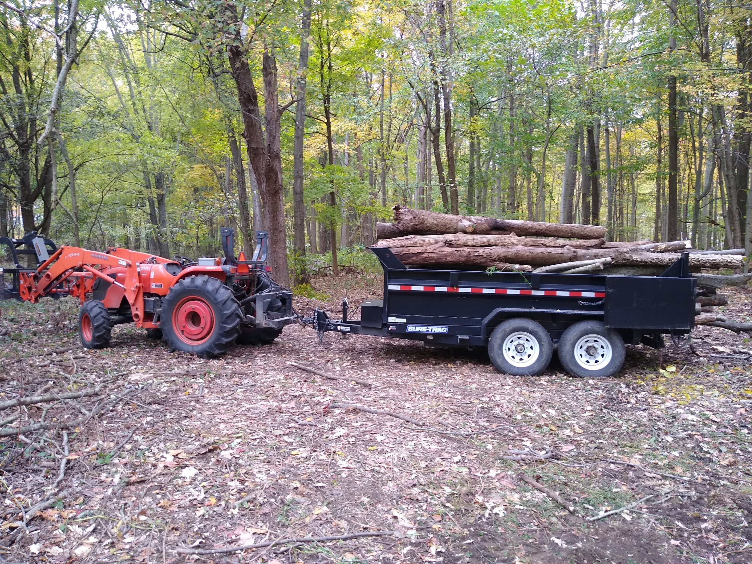

Casual is all I ever need out of the electric part of the dump.
I have quick connects on the hoses at the pump. I disconnect them and plug them into tractor remotes for most of my needs. No need for a gas motor/pump combo when a couple hydraulic hoses to the tractor do the trick nicely.
Hauling logs from the woods, doors stay open. No need to even get off seat. Hit lever and keep driving.
Does your hardwired trailer pump work sufficiently? I had to put duel batteries in mine because one wasn’t doing it sufficiently. My trailer isn’t a daily used piece otherwise I’d set it up to use my truck hydraulics or put a gas motor on it.
Haven't used it yet. And probably won't for another couple of months.

Back in the day i worked in truck and trailer bodybuilding, we allways used an extra battery on the trailer for any hydraulic powerpack for a dump or a tail lift, with a separating relay that didnt allow the truck battery to feed the trailer battery unless the D+ on the truck was excited (meaning alternator is running) meaning the trailer can never drain the truck battery rendering it unable to start the vehicle to recharge.
The trailer was connected through a direct cable from the battery with an Anderson plug, as used in electric forklifts, because trailer light plugs arent meant to carry this current.
