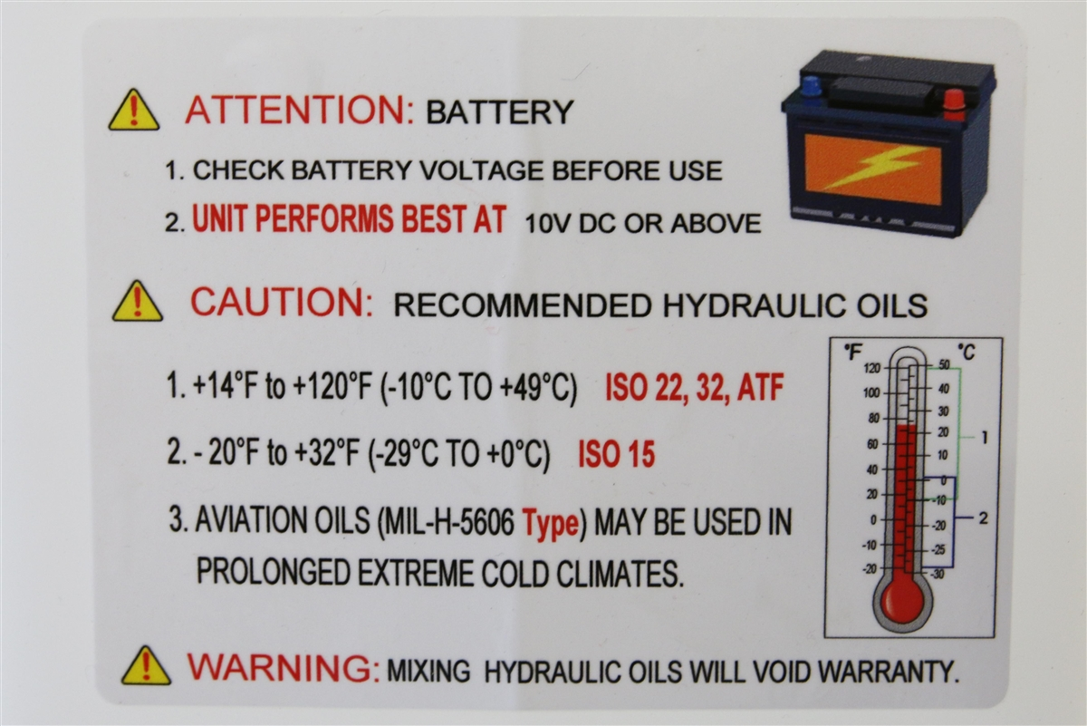

LD1, what do you do about mixing oils/fluids? Most dumps use ATF V/S hydraulic/tractor fluid.
I wouldn’t worry much. I’ve seen in these pumps and plow pumps. Nothing wild. I had a case o matic that worked fine on either atf or hydraulic fluid. Never noticed a difference. My dump trailer has been using hydraulic fluid.
   / Dump Trailer Purchased - now questions #42
   / Dump Trailer Purchased - now questions #43
I dont do anything about it.
The SUDT oil in my tractor is probably bettwer quality than in the dump trailer.
And the couple gallons of whatever it has that mix with my tractor....big deal. not too worried.

If it meets the iso spec run it. Yes mixing can void, but if your like my self you use 1 mfg for your oil products. I usually have iso32 on hand. I buy in large quantities. Yes first time around if you did something like add in hydro lines to your dump you’d want to flush the mfg’s oils and put in your matching.
