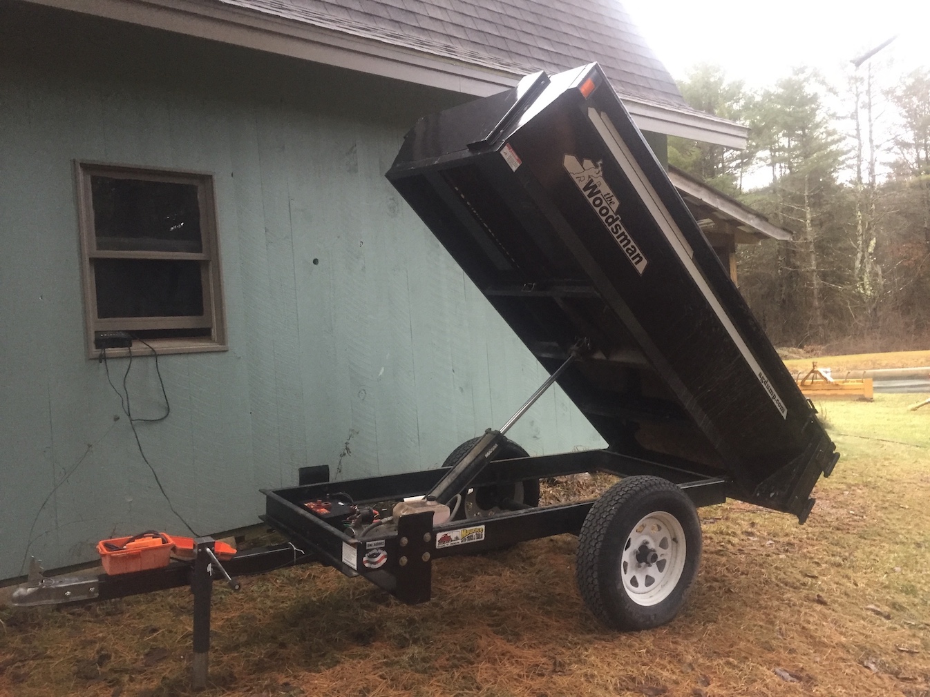

I have an old CAM Woodsman dump trailer that is 4'x8'. I got it mainly for us behind my tractor in the woods. It's great for that: since the wheels are tucked in under the sides the narrow profile makes it easy to maneuver down the trails in my woods. It's got a 3500# axle, but no brakes and no suspension (the axle is just bolted right to the frame).
I've been wondering about adding electric brakes to it and possibly adding some sort of suspension. I do occasionally take it out on the road to grab a yard of stone, topsoil or firewood. That's where the lack of a suspension is really noticeable. The brakes would just be a bit of a safety feature, especially coming down some of our hills when hauling a load of stone. How tough/expensive would it be to do something like this? Am I better off adding brakes and suspension to what is there, or just putting a whole new axle under the trailer that already includes brakes and suspension?

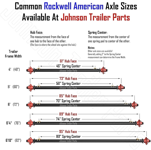

That would be the first hurtle. That could be a tough search. Here's some common sizes below. Also be aware that increasing the axle rating may lead to new trailer wheels and tires too.
No association. I just found the image on Amazon.
