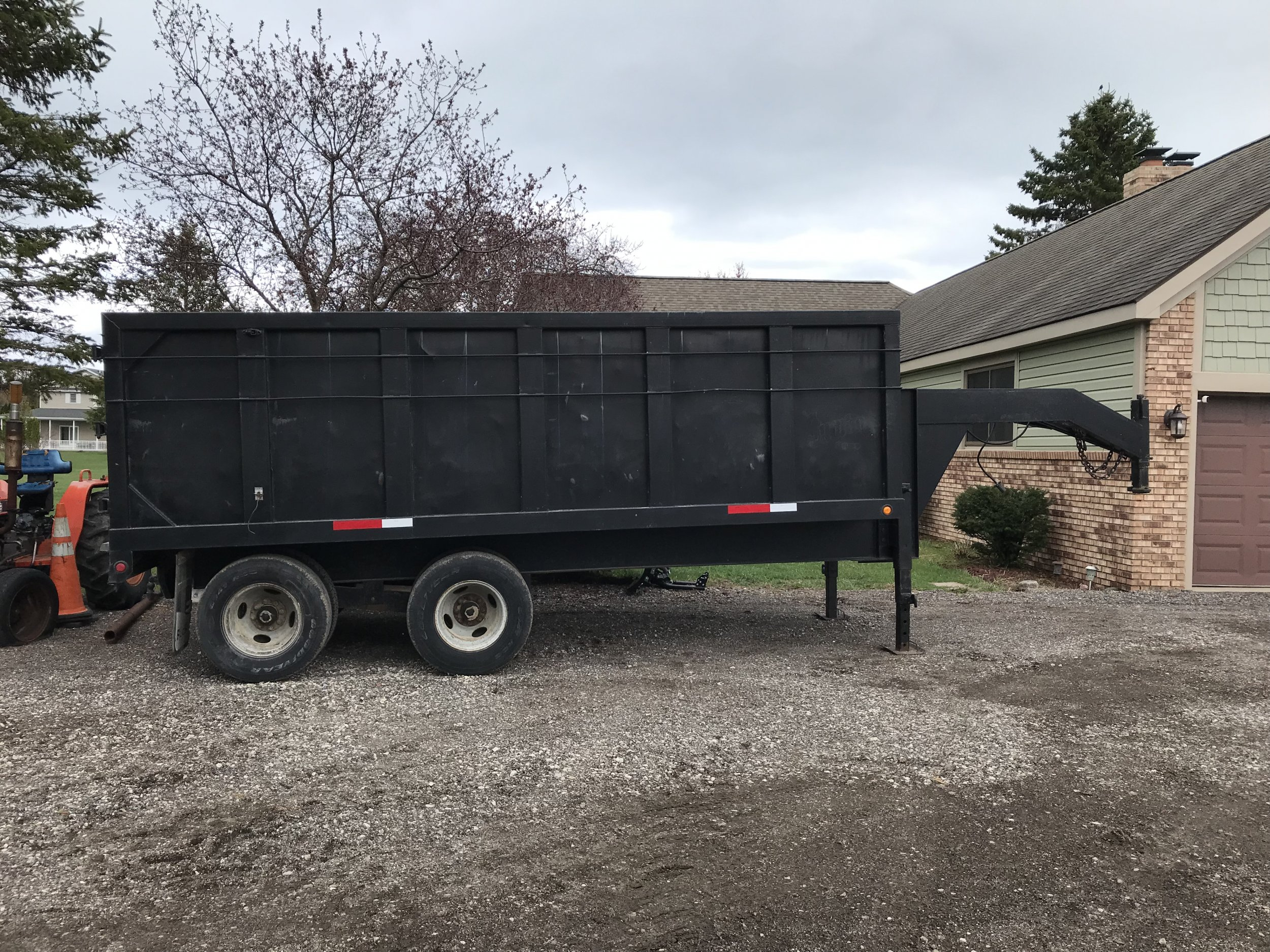

Well I got lucky ish. My cousins husband and I were talking over Easter feast. I was ready to pull the trigger on a new tandem 10k axle gooseneck dump. He says I got one. Has anyone had one of these older big Tex trailers ? It’s got tandem dual 10ks 8x16 ‘ box. Added a tarp and doing new brakes in the rear then putting it into service. Anyone built custom ramps for a setup like this ?

Those duel tandem dump trailers are expensive. It’s probably worth 15k. It also probably weighs 6500 pounds empty. Unless you legitimately need that trailer you’re probably better off with the smaller one.

Purchased for 8k. I want to be able to haul around 5 yards and not be overloaded on the trailer. It’s for sure over kill but for the price I can’t justify a new one.

And weighs in at 7140. My flatbed goose is 6300 so not much more. Tows beautiful behind my flatbed.

I’ve kinda been looking for a bigger dump trailer for a dumpster and I’d prefer longer than that but I’d jump on that for 8k. A deckover trailer will be a challenge to build loading ramps for though.

That has the signature 48” Big Tex “spread axle”. You got a good deal!

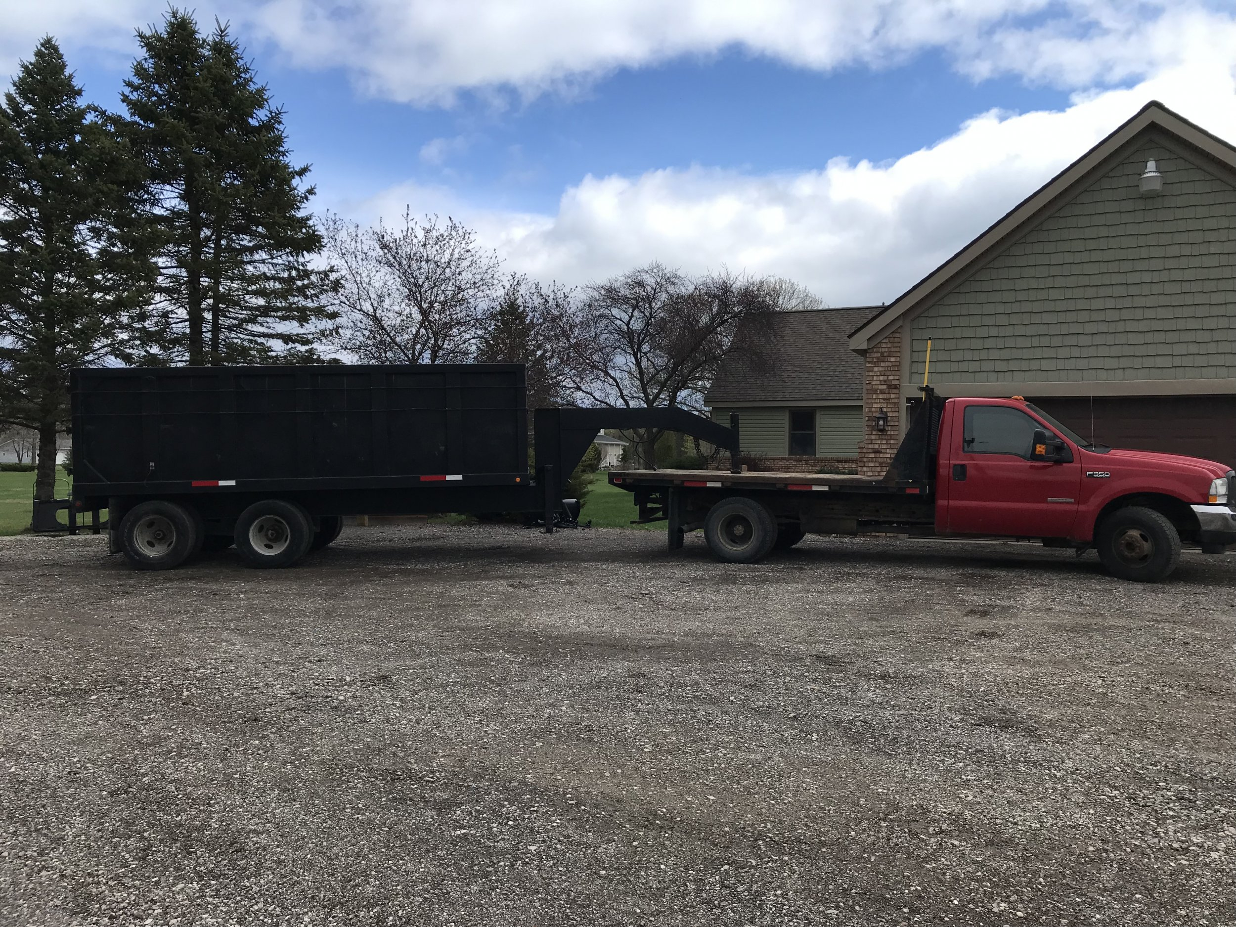

Yeah I couldn’t pass this up. Both of my trailers are the same tire and axle setup. If it wasn’t for our fantastic gentle parcel shipping I’d have it on the road today. But who would have thought you could toss brake assemblies in a box with zero packing and they might get damaged.

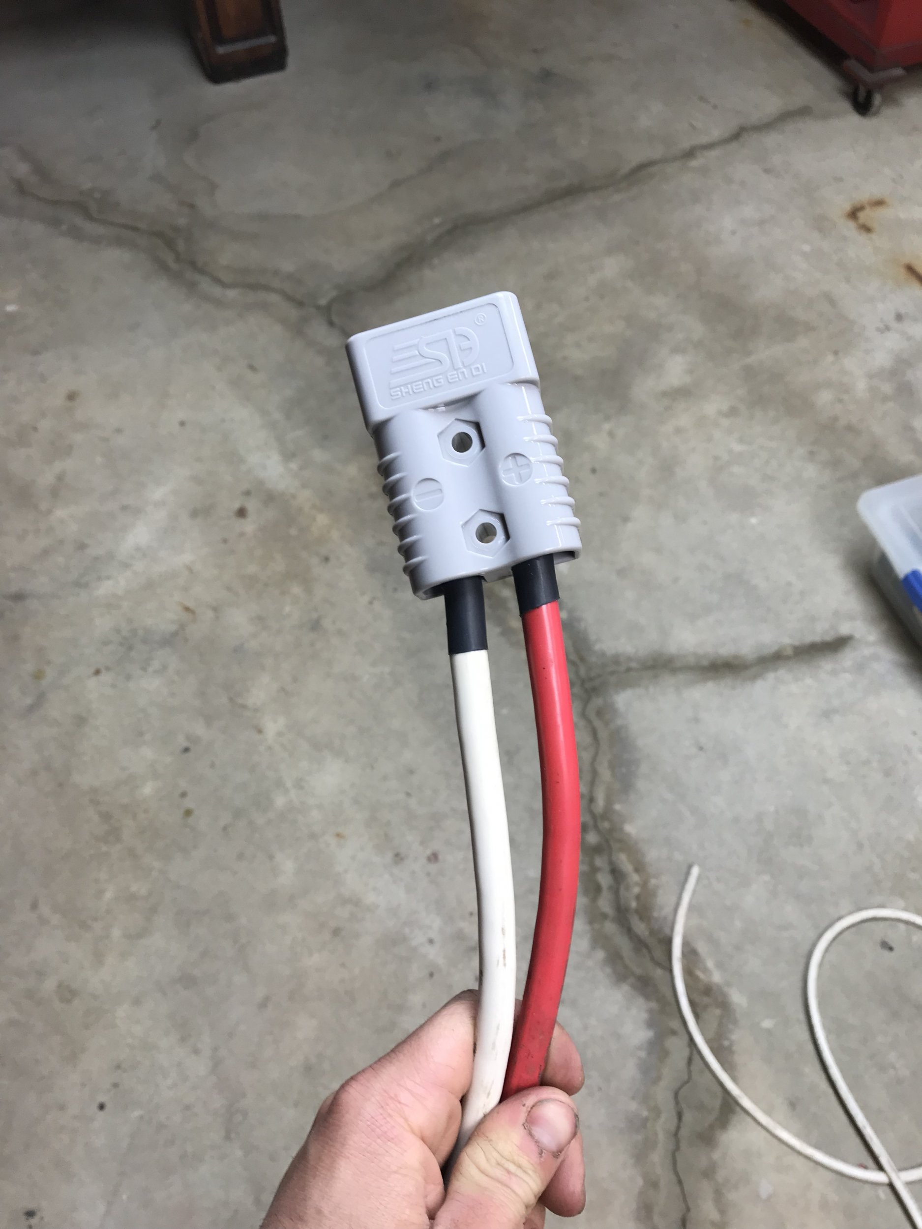

Oh well I’ll take the rain day while I wait for my missing parts. Tarps welded on. 1 hub left to assemble. Made a power cord with sb175 “Anderson” connectors. Running a plug out the rear of my truck so I’ll never have to worry about a dead battery when dumping. I’ll probably make my own electric Jack motor as well .

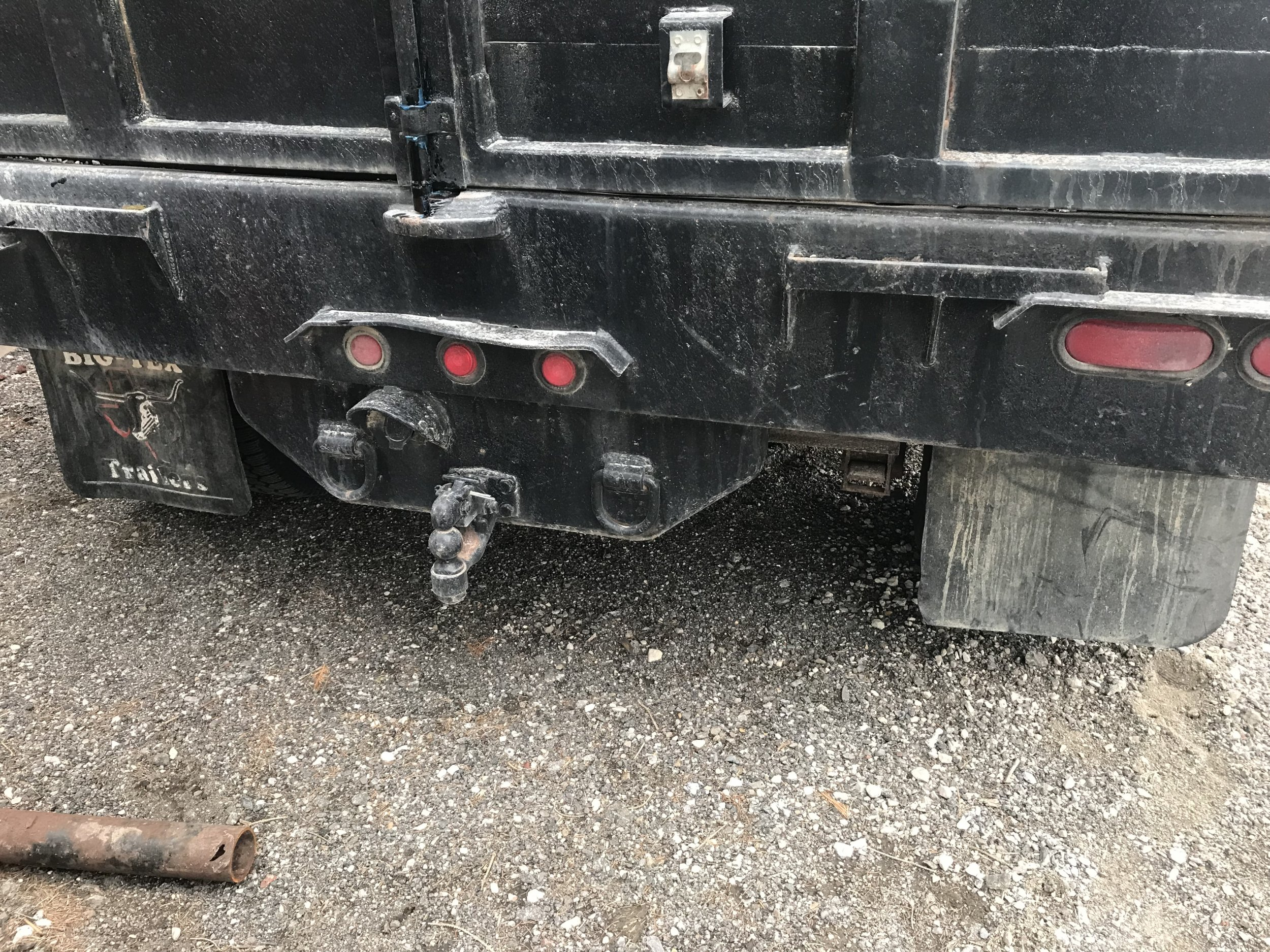

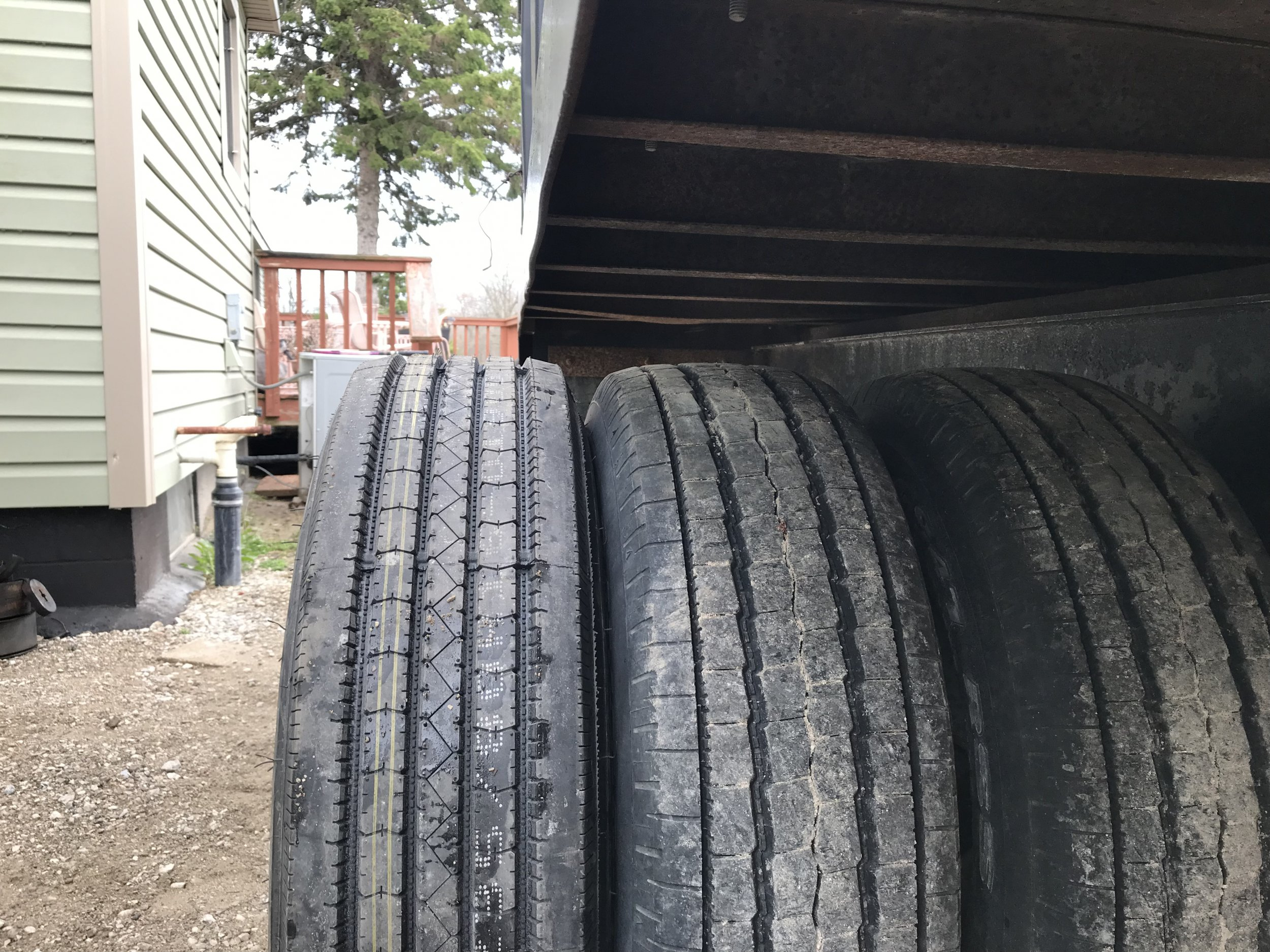

I wanted a heavy spec dump trailer , not this heavy but it will certainly do and cost wise made the smart decision. I almost bought it just for the tires to swap onto my other trailer. They are load range G 14 ply commercial tires. I wanted a 16’ no less or longer to weasel into tight residential stuff. I was curious how the tandems would pivot on such a short trailer but with the commercial tires the tires actually skid and not fold. Matched up a new spare for it. Also setup to pull doubles.

I used to have a somewhat similar Bri-Mar. I bought the Bri-Mar used in 2008 for 7200 and sold it around 2012 for 7000, so yes, you did well. I had thought about ramps but never got around to it. Due to the length, you might want to have some support under the center and maybe a means to tie the ramps together to further stabilize them.

Nice trailer, might be cheaper and easier to to buy a et of ramps. aluminum so you can move them, probably 8’+ to get a decent load angle for the skid steer.

I have a 12’ flatbed cab and chassis I tow with currently. The GN ball is actually about 1’ behind the center of rear axle. Still well between the rear spring mounts and hangers. It rides really nice it’s only 2wd but I have to be cautious at some sites. But dually trucks odly do well off road.
