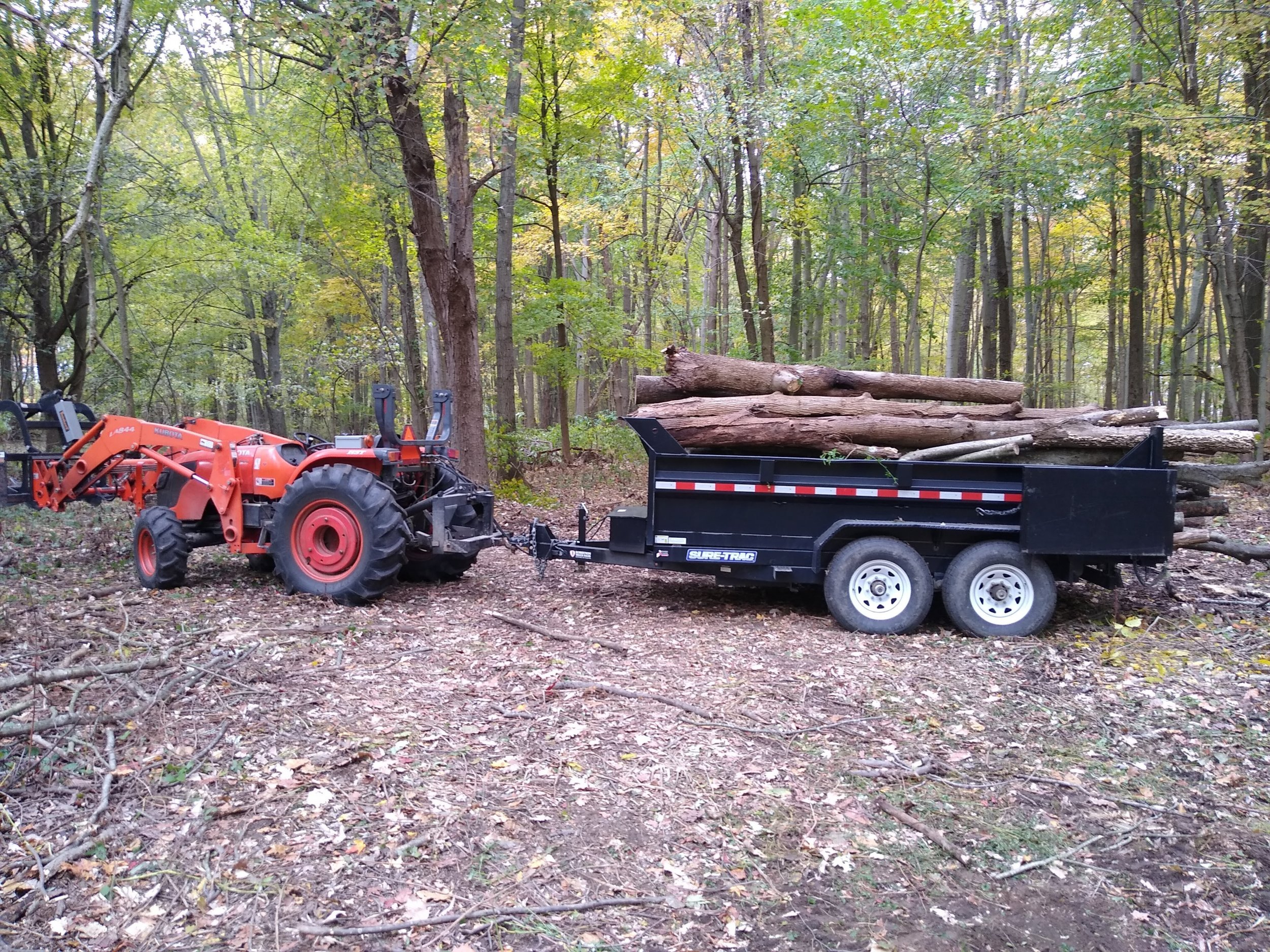

I use the Anderson style connectors on my dump and hydraulic dove tail goose neck trailer batteries as well as my tractors and pick up. This allowed me to create a "modular" system to provide emergency power to any battery that gets weak by plugging the trailer into the tow vehicle. I also keep a set of jumper cables that I made that plugs into any of the connectors.
I do keep the batteries in the trailers, but I also keep a battery maintainer on all of them which greatly enhances their life.
Keeping small batteries in the various electric start small engines I use was killing me, so now I just jump them from one of the tractors in lieu of keeping batteries in them.
I use #2 welding copper wire and it works fine for my application. The longest set I have is about 25 feet.

2ga pure copper welding wire, 24' with an anderson connector out the back of the truck.
Same thing but 8' hooked to the trailer battery.
Plug it in when I hook trailer up is the plan. Havent done it yet.
DOnt use dump trailer behind the truck much. Mainly only to deliver firewood. Everything around my property it gets hooked to the hydraulics on the tractor. So I dont imagine ill have a change to try it for another few months, but I dont anticipate any issues

I have quick connects on the hoses at the pump. I disconnect them and plug them into tractor remotes for most of my needs. No need for a gas motor/pump combo when a couple hydraulic hoses to the tractor do the trick nicely.
Hauling logs from the woods, doors stay open. No need to even get off seat. Hit lever and keep driving.
