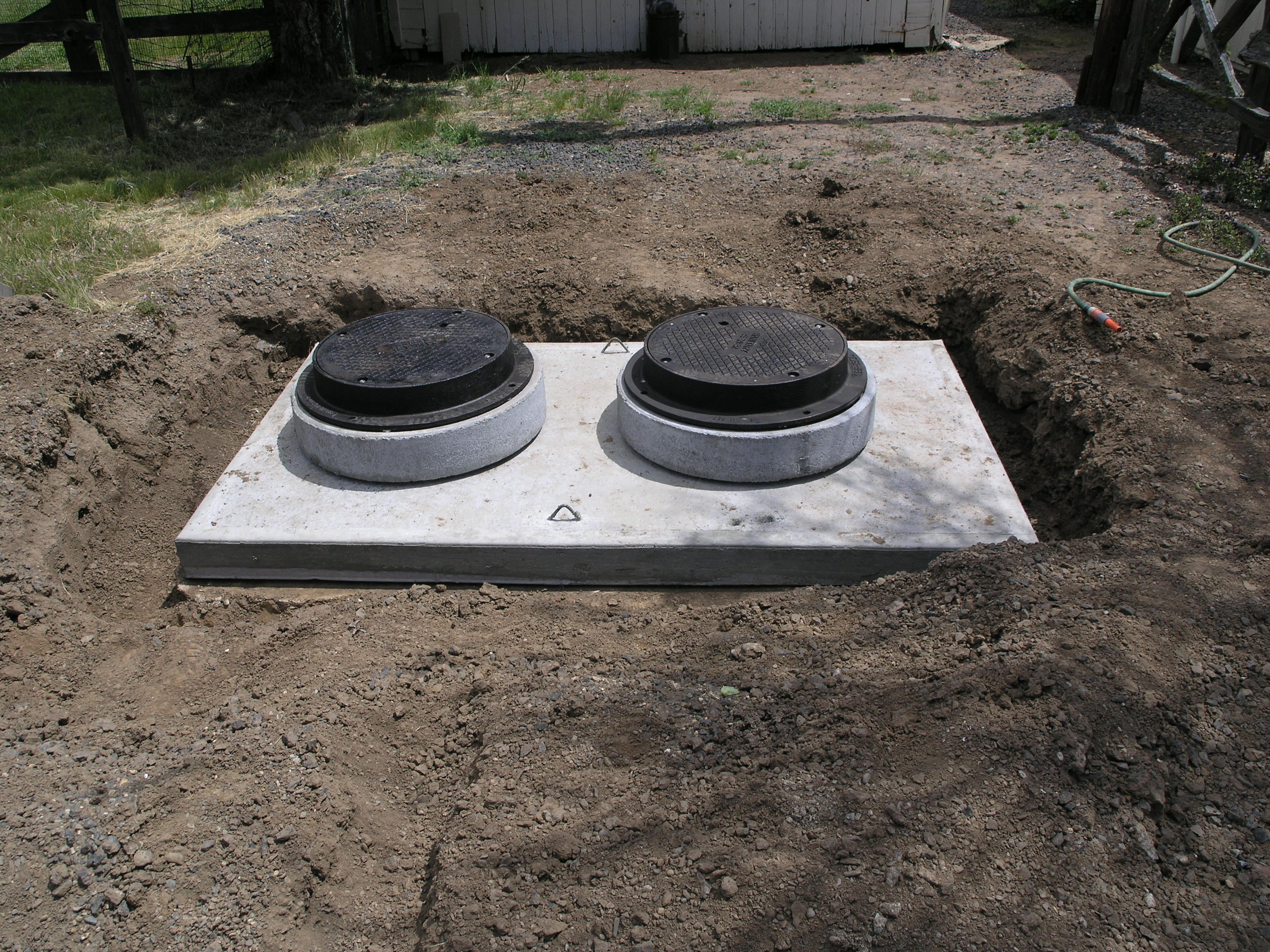

Picture of a tank lid I made on the job.
The new top is very nice. It would unlikely hold a 40HP Tractor or Pickup
They are 3-4' deep in Ontario due to frost. Neighbours tank filled and Froze one year. NOW you have a problem!
Your cover is a Foot or so and offers no real strength or support. Riding lawnmowers should be safe, but more than one person has died from going through the top of a Septic Tank.
I cut plastic Barrels off to cover the 'manways' for pumpouts. Then I only have to dig a foot or so, then pull the barrels (S.S. U bolts) to access the hatches.

Tank covers must be accessible at ground level due to local code. The lid is 6” thick with #6 rebar on 12” centers and # 4 rebar on 6” centers. The tank was existing about 20’ from the garage. They have been driving over it for 20 years. I am a general engineering contractor since 1980. I haven’t done little jobs like that since the mid 80s. That was just helping my neighbor. Oh yes those T fitting outlets are standard code also for at least the last 50 years around here.
/ Driving over a septic tank #79
Ok, so Not taking into account for the dirt on top; the lid as described; Should have a service load of about 1850#/sq ft, or a single point load of about 5900# at the center. Now, yes, using Chat do to the calcs, as i haven't ran beam loads in like 19 years... So, even buried 12" it seems to all into the "probably shouldn't dry over it with propane delivery truck", but you pull a passenger car over it, you are fine, As Long as there are no hidden defects, which can happen on an old lid. Minor curing cracks can allow gasses to attack the steel, and our whole thing changes.
Basically, with 2:1 soil transfers, this lid should still take an 8000# load. With a 1:1 soil transfers to the lid, 5000# single point load starts getting a bit iffy.
Again, goes back to, probably shouldnt, but if its a couple times, and you're that worried, use something to spread point loads
Ok, I miss read that, and ran with #5 bars long ways, and the #4 bars transverse; so I under sold your lid by probably a factor of 3...
