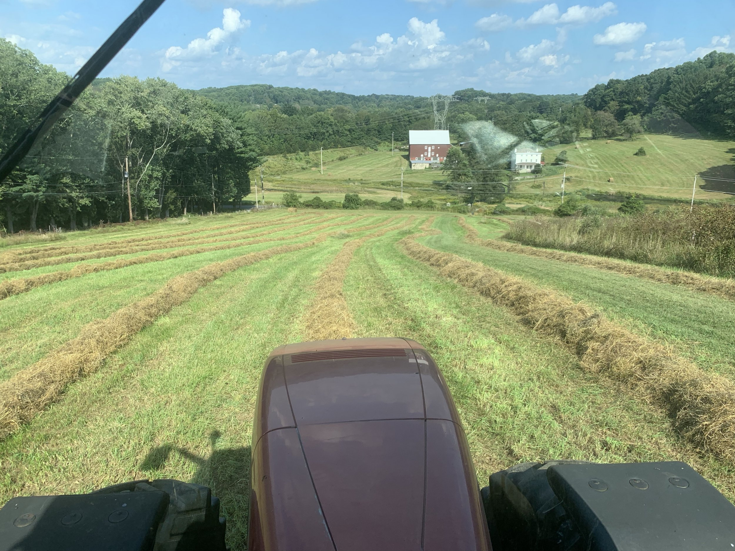

Yeah width visibility is reduced for the operator, but length visibility is improved which is nice for loader work.
My Magnum hood is very long, but doesnt bother me a bit.
My loader tractors are 4 cylinder. Nice visibility
