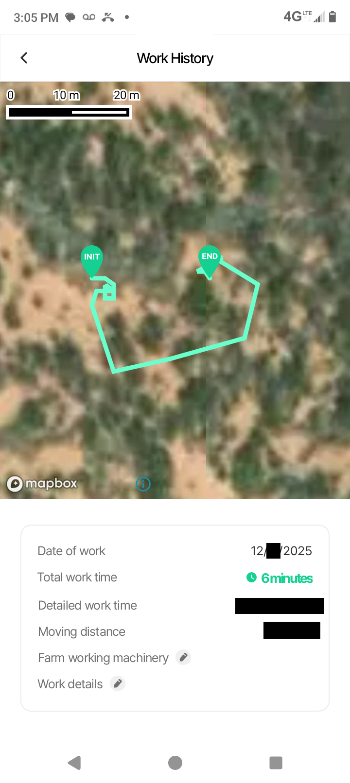

Here's an example. As you know from the 2610, the engine and display is basically fully mechanical and there is no ECU so I don't think there's much the telematics unit can record about the engine. I haven't fully worked out how the app records engine hours yet but time and location is the only thing reported from what I can find.
