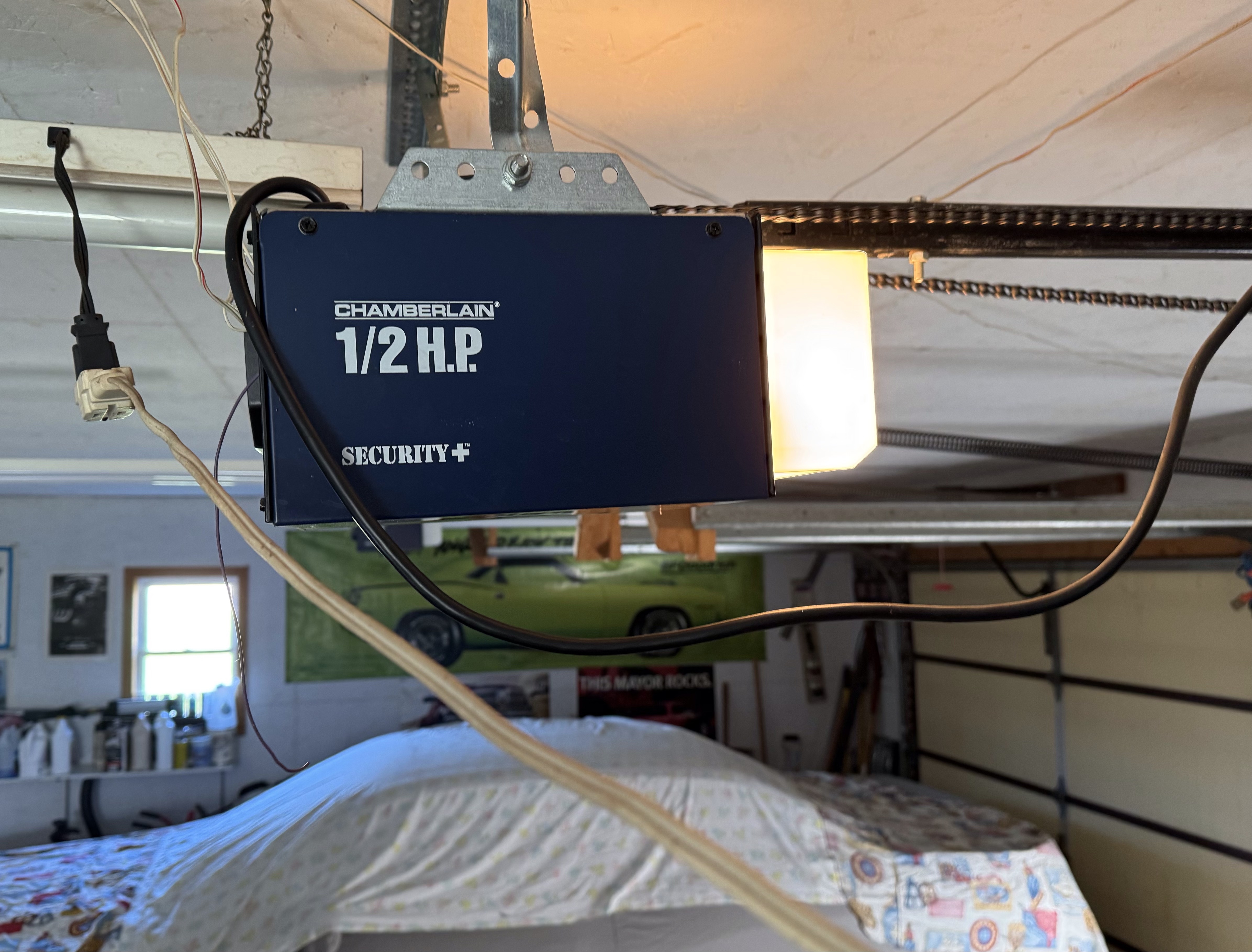

I have a Chamberlain garage door opener, about 15 years old. The problem is getting it to go down with a remote. I have one remote and one car both programmed for it.
It always goes up and down with the button in the garage. It always goes up with the remotes. It will sometimes go down with either the remote or the car but it’s less than 50% of the time. If I try and lower it with a remote and it doesn’t work it will go down with the button in the garage so I do think it’s the safety eyes.
Getting closer with the remote doesn’t help. I reprogrammed the remote and car, that helped for a day. I also read a CFL or LED can interfere with the signal. I have a regular rough service light bulb in it and taking it out doesn’t help.

No that’s not the problem. The problem was diagnosed and the opener replaced.

No, that wasn’t the issue. The real problem was identified after a proper diagnosis, and it turned out that the opener itself was faulty. Once the issue was confirmed, the opener was replaced with a new one, and everything has been working smoothly since then.:cool:
