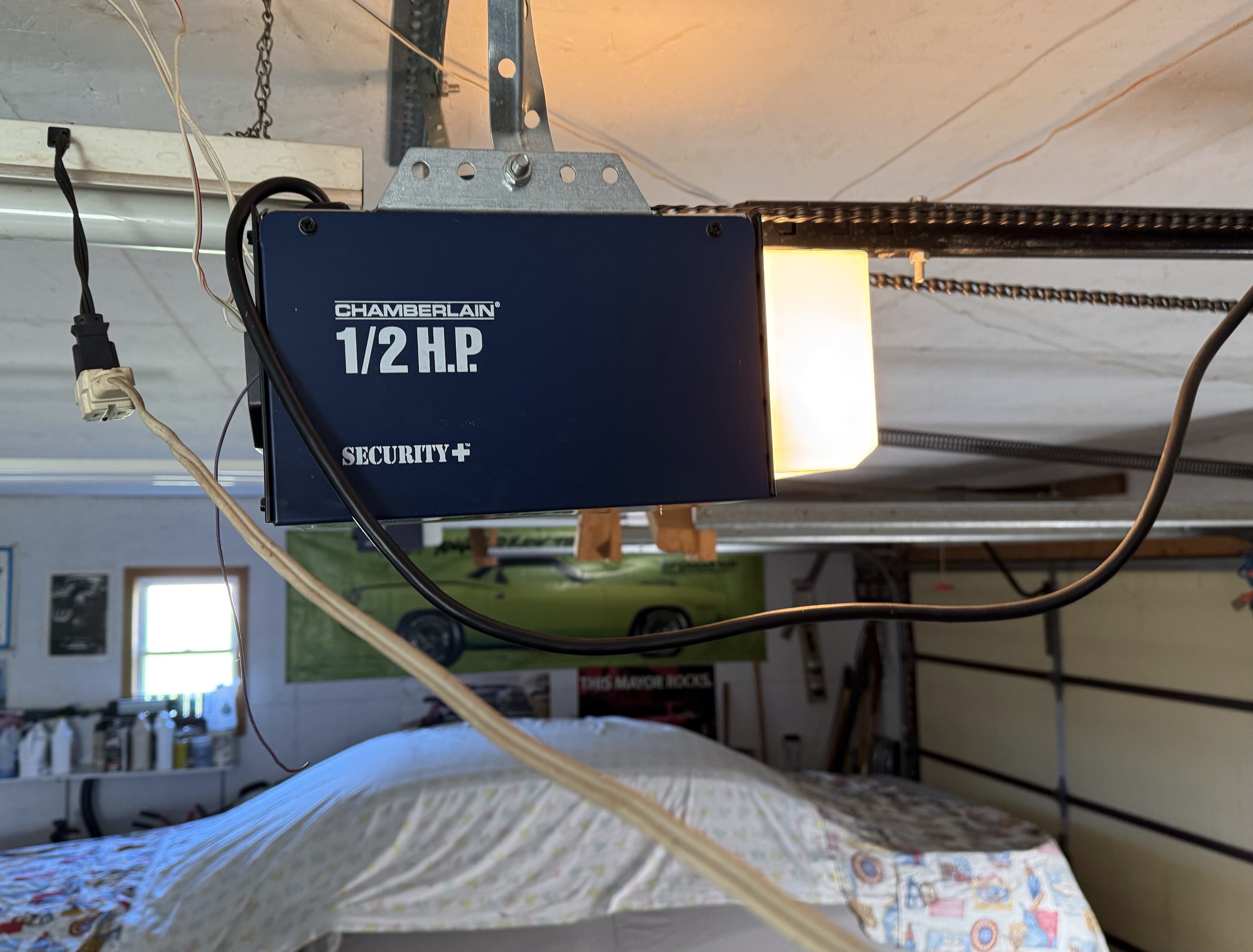

I have a Chamberlain garage door opener, about 15 years old. The problem is getting it to go down with a remote. I have one remote and one car both programmed for it.
It always goes up and down with the button in the garage. It always goes up with the remotes. It will sometimes go down with either the remote or the car but it’s less than 50% of the time. If I try and lower it with a remote and it doesn’t work it will go down with the button in the garage so I do think it’s the safety eyes.
Getting closer with the remote doesn’t help. I reprogrammed the remote and car, that helped for a day. I also read a CFL or LED can interfere with the signal. I have a regular rough service light bulb in it and taking it out doesn’t help.
Any thoughts?

If it was the safety eyes the button on the wall wouldn't work either and the light on the opener would flash to indicate you have a problem. It never hurts to clean and align these eyes but they're not likely to be your problem. Check the antenna on your unit. The remotes need to be able to "see" it. If it's tucked neatly away somewhere or rolled up you may have found your problem.

I did replace the battery in the remote. I just have to press the indoor button for a second for the door to lower.
I did clean the eyes off also but I’m 99% sure they are working. I do need to take a look at the antenna. The car I have programmed sits right below the opener and I’ve brought the remote inside, it still malfunctions most of the time.

Sounds like an issue with the remote itself, or the remote pickup at the opener unit.
Is there a light on the remote that comes on when you push a button?
If so, and the light only comes on for "up", then it's definitely the remote; the "down" button could be dirty.
If no light at all, button could still be dirty but it doesn't rule out the opener's remote circuitry.

That sounds more like the antenna or the circuit that picks up the signal.
Maybe try to unplug and use contact cleaner on it?

The way this works is the wall button basically puts a "short" across the contacts that tells the door to go up or down.
The Remote is a radio signal that tell the circuit board/receiver to put a "short" on the activating circuit.
Since you have tried 2 different remotes (original and the car) and get the same results it is probably the receiver board. Most likely a relay has gone bad for the Down signal.
