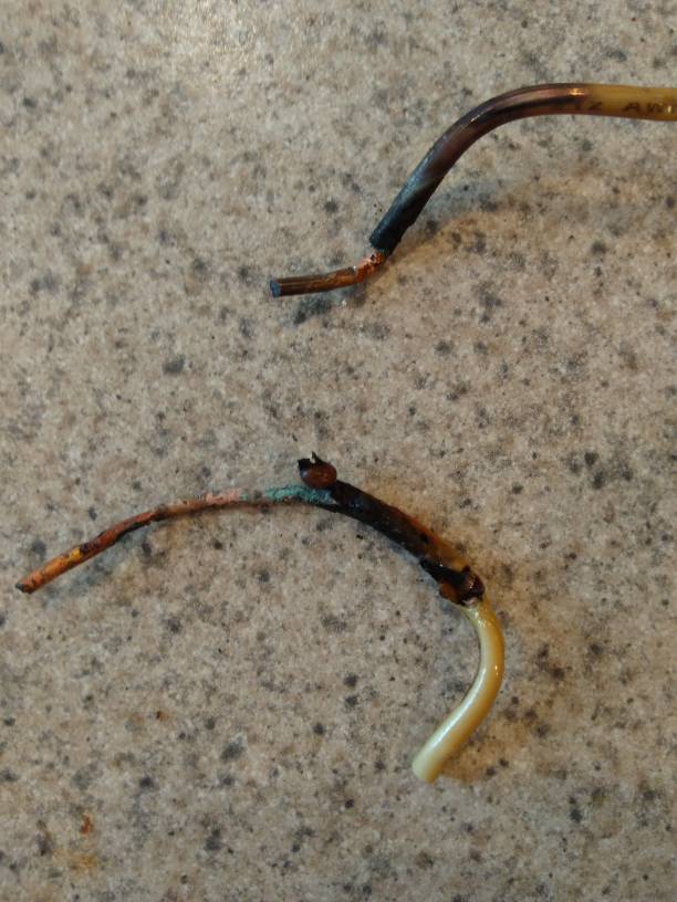

I can tell you as a retired electronic technician 43 years wires, cables can and do fail in bizarre ways. A wire can look perfect, looking at the insulated outside and there can be a problem inside, maybe manufacturing defect, movement, etc.
Most wires we use are stranded. One thing that can and does happen is one strand breaks. Now at that point you have resistance (which equals heat). It's like having a length of 10 gauge wire with a section of 14 gauge then back to 10 gauge.
You don't notice at first but over time just like a weak spot in a water pipe it cascades. Another strand breaks, etc. Finally it breaks altogether, snowball effect and no power.
I've found breaks by securely grabbing both wire ends, pull, it stretches and breaks at the weak point.

The flywheel was perfect when I changed the starter 6 months ago. The truck either clicks or engages and cranks hard. There’s no half way turning over or turning over slow crap. I really doubt it’s bad cables or the truck wouldn’t ever crank hard. Right? The batteries load test good and when the starter does hit it cranks hard so I think the battery’s are good.
You need to put a meter on the small post on the solenoid to see how much voltage the key switch is passing to the starter.
