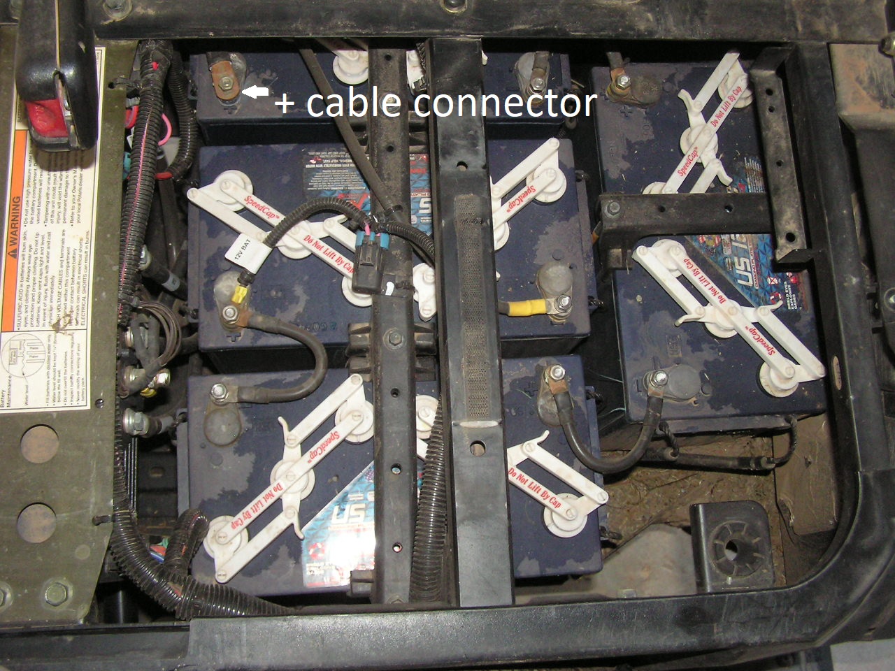

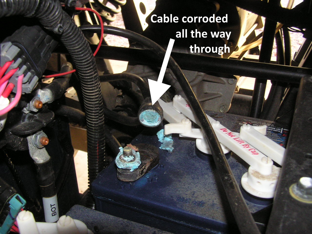

This is the worst that I have seen.
Before:
After:
