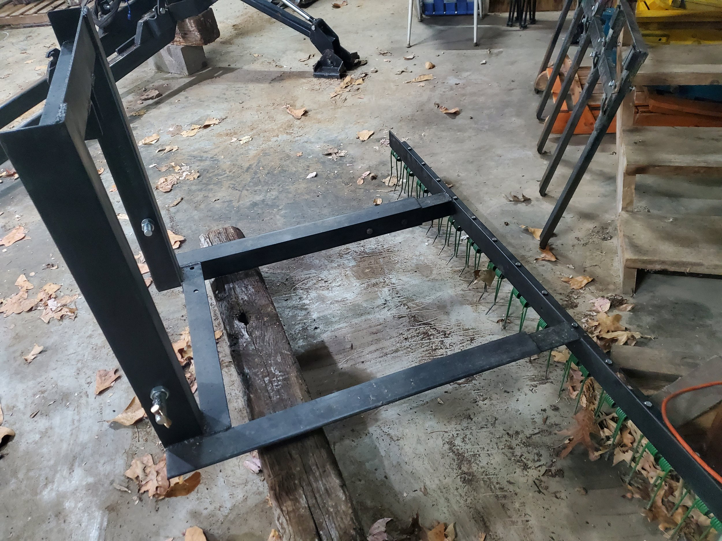

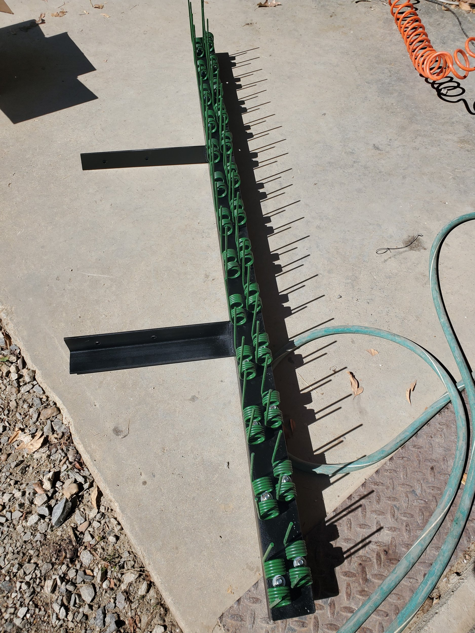

Was browsing for some metal at my local metal recycle place. Found some good size angles.
for $0.30 per pound it was not a brainer.
Ordered some baler teeth online.
The Carry all come out much stronger than the store bought but i actually have no use for it besides attaching the rake.
I built it because all the internet full of "must have attachments".
The leaf rake,,, haven have a chance to really use it. Frankly i think it is useless for my 60 acre property. It works well for a small territory tho
But anyway, wanted to share

Work surprisingly well, I would've expected the teeth to get full of leaves then stop piking them up.
/ DIY Leaf rake and carry all
It is what actually happens. It cleans very well until it doesn't. every 20 yard or so, depending on the amount of leaves, I had to stop, lift 3pnt, drive a couple of feet back to release accumulated leaves and continue. Then with the brush forks i built, i pick up those smaller piles to a larger one. For 1-3 acre it would be real good. I have 60 acres with at least 20-23 which i wanted to clean.
It is why i said that it would work for smaller properties.
But again, since i made it, I've tried it only one time, so no real experience yet.

Update.
Last fall after 10 minutes use i was not impressed with how it worked. Then the winter came and i never got a chance to property evaluate it.
Now come spring and it was the time to give it a try.
After i got a hold how to use it, adjusted the upper arm correctly i was really impressed by its performance.
I tried to clean 4-5 acres of my wooded area off leftover leaves and twigs. I collected it in large piles, then loaded to the trailer using FFL bucket with attached forks and then dumped all of it to my creek. Took me all together less than four hours.
Good thing i let it another chance since my initial thought was to sell it.
