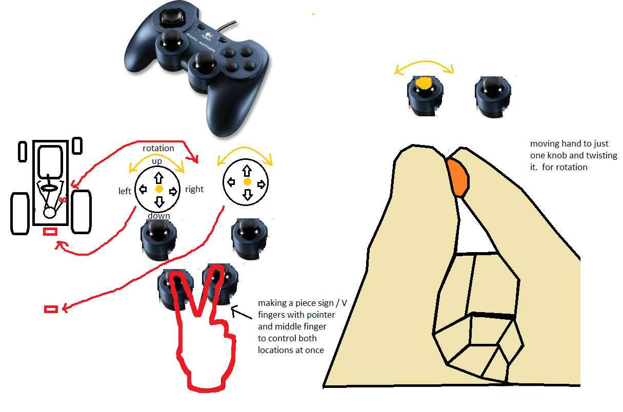

almost there, not much for the servo/motor control, the over all master/slave concept move one, the other one moves.
getting closer, but still not there
https://www.youtube.com/watch?v=V2YWA2xH0oA
vearing off in another direction but getting there
https://www.youtube.com/watch?v=2AJaSAtv0l0#t=44
alright it is a joystick for pc/game but... force feed back control still servo motors.... BUT it is laying down on it's side reflecting out the unit behind the tractor would be seating.
https://www.youtube.com/watch?v=7jkNx1H650c
below picture is from...Novint Falcon

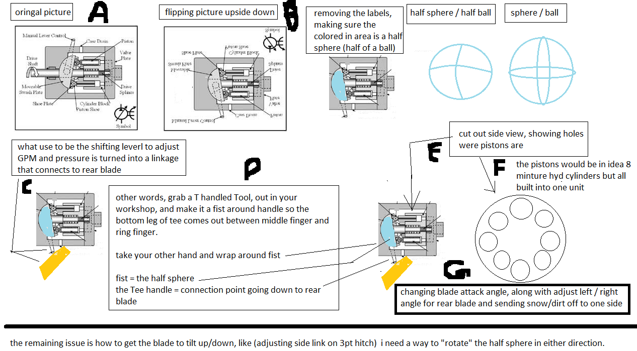

gun, swap out handle for a rear blade, or box blade, rotatory deck, post hole digger gear box possibly auger hanging down. what the heck
back to hunting for the elusive linear sensors / linear encoders in a style that would fit what i want.
though i may side trac some to see about mini hyd cylinders for the joystick, and tossing away idea of electric over hydraulic pr optional valves. and going pure hyd oil.

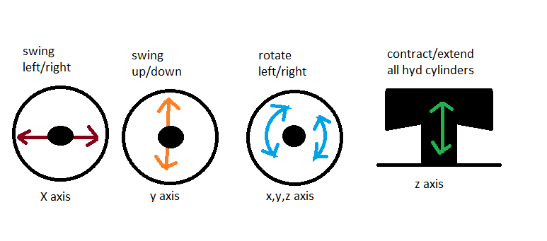

i think i got basic part concepts worked out except electronics...
need to find another 3D program my autodesk inventor license expired. :/ for a mock up setup, before i start forgetting stuff.

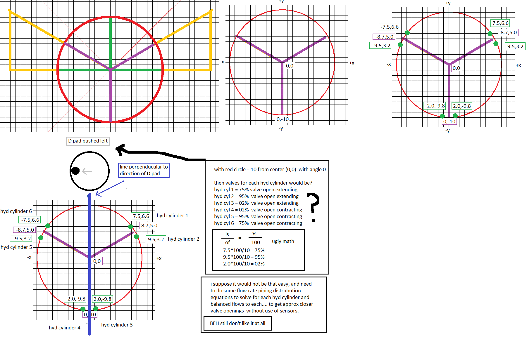

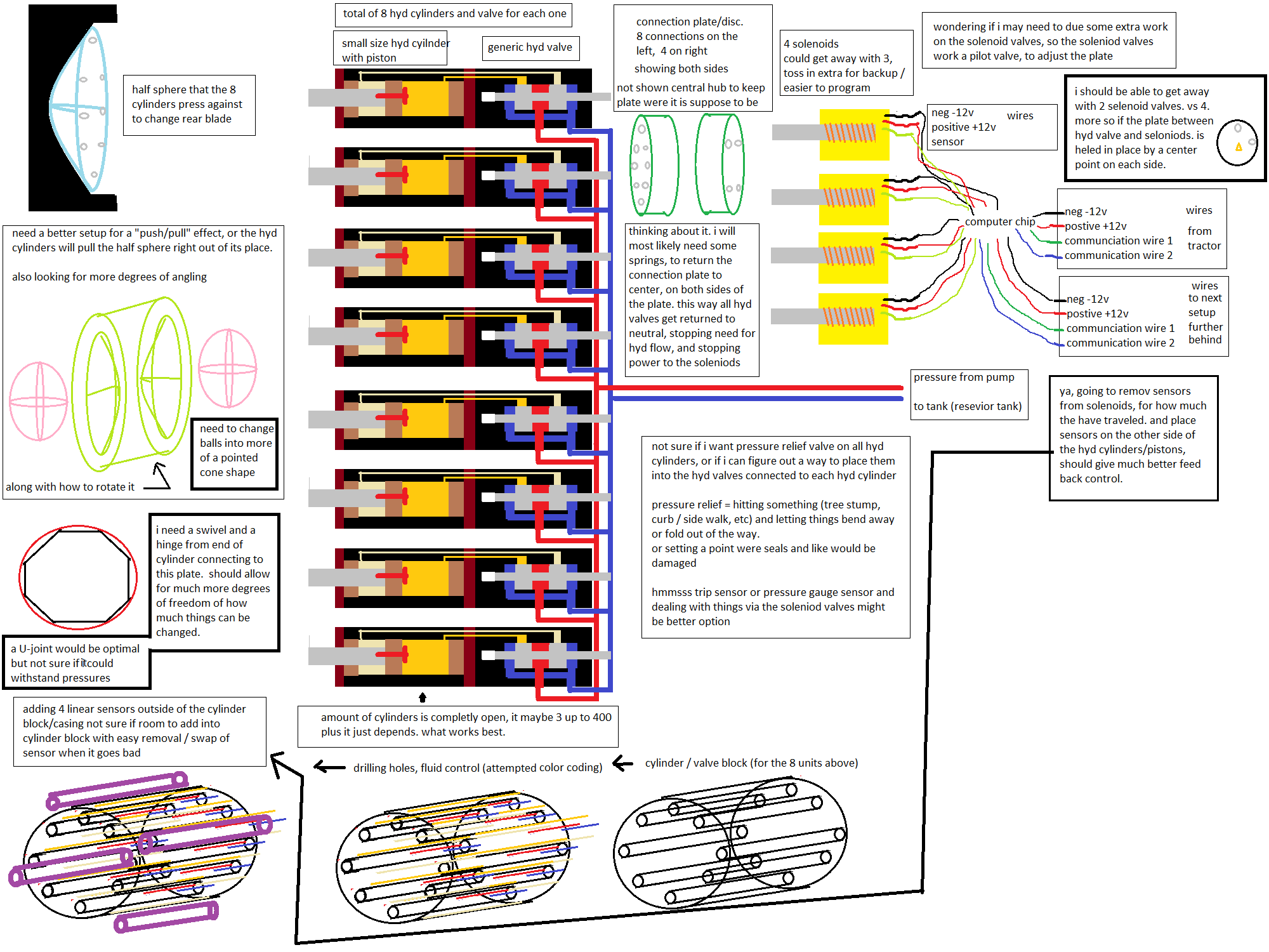

below is older diagram, if brainstorming. trying to figure out how the valves would work....
it took me a while before i realized i could use a "pressure relief valve" and turn what it connects to around. to turn them into "vacuum relief valves" granted it may not be the best idea in the world. but.. what the heck. KISS (keeping it simply stupid)
each hyd cylinder is going to require a bare min of 2 coils (either make it 2 solenoids or 2 D/C motors) to adjust the valves. will most likely chop the 24 coils/valves shown, back down to 12 total coils (2 per each hyd cylinder, then an additional 2 coils per hyd cylinder (one for pressure relief, and one for vacuum relief) to take measurements from. (the pressure and vacuum sensors being for float/trip functionality)
the A,B,C,D,E,F notation of valves. still need to work through, to see if i can combine them and/or redo them to reduce amount of valves.

uploading misc scratch drawings... to see what i have.
actually looking up hyd schematic symbols to draw things out, vs trying to redraw and figure how to run pipes in a 2D / 3D drawings.
getting closer, just not there yet.

some more chicken scratches.
so far things seem to be panning out better for the bottom set of diagrams, as in it will actual last long term, without any funky hiccups, vs other things i have tried
with mounting valve directly on hyd cylinder, i would like to think a higher "shock" pressures could be had/handled. (hoping hyd cylinder doesn't implode / explode) due to putting tractor in full high speed reverse and slamming it into something, or vice verses, and chain up to something, with slack in chain, and going for a running start forward.
the individual valve block themselves would most likely need to be some custom job, with a "curve" vs more of a typical "cubed / straight line" valve block, seen on many tractors for extra rear remotes. the curve should take more advantage of the space, and keep the valves from getting in the way and being squished / mangled.
setup should help keep all the hyd hoses and wires located centrally inside of it in idea, to help keep tree branches, weeds, etc.. from sticking up and pulling the guts out of the dog tail.
my only worry is the hoses/wires that go from the 8 way valve / central computer chip, to piston end of the frame work. some extra length will be needed there to be able to stretch out when all hyd cylinders full extend. and when all hyd cylinders fully contracted, that hose length going to want to curl up, or drop down below the dog tail bottom hyd cylinders and give risk to getting snagged by a tree limb or like.
with 2 pressure sensors, 2 coils, 2 lvdt sensors, i am tempted to put a single little chip at each hyd cylinder/valve combo. to reduce number of wires running between each hyd cylinder/valve combo and central computer chip. vs running a dozen or so wires plus 2 hyd hoses from each hyd cylinder/valve combo. though con's vs pro's to each.

scribbles of figuring out a way to place / mount valves and sensors directly onto the hydraulic cylinder (cylinder portion)
started to type some code up, and the daunting 96 plus wires... approx 16+ wires per hyd cylinder (valves and sensors) not much worth looking at, more of trying to get an idea of things.
i am starting head towards.... "internet of things" type of idea...
==run 2 hyd hoses, and a + and - power cord to each hyd cylinders, and install the valves and sensors, along with a wireless chip, directly on each hyd cylinder. wireless chip being like a chip you might find in a USB/wireless adapter you might buy for a desktop computer.
==then at joystick/s install what amounts to a wireless router (exactly what you might have in your home for internet), to connect to each of the hydraulic cylinders.
i could go with other network protocols along with regular wired network protocols, but with current age of networking for computers, cell phones, etc... and security already built in. (no re-inventing wheel). 16 plus wires coming form each hydraulic cylinder *shakes head no* special end adapters much like "wire harness" adapters/plugs found on nearly every tractor out there. plus cost of wire itself, and connecting the wires to each special wire harness plugs. *shakes head no* i think price would quickly sky rocket. going wireless, would dramatically reduce tracking down a loose or bad wire in 100 plus wires. to only a hand full of wires. and if a hyd cylinder not acting right, being able to narrow it down more directly. getting away from central computer chip that all hyd cylinders use, and if one of the smaller chips go down (on hyd cylinders) more likely cheaper and easier replacement, even for regular folk. a few screws, removing some plugs, and quick easy swap of circuit board/computer chip on each hyd cylinder, or easy to find plug if a valve or sensor plug in.
going with a smaller circuit board and chip at each hyd cylinder, would let a person, order valves/sensors/circuit board, for some DIY project, or addition to some implement, without having to buy a single larger central computer chip, kind of plug&play doing, also gives me a vast more options to choose from, from computer chips already out there on the market. *and the hunt is on!!!*

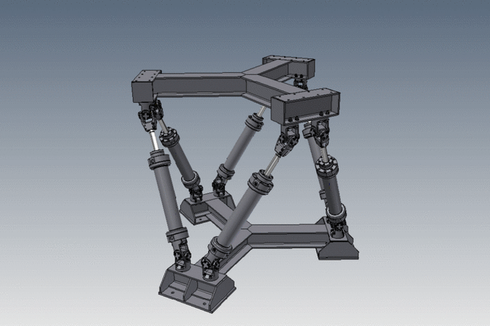

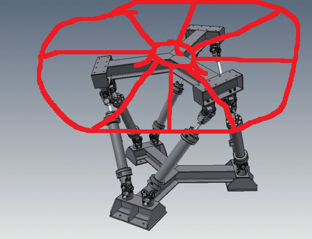

post 15 pictures, show a u-join on both ends of each hyd cylinder. i was planning to put one u-joint on the cylinder end, and then a ball on the piston end. that is all good and all... but, the u-joint. i forgot about how a U-joint actually works, more so when ya bend the U-joint near 90 degrees. the two pieces want to act almost like a 4 toothed gear. if i went to adjust the "stewart platform" aka dog tail. a person could easily rotate and angle things enough to destroy the u-joints. example. moving dog tail off to one side. ((adjusting an off set rear blade, all the way to one side so blade physically seats on the outside of the rear wheels.)) i need to get a U-joint on cylinder end, or it would be very easy for cylinder portion to "twist" and in that pull the hyd hoses and wiring connected to each hyd cylinder. the piston ends (aka ball ends) i am still deciding if i want balls or U-joints. ball ends will not a 90 degree bend like a u-joint, but will allow much easier twisting/rotating/angleing, without stuff binding up. but i would be limited to say a 160 degree cone
getting back on point... it would seem i am going to need to build a full physical model of the dog tail into the computer code. so collision detection can be checked against... collision being, one hyd cylinder hitting into another, to U-joint hang up, to other... and goes further needing to also deal with the physical portion of the remote control as well. other words looking more at a dumb clients, with centralized server setup, with a touch screen table or like being the server. and basic min chips were needed (each remote control, each hyd cylinder) these being dumb clients. just enough to send info of sensors and valves and send/receive data. i am to point i am also edgy of putting in "pressure relief" directly in the dumb client/chips, due to possibility of things binding up, if pressure relief was kicked on. other words, backing up truck and trailer, without any review mirrors, backup camera, or anyone else helping, and never getting out of truck or turning head to be able to look behind ya, ya bound to backup into something fairly quickly. this would be like having pressure relief valve kick in, without knowing any better of what may happen.
so what is out there that could take in for collision detection? most games have some sort of collision coding, so your characters and enemies, etc.. do not walk through walls and like. i would imagine 2D games are no go. along with games based on grids, and mimic a look of 3D. i guess i am looking for a 3D game engine, that can handle direct solids, vs vertices, nerbs, and all the little dots matrices. other words difference between autodesk inventor and solid works vs a good majorty of all other 3D modeling software out there. i guess robot software / simulation software might be something. but real time collision detection vs run and let it go for a few minutes to calculate for only a few instances. will need networking support built into it, that be a big one. i guess i need to take some time searching, but guessing most likely starting from scratch...
