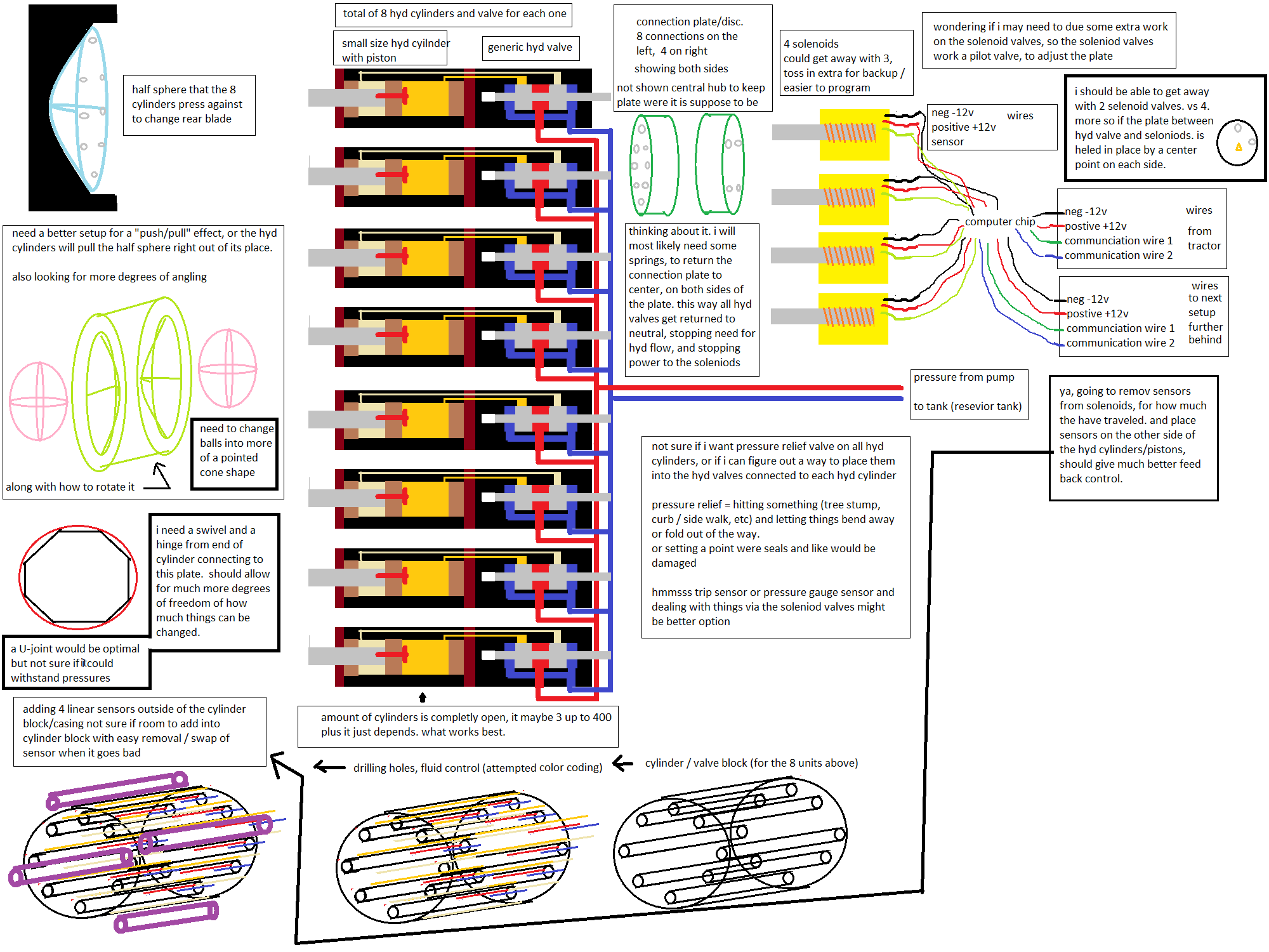

--- if i could buy some hyd cylinders... for just one multi tool. (hyd to raise/lower gauge wheels, angle everything like wanted... i could pull off rear blade for a york rake, and still have all my hyd cylinders to do all the fine tuning on the go. or adjust cultipaker, or disk harrow, or what not... ya it takes a little longer to change things out, but how much extra time would be saved, with the extra hydraulic cylinders that you could adjust everything on the fly? or perhaps some cash saved on basic multi tool without the hyd cylinders.
can i buy some "farm jacks" instead of hyd cylinders to use to adjust things? *ok that is far out there*
adding extra rear remotes to back of tractor....
---can i use a PTO hyd pump or like, and some electrical over hyd valves. on this multi tool, and then run what amounts to a corded remote control box up to the tractor seat? that has some dip switches on it?
--- perhaps only needing a standard rear remote on rear of tractor, with valve lever with detent position or bungie cord valve to on, and setting the extra electronic over hyd valves on the unit itself?

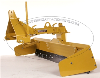

Everything Attachments XTreme Duty 6 way Tractor Scrape Blade
---side wings to turn rear blade into kinda of a box blade,
---offset blade, to toss blade clear out to one side

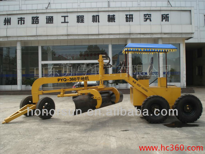

some pictures of old and new motor garders / to pull behind graders
below image is from... http://honorsun.en.alibaba.com/prod...trailer_fixed_on_tractor_or_wheel_loader.html

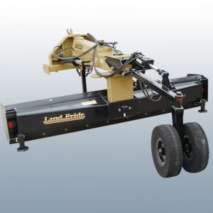

rear blade with possibly extending rear gauge wheel further back?
below image is from... http://www.landpride.com/products/128/rbt60-series-rear-blades

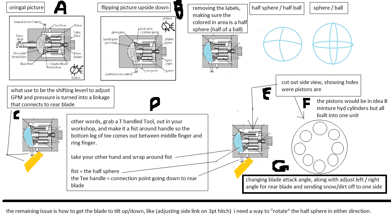

my scratch and dents, drawings trying to figure something out.

how to get multi degrees of rotation and angling of a 3pt hitch rear blade.... from tilting angle left to right so dirt/snow goes off to one side... to tilt up / down to say dig a ditch or put a crown on driveway, to tilting the blade cutting edge itself for different aggressiveness of how much it cut down into the dirt/gravel. along with "offset" option. to swing blade out to one side.
a backhoe (remove bucket, and dipper) and ya have something there. but the boom is rather heavy and long, and doesn't really short up, and lots of extra weight behind the tractor.
i remember looking at various hyd motors, that used internal small size pistons, to convert hyd fluid coming form a pump, into rotation. i think one of them hyd motors might work out nicely, and doing a little bit of change with some ring valve plates, and maybe a worm gear. for final result, of 2 hoses (one pressure from pump, one to return to tank), 3 smallish solenoid valves, or 3 smallish electrical motors. vs 3 to 5 hyd cylinders, and 2 hoses and a valve for each cylinder. hmmsss wonder how much a motor torque / ft lbs a hyd motor creates at each piston, (been a while)

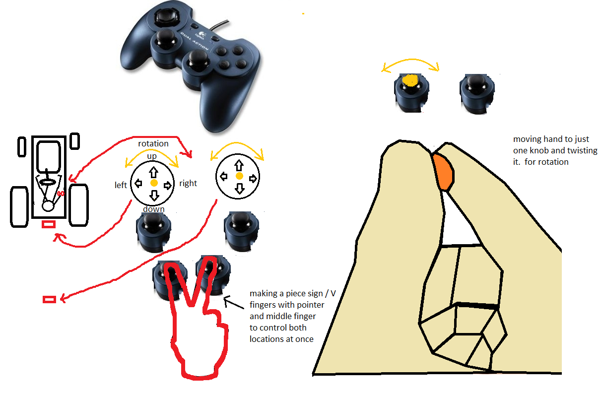

see attach image first...
i have the basics of a hyd axial piston motor already. is there a way to use a clutch? and let things rotate as if it was an actual motor?
the issue is not causing the other axis of angle adjustment get completely out of whack by wanting to rotate the blade up/down (like adjust side link on 3pt hitch) to allow rear blade to put crown on road or dig a ditch.
as much as i would like to have things strong enough (create enough pressure / torque / and like) to use this thing to actually pickup rear end of tractor like a backhoe can. i would most likely settle for raising implement up off ground and rotating it. and then in idea locking the rotation in. to some degree as valves return to neutral position. and keep a hyd cylinder from either extending or contracting. it is that "holding" position thing that has me worried.
side note: thinking of calling it the "dog tail" that has a mind of its own!
/ all in one attachment? is it possible?
#12

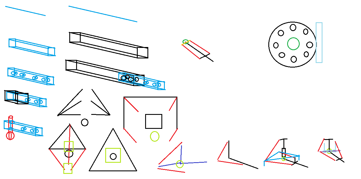

scratch padding around, in paint. trying to get general ideas down...
took me a while to figure out a multi function joystick, would most likly be a better option.
a joystick with up/down/left/right pending on direction you moved it, then maybe a twist of handle for a rotation.
perhaps a secondary thumb button, to allow movement of another joint, or a dial selector to switch between different joints.
to using a newer cellphone with touch screen. to control things. this idea kinda went out the window rather quickly....
need to find the limited rotation hyd unit i remember finding last year or so... it might create enough torque to adjust things on the go.

*arghs* and i thought i had a plan for hyd valves... to deal with "over running load" so the hyd cylinders would better behave with on the go adjustment. along with dealing with "leak down" and dealing with pressure relief... but that is not looking to good. the more complex i get the more of an issue becomes were a single failure could result in major damage...
some V notches in a generic 4 way valve (2 position 2 port valve) with A, B, P, T ports. the V notches allowing kinda of a better needle valve like adjustment, and ability to some what control both pressure and velocity / GPM of the hyd oil better.
going with maybe a slightly longer landings of the spool valve. to perhaps reduce some extra leak down. though it would be nice to go with a smaller diameter spool over all to help reduce leak down a little bit more.
generic 3000PSI max relief pressure unit, on each hyd hose coming from a double acting cylinder.
optional electrical pressure gauge for feed back info. on each hyd hose coming from a double acting cylinder.
each hyd cylinder getting its own linear sensor. and then a rotational sensor in the middle of the 6 hyd cylinders.
generic proportional valves is what it looks like what i will be needing...
though thinking of going with a lower GPM setup and in that small inner diameter parts. for a slow / responsive setup. vs a larger setup that might be more sloppy with just a little bit of wear and tear. small internals should not be an issue more so if all 6 hyd cylinders are being adjusted all at same time. the extra back pressure in system, i would like to think would give a better over all response. of equal adjustment of hyd cylinders vs one or 2 hyd cylinders taking full action, before other hyd cylinders began to move. *arghs* the heat would eat things up.
the solenoids of proportional valve.... has me some what worried, to point of thinking about possibly using an adjustable screw / rotational solenoid to obtain linear action. vs a straight rod with some magnets on it. that gets adjusted back and forth.
the physical hyd hoses that connect valves to hyd cylinders, has me worried with "min bend radius" along with twisting of the hyd hoses. tempted to use a small diameter hyd hose. for small bend radius, and less of a clutter mess of hoses catching up on each other. granted heat from friction would come up slamming the hoses to cause hyd cylinders to move faster.
the more i look at it, the more things fall to were... all the valves end up in a series vs being in a parallel setup.
pump -> P valve 1 -> T valve 1 -> P valve 2 -> T valve 2 -> etc.. etc... and finally getting to T (tank)
i was hoping to avoid this to get away from all the extra friction / back pressure that would come from it. but... hmmsss...
thinking about it... perhaps doing a combo setup...
pump -> (P valve 1&2) -> (T valve 1&2) -> (P valve 3&4) -> (T valve 3&4) -> (P valve 5&6) -> (T valve 5&6) -> tank
i suppose that would give me an actual parallel setup... but being able to place the valves at different locations. *shakes head no* to easy for an over running load to happen.
i suppose all valves are in series could still allow everything to happen in parallel, if valves are only partially opened. it just means quick fast constant adjustment of the solenoids to adjust the valves till operator lets going of the joystick.

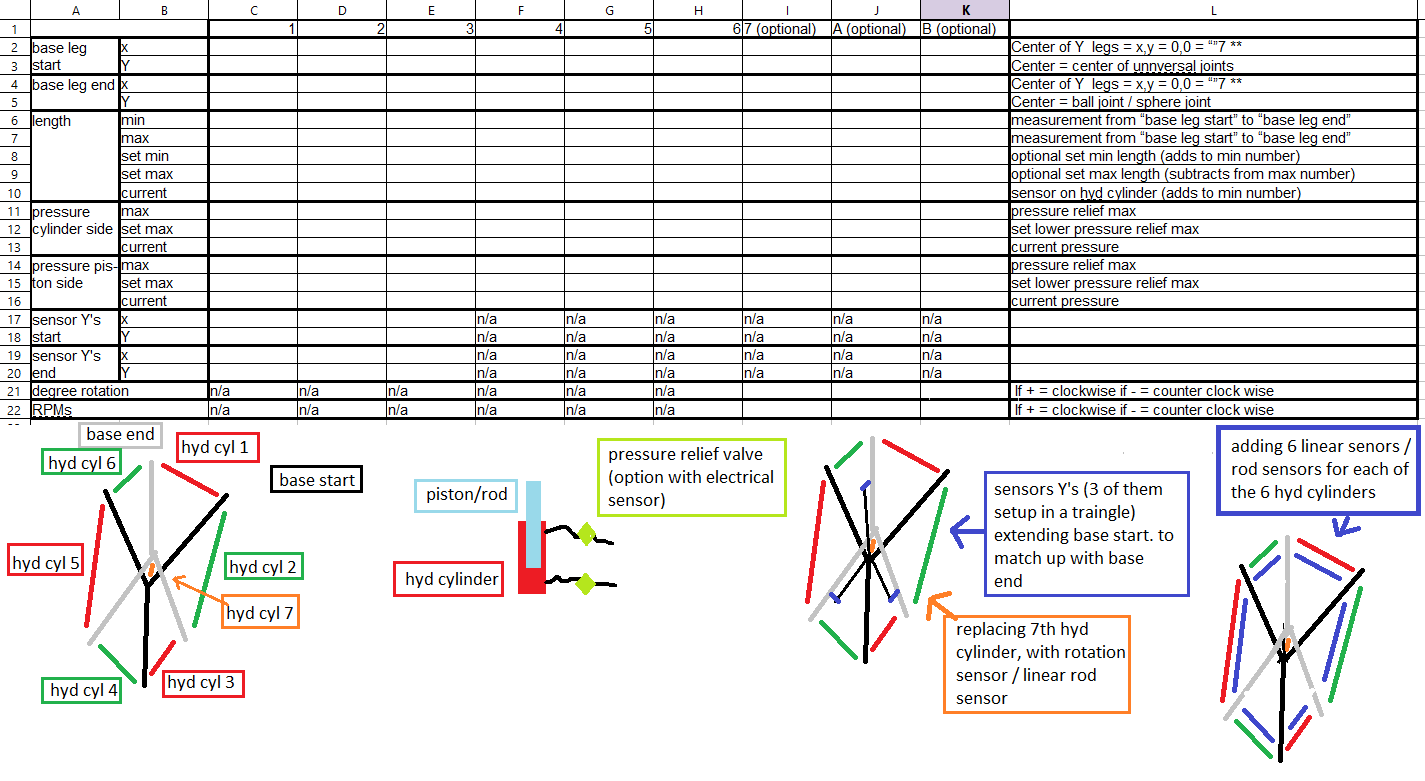

my brain getting overloaded, and need to start looking at the actual coding / programming. to actually get things to work it seems. vs twiddling my thumbs.
should be interesting challenge, how do you work out a 6 hyd cylinder parallel robot. to joystick/s...
an attempt to spreed sheet out variables
drawing out and labeling, going to go with 6 linear / rod sensors on each of the main 6 hyd cylinders. KISS (keep it simply stupid) everything gets duplicated. 6 times.
6 proportional valves... each with 2 solenoids = 6*2 = 12
6 hyd cylinders each with 1 linear rod sensor = 6* 1 = 6
6 hyd cylinders, each hyd hose has a pressure relief with optional electrical feed back = 6* 2 = 12
12 + 6 + 12 = 30 connections
or rather 5 wires plus ground per each hyd cylinder. thinking placing all circuitry back to circuit board / computer chip. vs dealing with various mini circuits at each solenoid / sensor / feed back.
