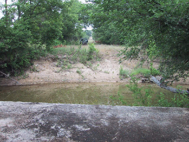

The wall is spaced out from the bridge by about 2-3 inches. It touched at the ends but I have broken that away by hand. I think the whole wall has to go as a lot of water needs to go through the bridge. As it is the creel takes a hard 90 degree turn at the wall and this causes excessive erosion of the bank to the left of the bridge. Unless I can get the bridge opened and the stream straightened out I cannot hope to stop the erosion.

Is the wall attached to the bridge and if so how strongly ?
The wall is not attached to the bridge. It is close at the top and was touching at the abutments but not attached.
Can you work in the two feet of water or build some scafolding so you can work at the base of the wall and along the original retaining wall abutments?
This is possible but I would be afraid of the wall falling and knocking the scaffolding over. It seems might dangerous to me.
Are there gas powered jackhammers for rent available in your area?
Home Depot has one for $60/day but it is an 80# unit and seems a little too heavy for me to use on a 8' high narrow wall. At $60/day I could be looking at a lot of money in rental fees. It gets almost too hot and humid to work here after 10 AM. I could probably do fine in the Winter. It does not get cold here and I get hot very quick even when it is in the 30's.
Think about breaking the concrete away from the abutments, then hammering holes and a line at the water line along the length of the wall. Maybe even some vertical scores. Then use a winch to try and pull over the wall. It may break in tension where the line has been made at the bottom of the wall.
Consider your safety and the wall falling if you are at the bottom of it.
Once I can get my tractor onto the bridge I can very likely push the wall over. As it is now I can only get a spreader between the bridge and the wall. This attachment can only apply 1000# of pressure which is not enough to move the wall. There is nothing to attach a winch to for pulling the wall down.

Might be easier to just leave the wall alone and build a new bridge from the old bridge to the road across the current creek channel. How far is it?
Actually that is what I though I had to do until recently. I had been told that the old bridge had washed out and all that was left was one landing. I thought it looked kind of funny though and I discovered that the whole bridge was there while picking black berries last month. A new bridge would have to be 60 feet long so filling in the area would cost a lot less. It will be a lot of work but I have more time than money. My neighbor, a retired surgeon who has had a lot of work done, thought a bridge would cost about $100,000.

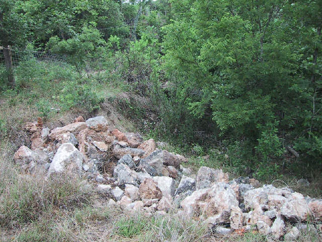

Just make sure the fill is heavily compacted and the sides well covered in riprap.
Yes I have lots of riprap available and I plan to make good use of it for this purpose. I have an old rock wall that is aroung 500 feet long and 4 feet high. I plan to use a lot of this for my house and the rest for things like this project. There never seems to be a shortage of rock here. It seems to grow in the fields.

You want to remove the concrete, but you want to fill in the washout first - won't it just wash out again? You need to get rid of the concrete first, and then fill in the washout????
You keep saying you can't get any kind of power or tractor to the bridge. Most of the time one can drive in the bottom of a creekbed. Have you considered this?
Also, why can't you drive onto the bridge from the other side? Are you saying both sides are washed out?
Sure would hire someone to break it out if it were me, that's the job that needs to be done first, get it done & then deal with the rest of the issues as I could. But you need the water flowing right as a fist step.
So, where did the other owner expect the water to go, didn't he make a spillway & all that? Sheez.
