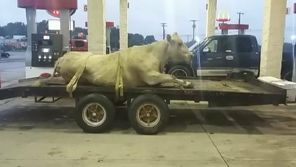

Sounds better thought out than others similar but less built out plans...
The only down side will be the engineering & effort to build it right or attach or dismount the cage/walls onto. Depending on how acrobatic your livestock I've seen many without roofs. cf398f0b-7b59-4957-8b77-c1e89dc3d590-large16x9_cow1.jpg
/ Deck trailer / DIY livestock trailer
The only down side will be the engineering & effort to build it right or attach or dismount the cage/walls onto. Depending on how acrobatic your livestock I've seen many without roofs. View attachment 675935
Love that picture. I found that too, and was joking with my neighbor about it - problem solved!
You are correct, there will be some effort. I enjoy projects, so that's fine by me. The roof is a big question. Maybe just cross braces. And possibly a tarp over those.

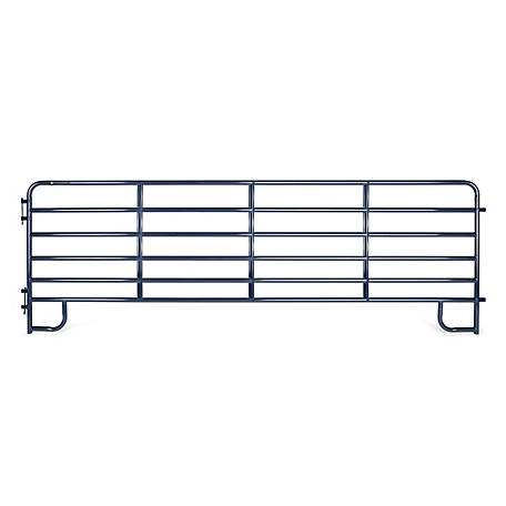

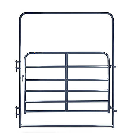

We have something similar, 6x10 landscape trailer, bought a pickup stock rack, modified it a little and we use that to haul steers to the butcher. I will see if I can snag some pictures when its light out.
Could probbaly do the same with corral panels, a gate like this in the back:
And these for the sides and front:
I would want taller ones than that though (they are only 5' tall, I wouldn't go shorter than 6') and I would put plywood around the bottom so that they cant put a hoof through the slats.
I would also put hog panels across the top so they cant jump up and out.
