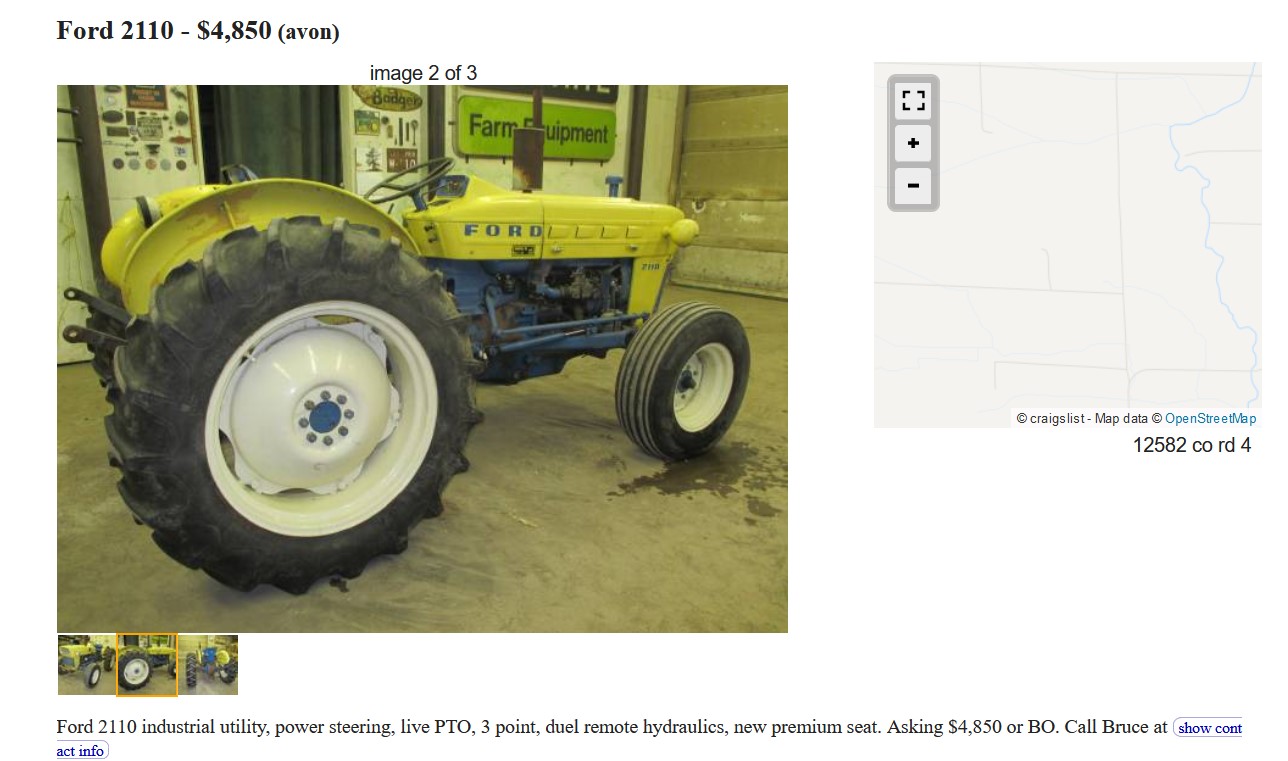

Or this 2110 Industrial near St. Cloud, MN - 38hp Diesel, 12 speed transmission - 30 years newer.
Ford 211 - farm & garden - by owner - sale
