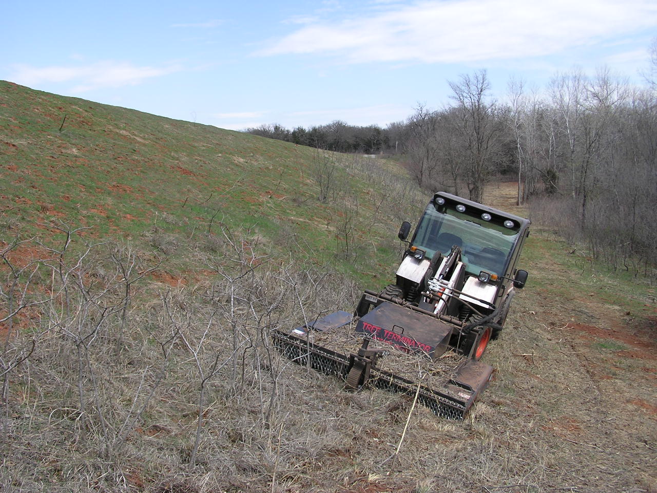

Another good look at the kind of thing you'll be doing. They seem to like using the front blade.

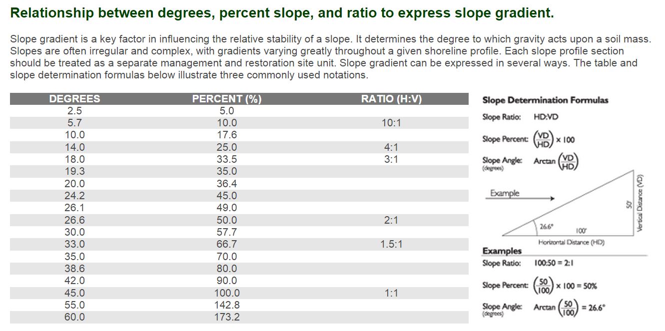

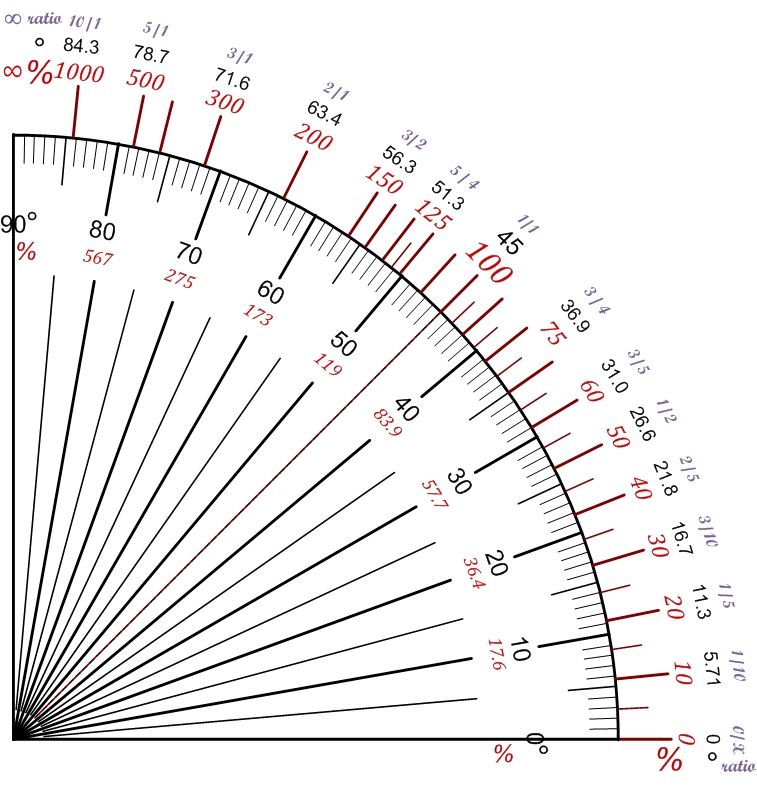

Just so there is no confusion between slope % and slope degrees:

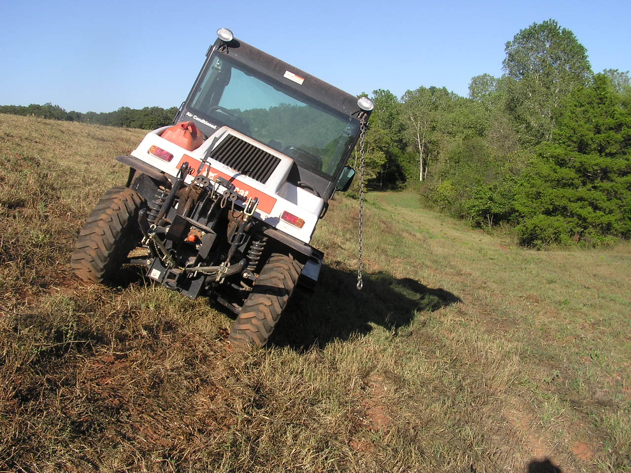

And a visual of a 50% slope:
The chain hanging from the work light shows true vertical:
Great information, thank you for the informative post.
The last picture with the chain, not happening.....Nope.
Some of my hills in the back look about like that while up closer to the house is actually steeper than that, which I will not be cutting into.
