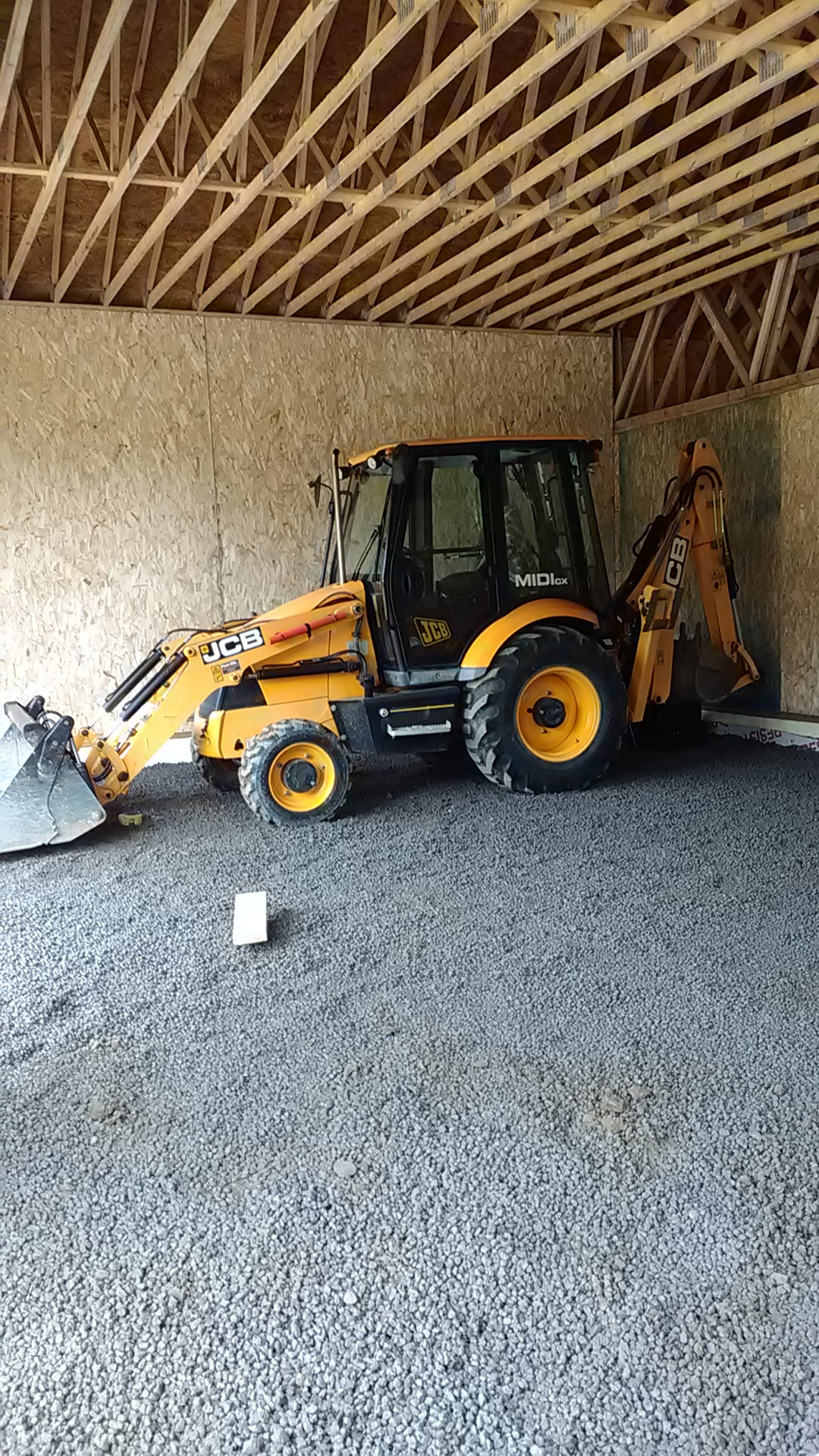

I needed good FEL lifting but wanted cat 1 in the rear. You won't get it for $30K but that's why I bought my JCB MIDICX. The 4:1bucket alone ways 800lbs.
it's a construction type tractor that can do Ag. work, instead of the other way around.
Look at used JD110. Very similar
