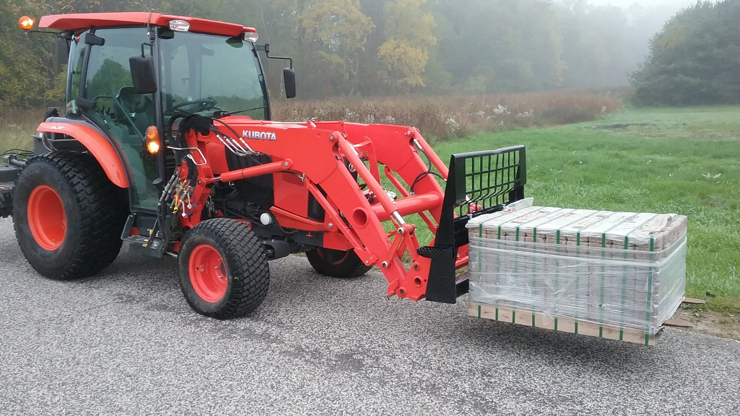

I just thought i'd throw in a real world example for reference. This is a 2200lb pallet. I was only able to pick it up about 4 inches above the deck height of the trailer before it stopped lifting all together. From there, I had to make like a 30 point turn because the steering practically doesn't work. you can see the front tires squashed out. I try very hard to only move this type of weight with a tractor on very rare occasions. Due to this particular job, it wasnt going to work well to use a CTL. This is the biggest L series available and has a 1055 loader. Even if other tractors have a higher rated capacity, its still a massive strain because of how far out tractor loaders are leveraged from the front axle.
/ CUT Low Loader Lift Capacity
#22

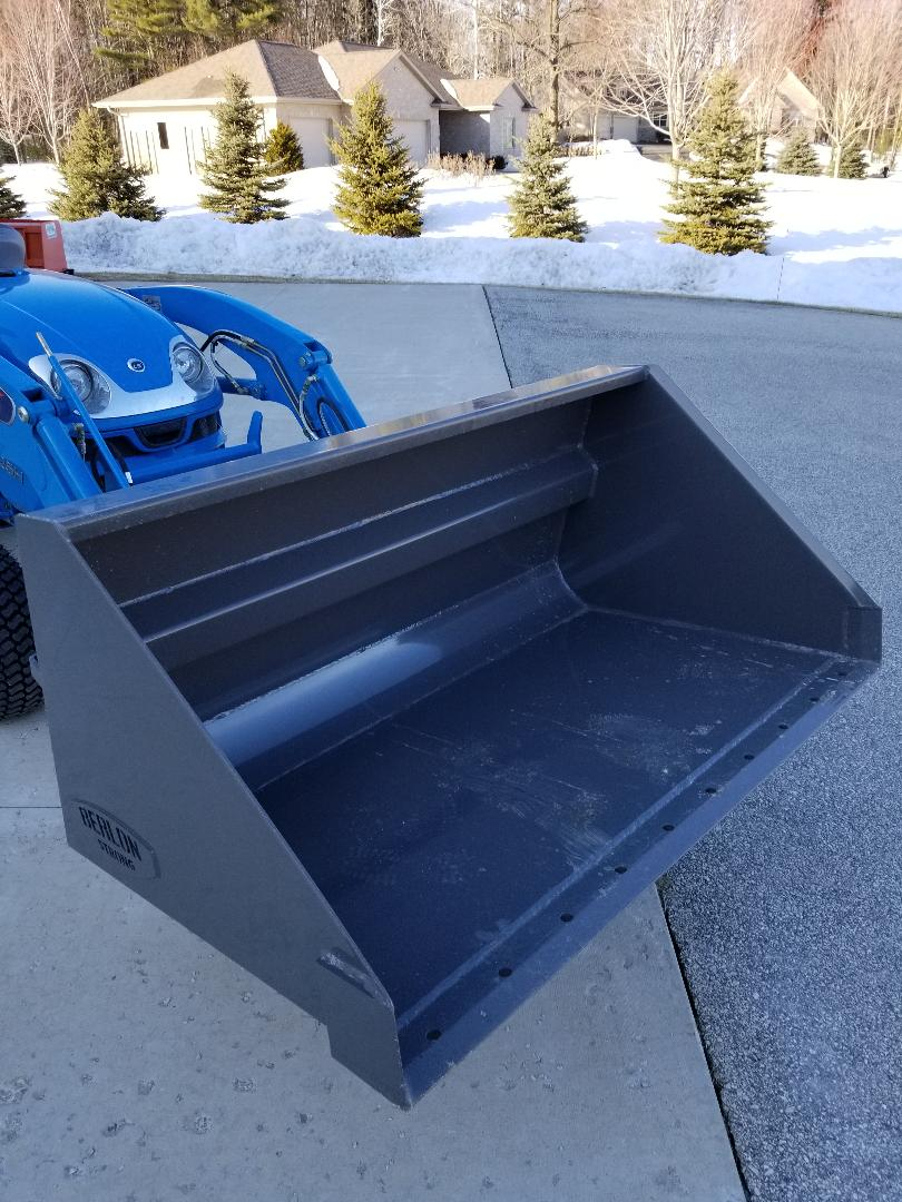

The rated load is at the pins. The center of mass is ~ 18" away which SIGNIFICANTLY reduced the lift capacity. My Dealer lost several pounds in his shorts when he saw my configuration. I just saw him last week and he still brings this memory back - nearly 4 years ago.
If that's the l6060 the specs I looked up for that:
How much can a Kubota L6060 lift?
Lift Capacity (pivot pin): 2361 lb. (1071 kg.) Lift Capacity (500 mm fwd): 1784 lb. (809 kg.)
And it looks like a lot of your load is far forward.
Did you check your pressure vs the spec? It might be 10% low.
