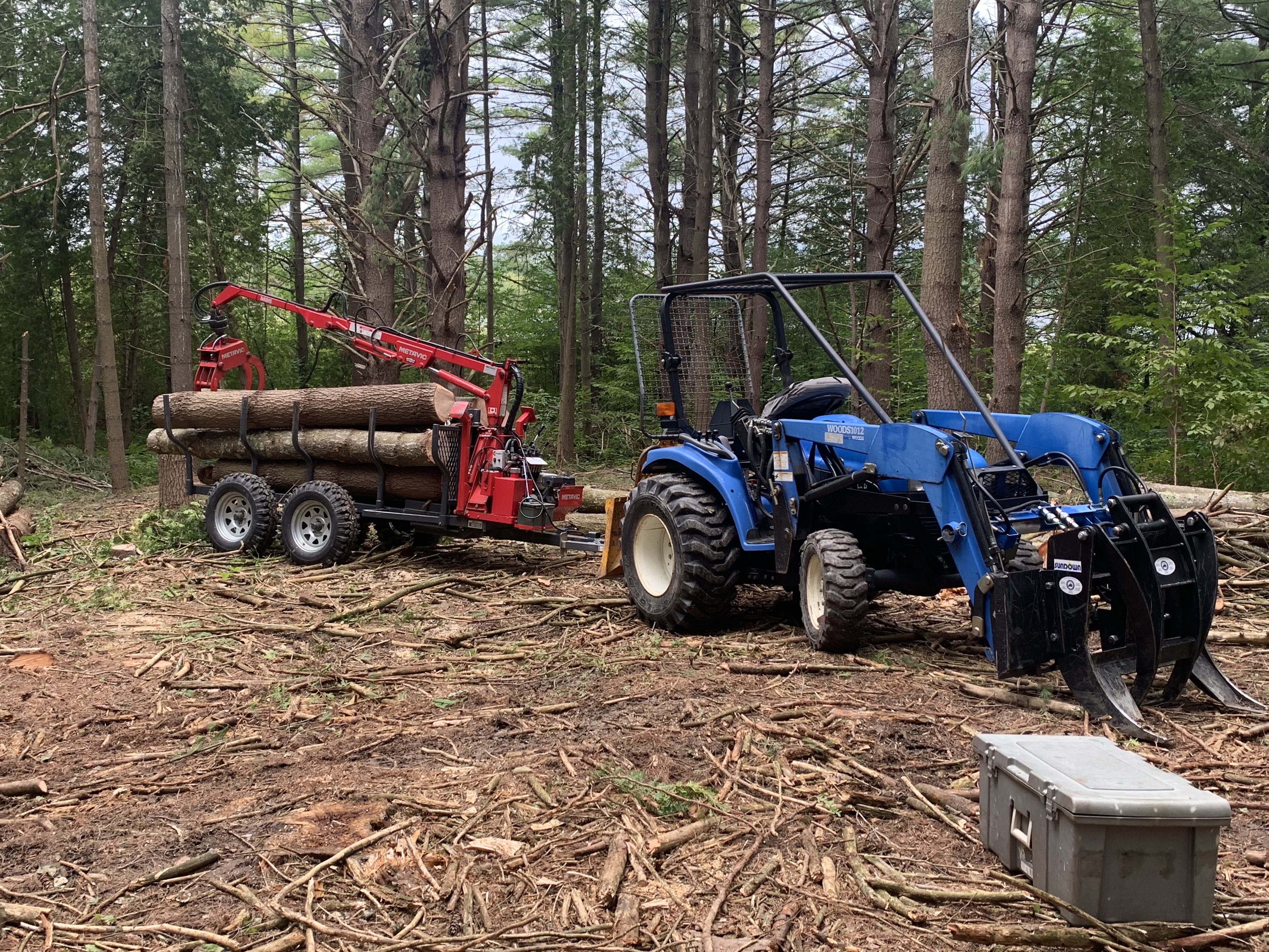

I use a logging winch some of the time, and pull a forwarding trailer at other times. On rare occasions, I have both on the back (as seen in the picture.) I don't like attaching the trailer to the logging winch - just makes everything longer and less manueverable.
I hear you about the wide grapple. That's why I use a forestry grapple on my TC33D: narrow and easy to maneuver (at least when I'm not carrying a log). I was amazed at how much easier it is to get around in the woods as compared to when I have my 66" wide bucket on.

Question for my education. Since your forwarding trailer has a grapple on it, do you actually need more grapple lifting capacity than what you already have?
Forwarding trailer is a small one. Lifts about 600# at full reach, and 1500# at 4' out (essentially, right next to the trailer). I can get bigger logs on with. bit more effort: remove all but the front log bolster from one side of the trailer, lift up one end of the log and tuck it in behind that one bolster, then lift up the other end, put it on the trailer, and reinstall the other bolsters (unless I have another large log to load). The loader on my tractor will lift up about 1100# (more if I'm only trying to get. foot or two off the ground)

I currently have a New Holland TC33D that is set up for work in the woods: limb risers with Falling Object Protection of sorts (won't stop a large tree, but will stop a good sized limb), belly pan, grapple for FEL, logging winch, forwarding trailer). I did not like the NH 7308 loader, so ordered mine with the Woods 1012 Loader (slightly larger lift capacity and larger dump & rollback angles). I did not originally buy this tractor with forestry work in mind, but my needs have grown over the years. I now use it working in the woods a lot, and picking up some of the larger logs can be a challenge. I do like that it can get in to space where a larger tractor could never go, but the limitations become an issue at times. I get by with what I have (the forestry work started in about 2006, about 5 years after I bought the tractor). I really should be using something bigger, but since I'm not logging for a living, cutting the big diameter logs shorter, taking more trips and taking my time has worked out - though I did manage to crack the clutch housing a few years ago.
